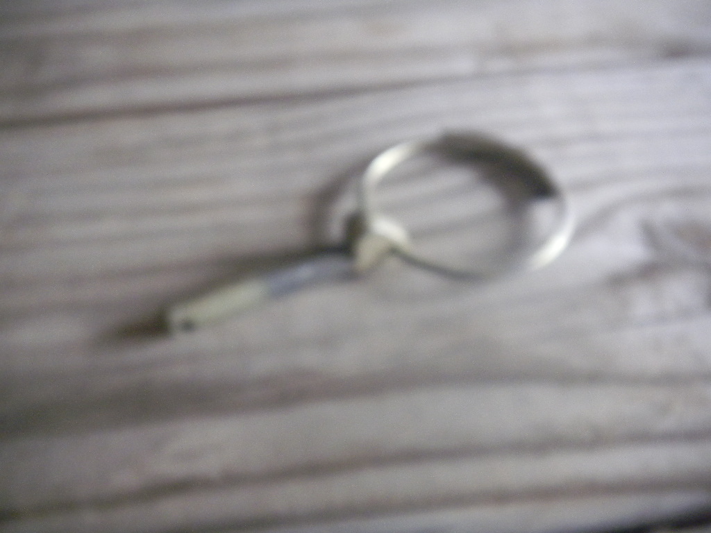

It is hard for me to imagine a pin coming out snow blowing as there shouldnt be anything to snag them. Make a few like GWDixon show with washer first then slip the pin thru and if it comes loose then it must be breaking in which case something is not right and causing the lift arms to pull excessively on the pin. Maybe try putting in a grade 8 bolt with either a double lock nut or nyloc nut with a washer on the lift pin before the bolt. I have lost a few bush hogging and broken some with the box blade but only after bending the lift pin.
Look for the cause of failure rather than constant pin replacement unless you were putting them in wrong which I doubt unless you are flipping the bail all the way over after installing.

All good ideas and washers and bolts are next if the black jobbers and pull ties fail.
Thanks again.

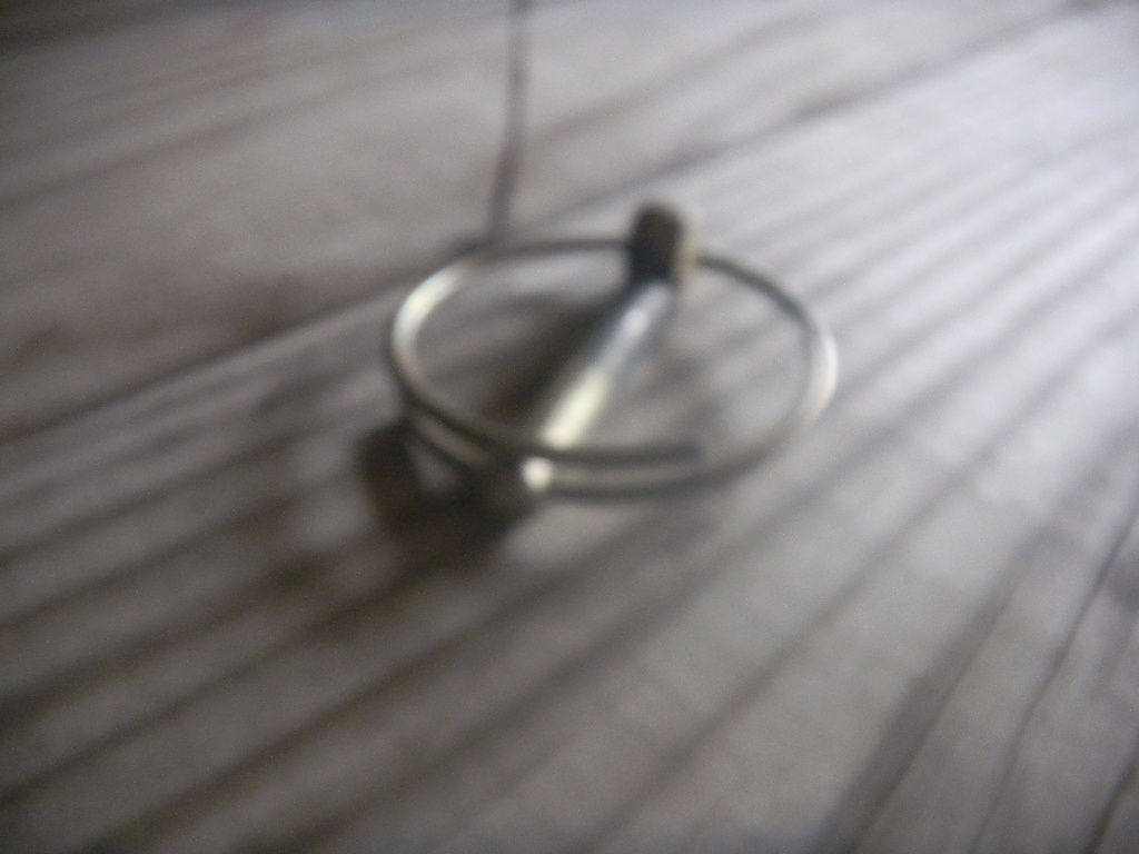

Pins do have a split ring, hole in each end of ther pin, you thread the split ring thru the end hole to keep the pin in. JD part number AL114597

If you look at the image in the first post you will see not all lynch pins are created equal, lol, I like the idea of threading it through a hole but this was not an option with the pins I have been able to obtain.
