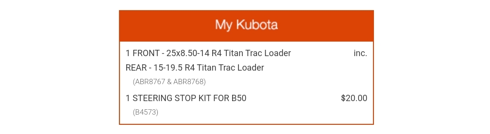

I am completing a deal on a new LX3310. The SU models have larger tires standard which are optional on other ROPS LX models and are what I’m getting. The larger tires generally preclude a MMM which I don’t care about, and the SUs don’t even come with a mid PTO. The contact patch on R14s irrespective of size appears smaller/rounder than their R4 counterparts. I’m putting spacers on my tractor as I use it in the woods and on some hilly areas. All the oversized tire LXs automatically show steering stops in the ‘build’ tool, however I’ve not actually seen my tractor or stops yet. I don’t think you are seeing a ballooning issue as much as the same oversized section width and smaller, rounded contact patch on the R14s. Visually I didn’t care for the R14, but in practice I’m sure they are good performers.
/ LX Series Oversized Tires #5
I have an LX2610 with the standard R4 tires. Steering stops are required if you want the larger tires. I have a lot of soft places in the woods and will order the larger tires after things get back to normal.

Do they modify the gearing with the larger tires on the LX models? With the B2650/3350 models they did not change the gearing with the larger tire option, and it resulted in a notable reduction in torque at the wheels (Kubota was upfront about this if you talked to the right person). That is the opposite direction I would want to go in with a tractor if it's used for pulling or pushing, or in a hilly area. I seem to recall someone here on the forum went with larger wheels on a Bxx50 model and had issues mowing on hills, not enough guts. I would be sticking with the standard size wheels and tires if it were me.
/ LX Series Oversized Tires #10
As I recall the guy here (Rock Crawler?) who had difficulty with his 2650 had a super hilly side slope and a big, restored Landpride mower he was pulling and seemed to be between ranges for his application.
https://www.tractorbynet.com/forums/kubota-owning-operating/389876-b2650-count-down-has-begun.html
I recall he also stated multiple times that he loved the larger tires vs the 'wimpy' stock-size tires (his words). Didn't he end up using a smaller, dedicated mower for his lawn? The final effective gearing appears to be very close to the same tires on a L3301. With the 3 range gears, and 20% more power than the 2650, I don't foresee an issue for my application at all.
#11
They do not, and the over sized tires increase ground speed significantly. If loaded, weight is also significantly increased.
