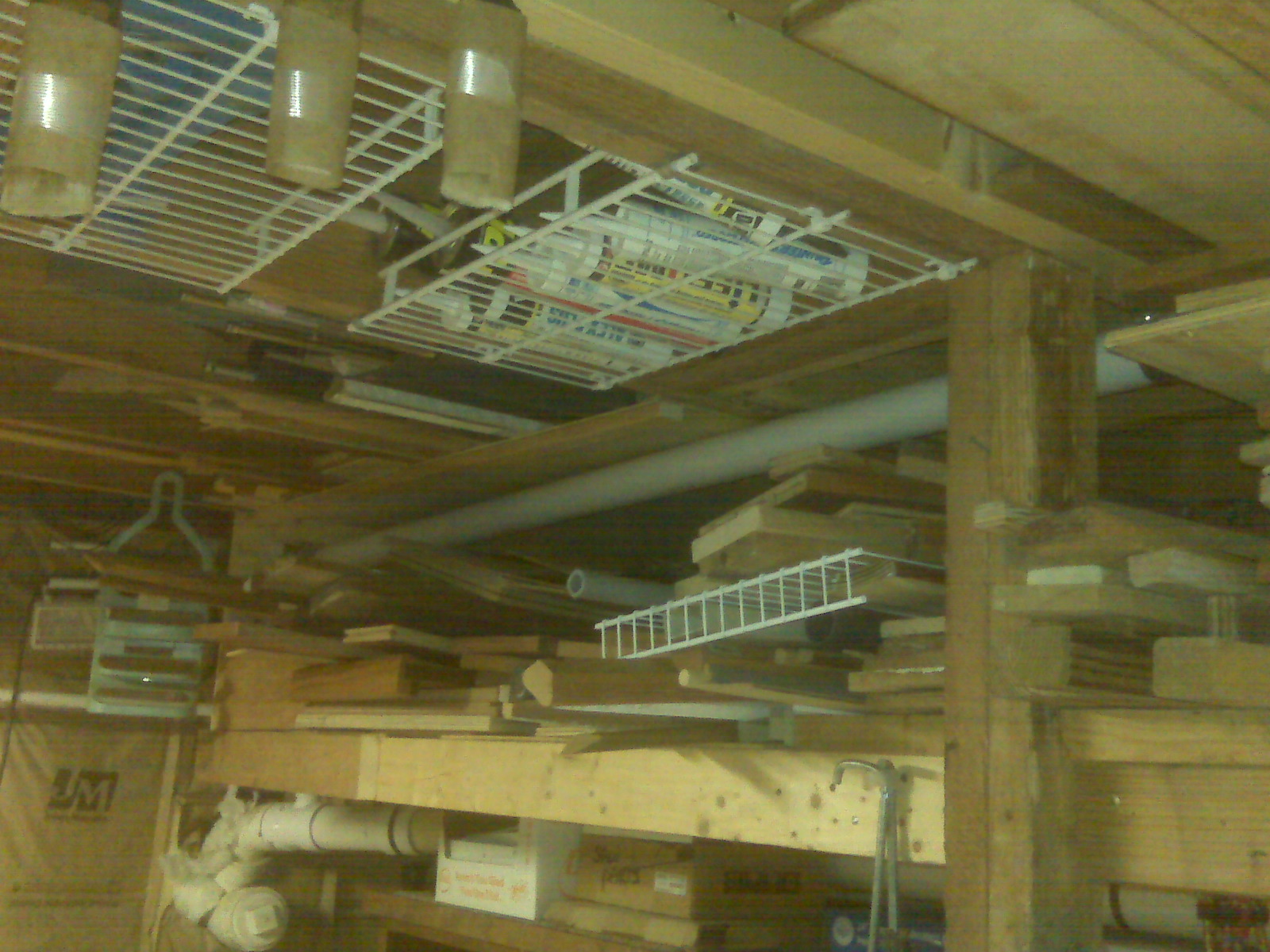

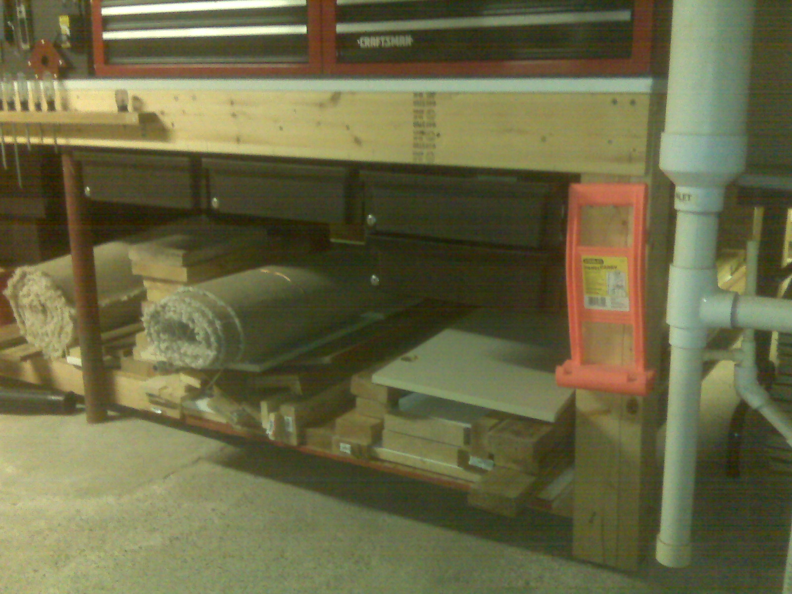

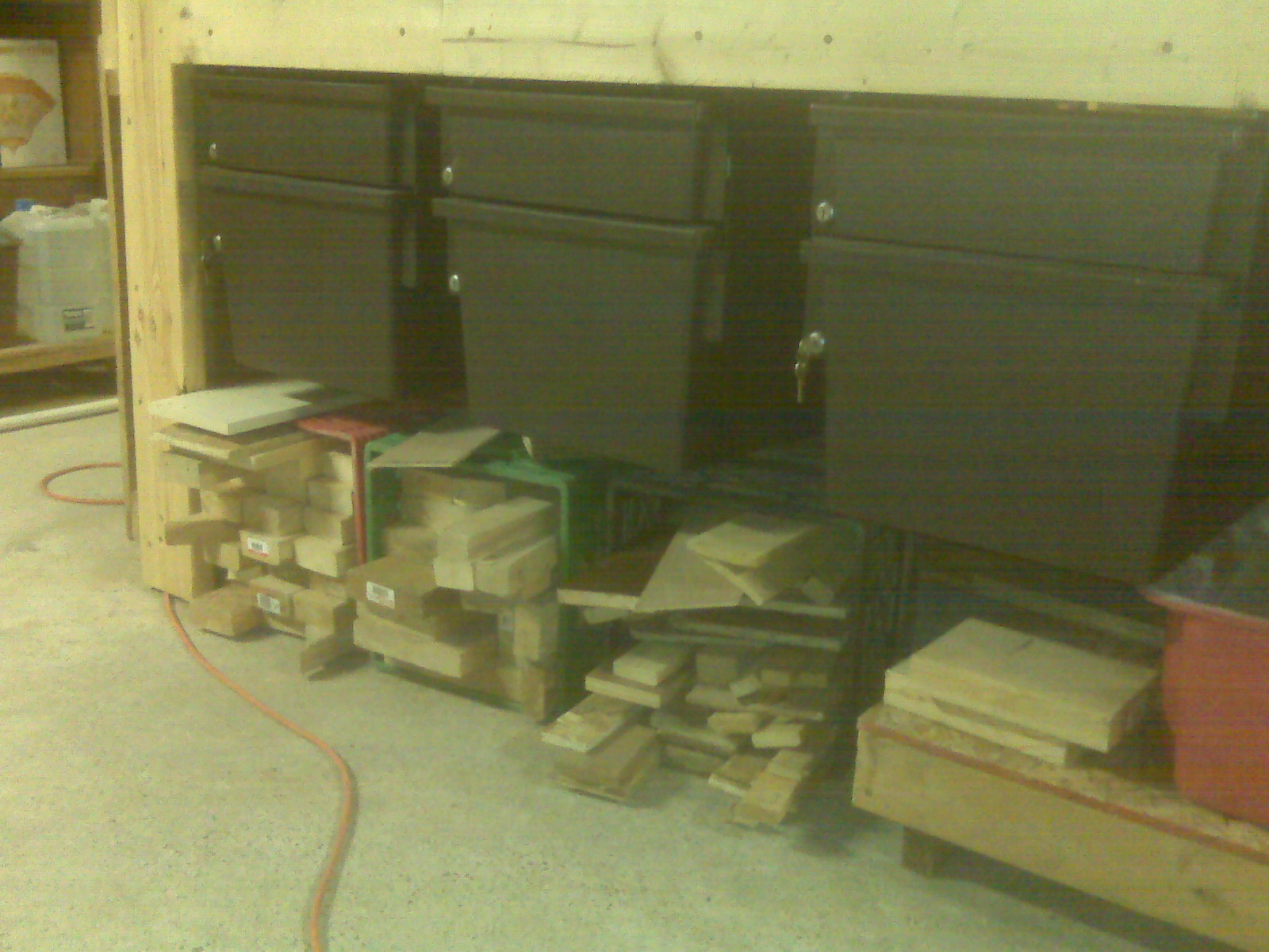

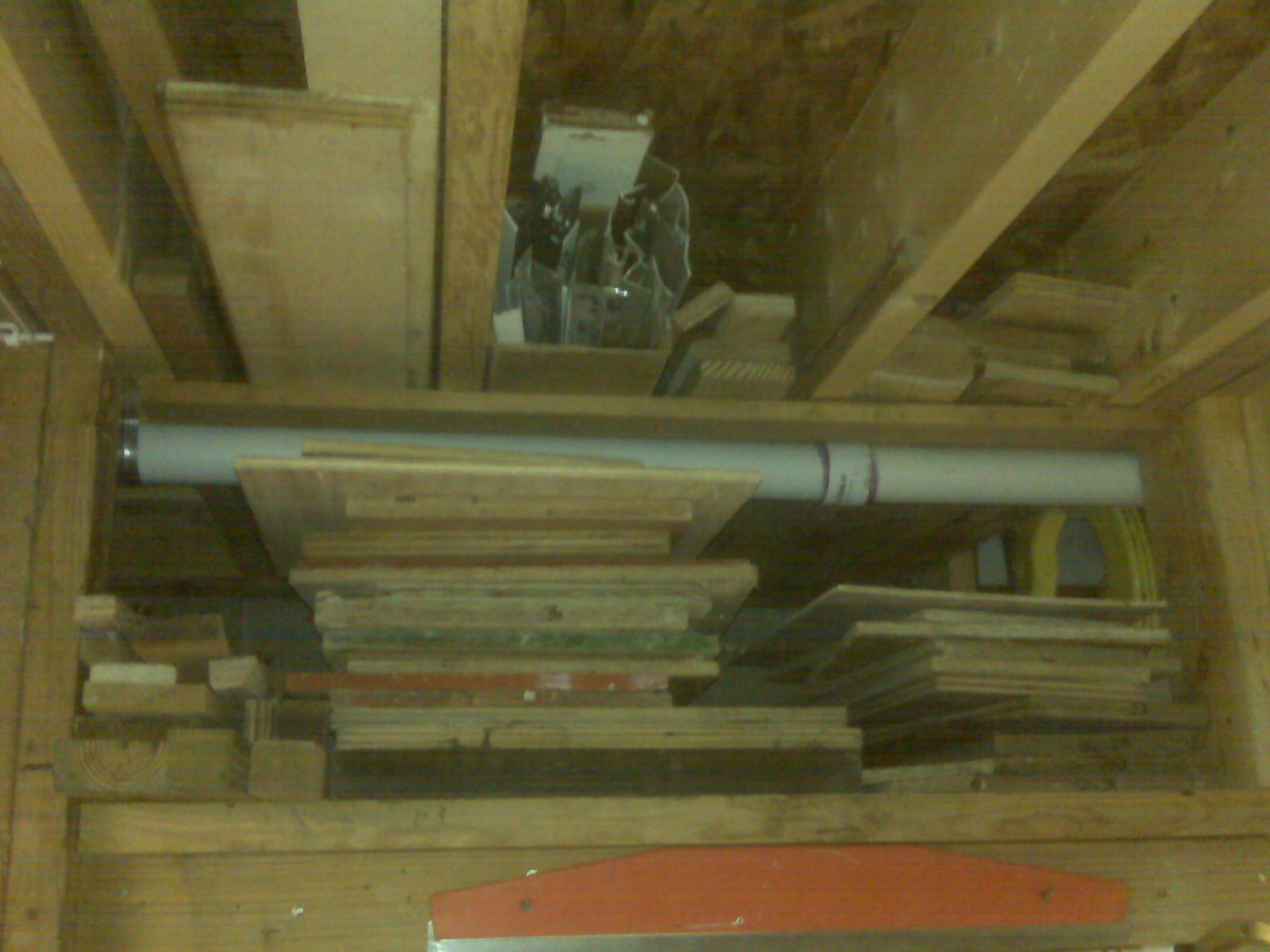

My woodshop is in my basment, I made a rack for 3 to 4 foot lengths of wood by supporting it from the ceiling joists. There are a pair of standing height 8 foot square workbenches in the center, and I made a rack under one of them to keep long lengths off the floor. And old milk crates make a great way to store short sections of wood.
Hope these ideas help!!

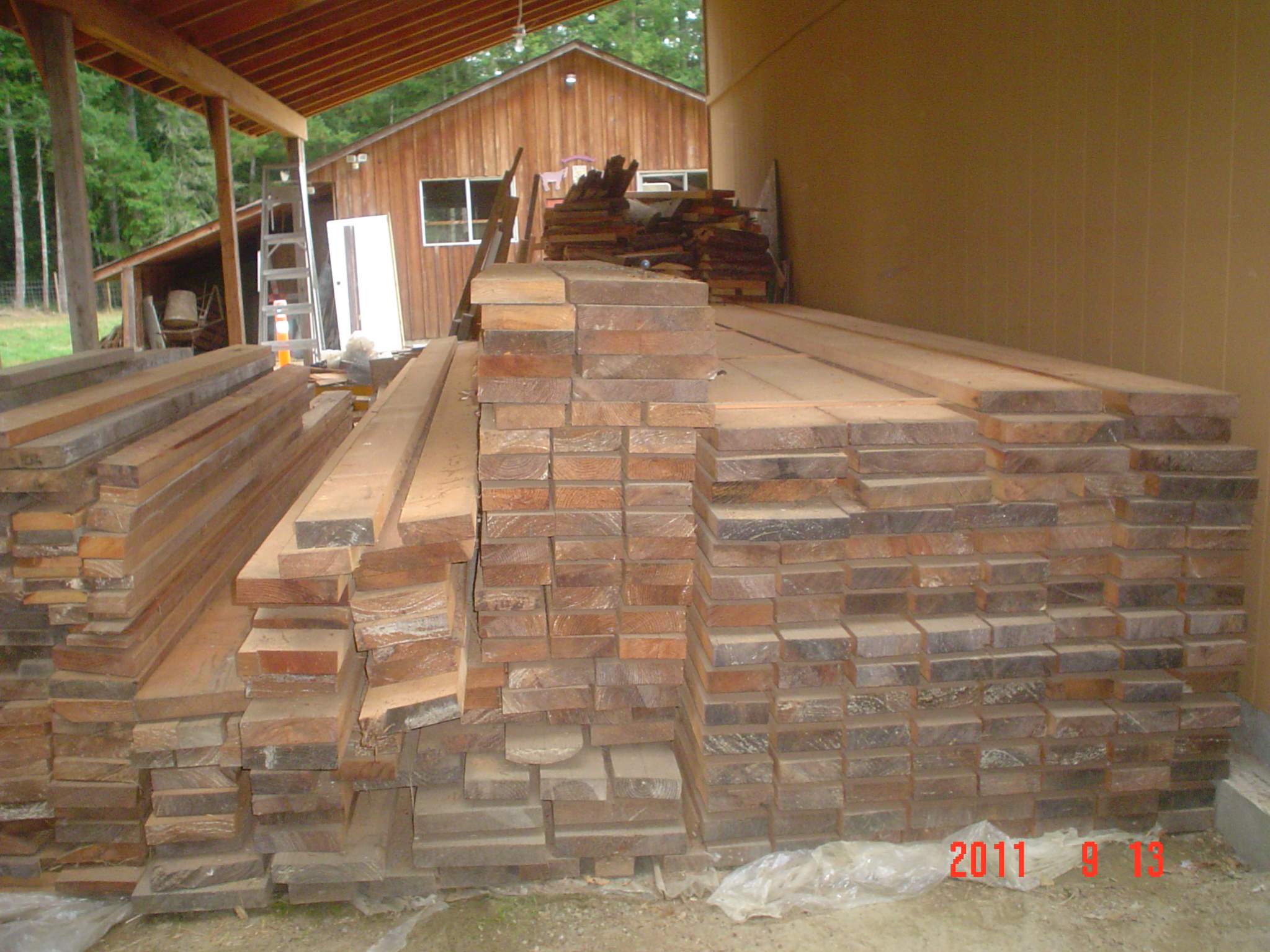

Don't store mine inside but is under cover on the back half of my 28 X 24 ft chicken palace. I have it stacked, not all of it by size. I am in the process of selling some of it and cutting up smaller stuff I have been keeping for "future use", some I have been keeping for over 10 years :ashamed:. If I were to store in inside then some type of metal rack with 4-5? levels so you can sort by size. Perhaps something similar to what metal shops use to store their pipes and rods on.
If you click on the attachement their is a pic of a wooden lumber rack. :)

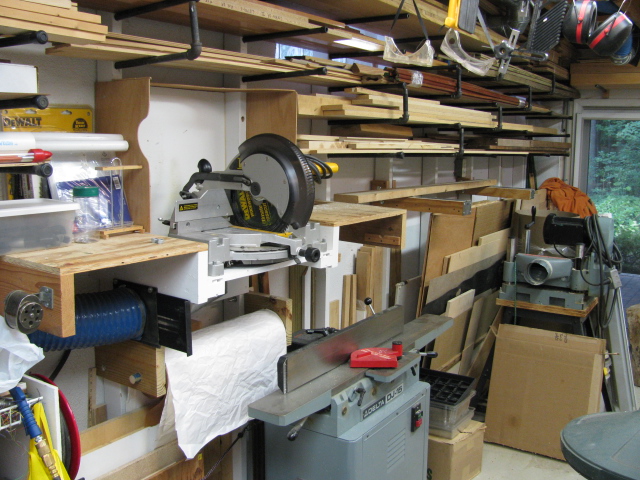

The Miter saw is at chest height so I can see cutoff markup without bending over. It is in the middle of my 30 foot shop so I can cut off the end of ~15 foot boards. There are several roller supports to the right and left of the saw to move material easily on the miter table. The last lumber support is sized to allow the planer and jointer to slide under them. I must have read the same magazine as MF1562 since I have a pivoting sheet goods rack to the far right. Large-sized horts are stored vertically behind the lumber supports. The lumber supports are 3/4" - 18" black pipe pieces set into 7/8" holes drilled on a 2 degree angle into the studs. Some have an elbow and a 4" nipple at the end to stop thin strips from falling off.
To the left of the saw (not seen) there are four 10 foot white wire closet shelves placed upside down on similar black pipe that holds piles of medium and short shorts.

DocHeb, I really like the height of the miter saw. Good idea to save on the back.
