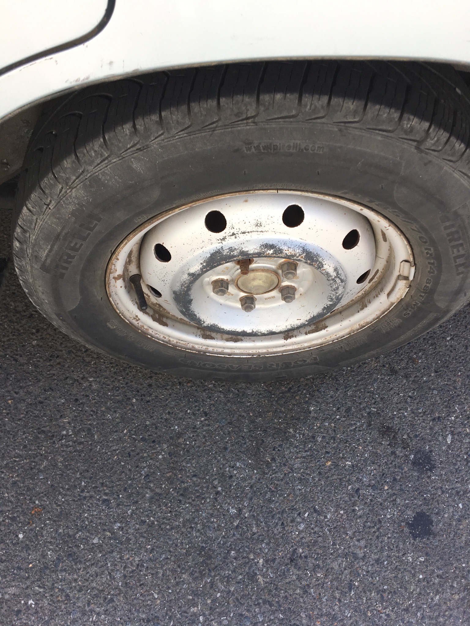

Parked next to this at the grocery store today and thought of this thread. Someone did not tighten down that one lugnut.
