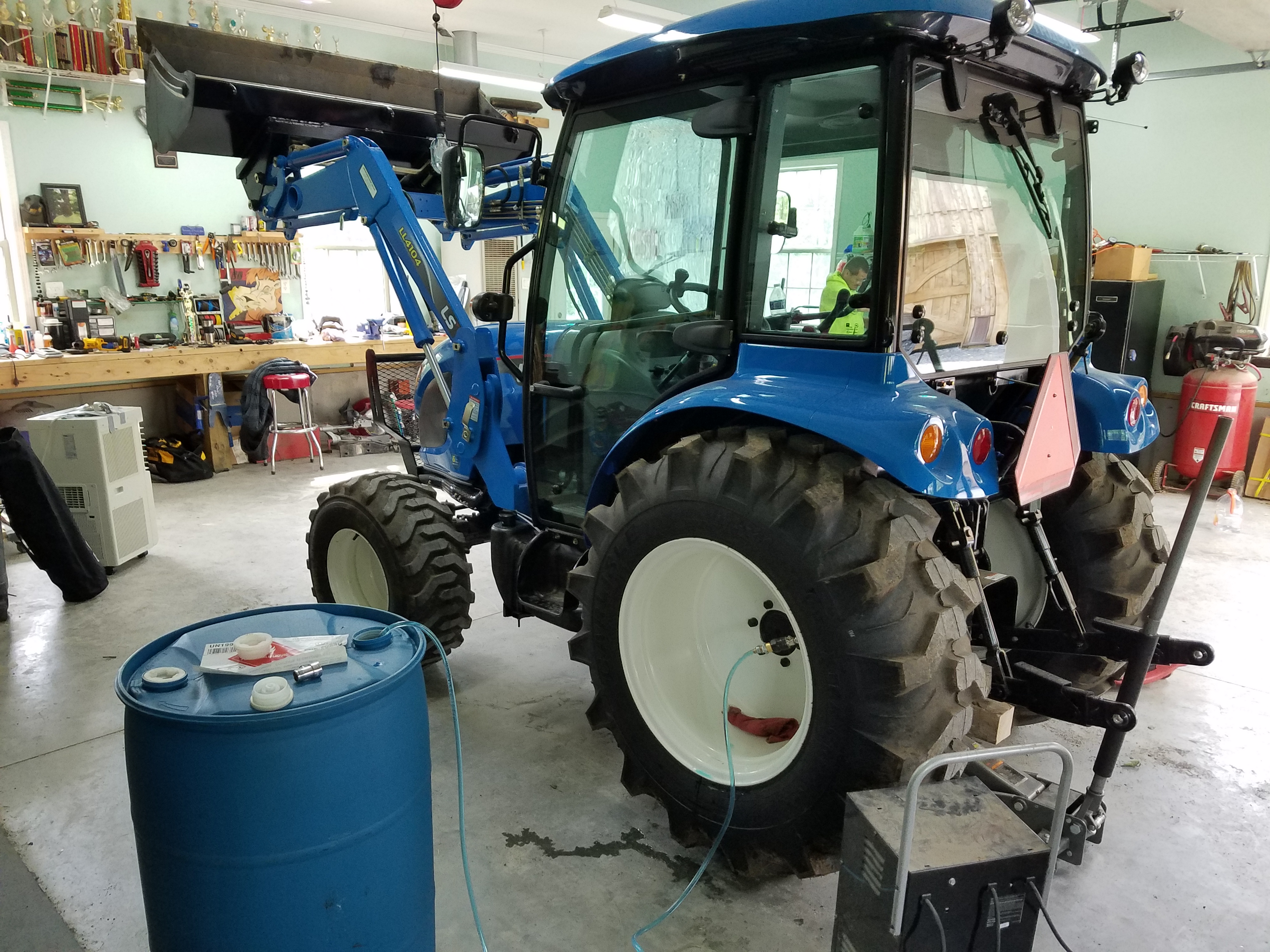

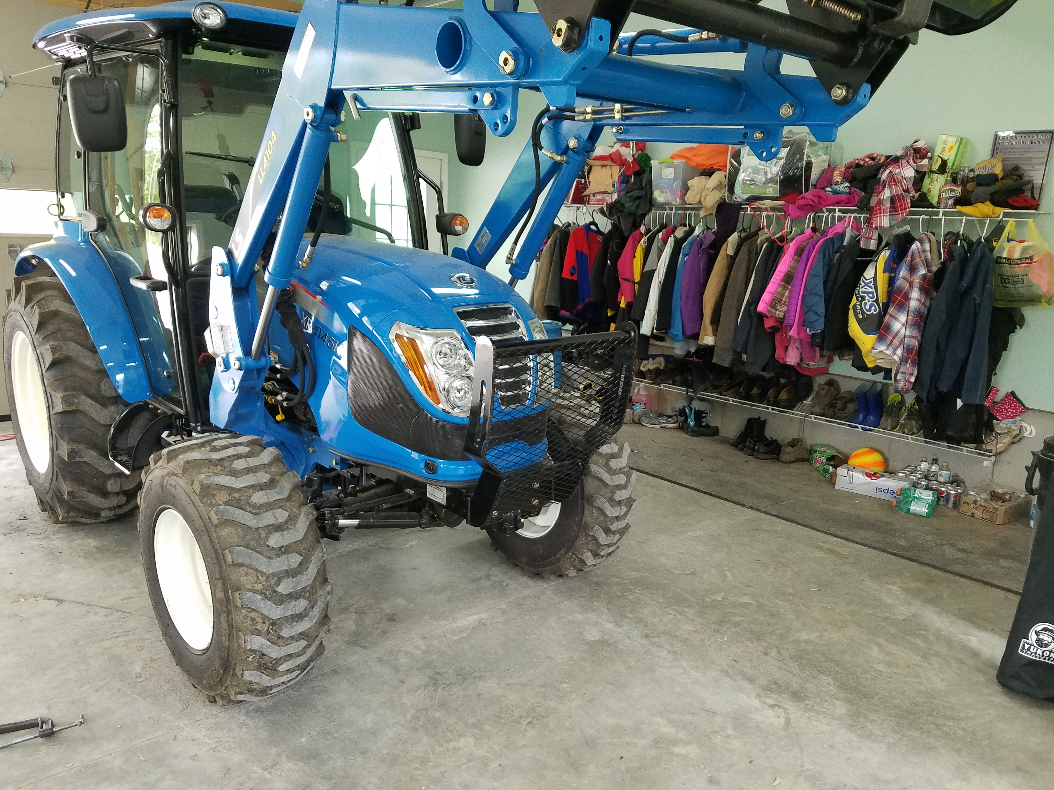

I just painted up my steel for my skit plate just like Cataclysm's ... do you think I will be ok if I mount it to the bottom of the loader frame for easier 1 person installation and removal or do you think the 2 inches of clearance that you loose can be an issue? I also welded on my expanded steel in the brush guard and painted whole brush guard and expanded steel black. I think it looks better black! while I was doing this stuff today I pumped in about 45 gallons of winter mix washer fluid into each rear tire that I purchased in bulk from a local company that makes it.. way less than beat juice. cost me 250.00 for 2 55 gallon drums along with hoses and stuff needed to do it. overall it was a good enjoyable day of playing in the garage with the tractor!View attachment 520481View attachment 520482View attachment 520483
Interesting that you mention that. I use a floor jack and block of wood to get my plate (its pretty heavy) on top of the frame so I'm not wrestling it while getting the bolts in. So for me its easier to put it on top. If its easier for you to put it on bottom I see no problem with that. It certainly won't hurt anything and I doubt you will miss the 2" of clearance.
Great looking brush guard by the way. I still need to get expanded metal in mine. I just hate welding on that pretty paint. I will probably hate it more when I have to buy a new front grille though!

Wow that brush guard does look better in black! Might have to do that when I put my mesh in. I love the tire size on the 4xxx series tractors compared to mine. Just couldn't justify something that size at the moment.
I do a lot of loader work in yards, those big tires really work well to minimize the damage even with a full bucket and are part of the reason I bought this particular tractor!!
