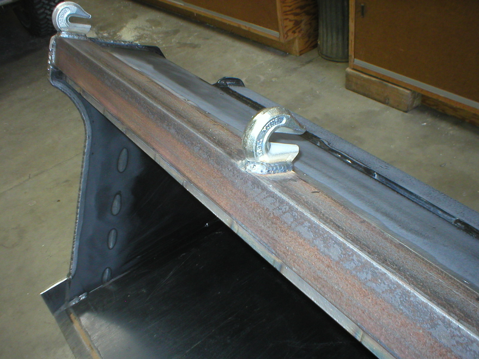

I welded a piece of 2.5x2.5x1/4" angle iron across the top edge of my bucket and then welded the hooks to that. It gives it more support and spreads the load of the hooks.

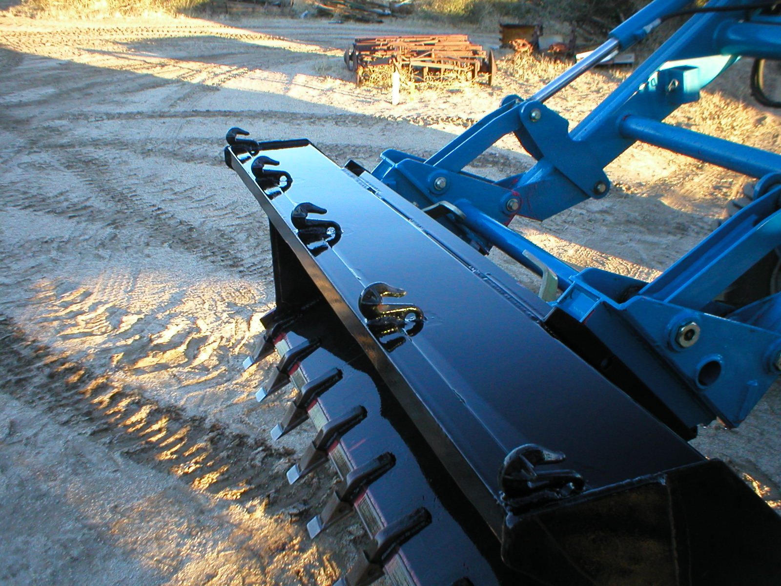

It is usually a good idea to put an angle across the front lip of the bucket before installing any hooks. Most of these buckets are only made with 1/8"-3/16" steel. That is not strong enough to support much weight concentrated in the small area that the hook will be welded to. So it is a good idea to put, say a 2x2 angle either 1/4" or 3/8" thick across the entire lip of the bucket to spread out any loads that will be put on it while lifting any type of load.
Here are a few pics of the 2 buckets that I have reinforced.

/ LS R4047 #17
Did you also reinforce the sides of the bucket? Looks like an extra plate there. Was that in relation to the hook reinforcement or for something else?

/ LS R4047 #20
Yes I added 3/8" plate to the front part of the sides on both buckets. Just some added strength-protection for the bucket. People use these tractors for work that they really were never designed for, myself included. These loaders are designed to work with loose material, not to dig into hard pack or even a pile of bigger rock. Most of us use them for far more than what they are actually designed for and the reinforcements that I have added just add some protection against bucket damage due to misuse of the product.
