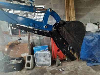

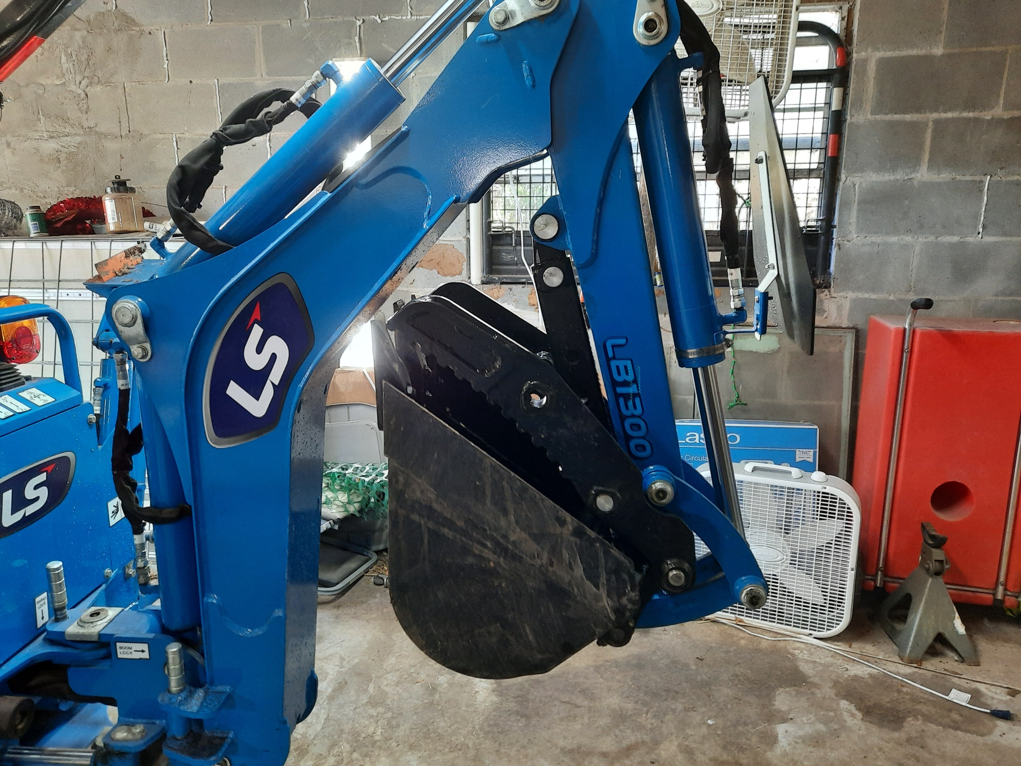

Paid $250 for mine from dealer in CA. I like it...use it allot...no issues so far with the thumb.
/ LS backhoe factory thumb #23

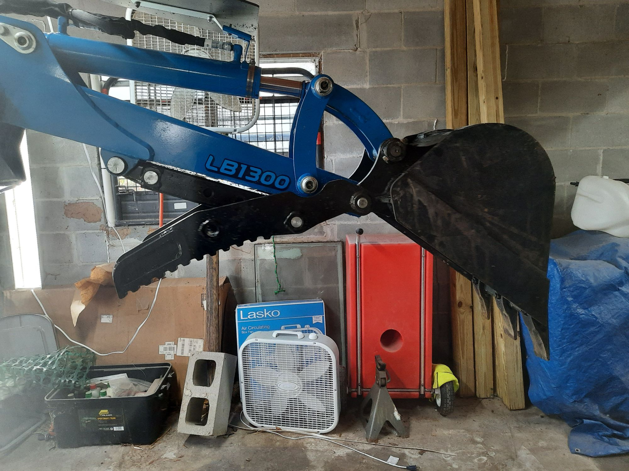

Same thumb but my backhoe came with the mount point already welded on. I'm assuming a newer model, got mine early 2020. I haven't used it but 3 or 4 times, but in those times it was really nice to have. Would be really great if it had a hydraulic ram of it's own but I've not used it enough to justify that yet.

It's an LB1100 with subframe .
I have the same tractor and hoe as you. I want to install a bolt-on thumb. I measured the dipper arm and it's 3 3/8". Titan states theirs fits a 3.25". Have you actually installed their thumb on your hoe? I don't want to weld one on and not big on cutting theirs in half to widen it. Looking for a "perfect" fit.

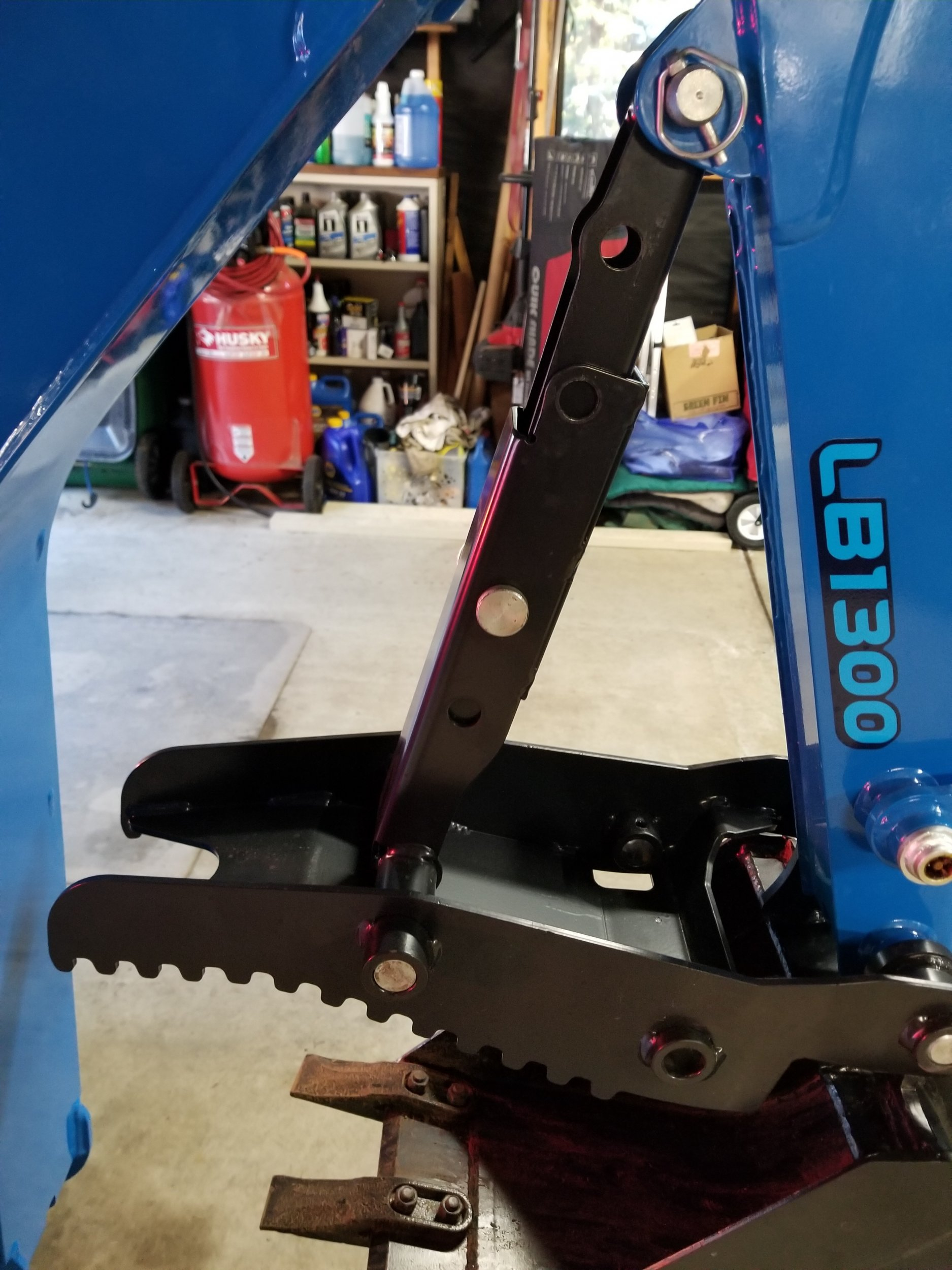

I recently bought a MT468CPS with the LB3102 backhoe. As best I can tell, the hoe is exactly the same as the Kioti KB2485.
With that being said, I can't seem to find an actual listing for the factory thumb for either of these models. The dealer I bought the tractor from said he would call their rep and see about one. The DKA147 appears to be it, but havent found it on any parts websites, etc.
Like Kormidoit, this one already has the mount welded in place to accept one.

Found and bought DKA147 from a Kioti dealer about 90min away. Got home and started install only to find it had the smaller bucket pin in the kit (for the CKA kit). Box was in poor shape, but was labeled DKA147. The dealer is going to call Kioti on Tuesday to get correct pin. They checked the other kit they had on hand as well as a couple of thumbs on hoes in their yard and all had the smaller pin. We will see.
The LS dealer (Legacy Tractor in Ft Collins) said they didn't know when they could get one and their rep didn't either.
Otherwise seems like a pretty straight forward install.
/ LS backhoe factory thumb #30
I failed to come back and close the loop here. The folks at The Hitchin' Post in Florissant, CO brought the correct pin down to Col Springs for me. The re-install was pretty straight forward. The DKA147 is correct fit for the LB3102 hoe.

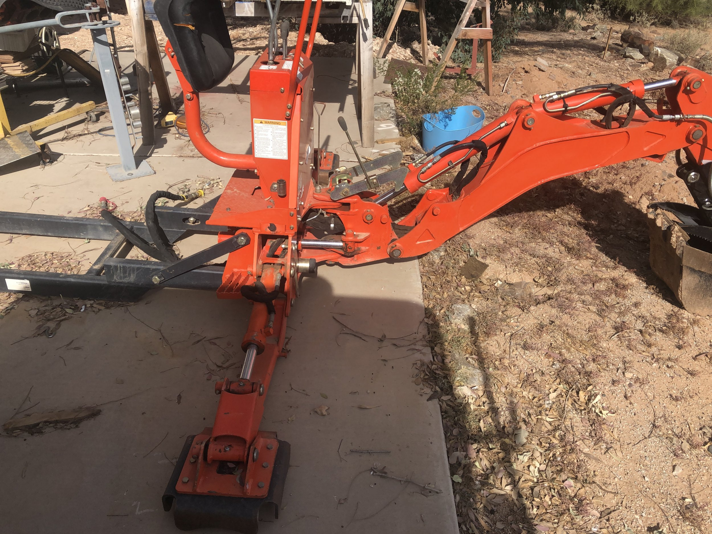

Hi Zmann. Older thread but I am thinking you will see this. I hooked up my backhoe about a month ago and quickly noticed that there was a lot more movement in the whole backhoe when I was digging . I stopped to investigate and low and behold the 4 main bolts holding the hoe onto the subframe had loosened up. I retightened them and all seems well now. If you look at the picture of my backhoe you will see the 2 big bolts on either side just under the step by the stabilizer . I am getting my 300 hour service done in a week or so and asked the guy if he had heard of this and he said that hoe was known to do that and just keep an eye on it and retighten as needed. Locktight next time I think.
Anyway , just something to check on your hoe once in a while.
Cheers.
/ LS backhoe factory thumb #33
I have had the same issue on mine. I check them every so often and tighten as needed. They're pretty large, so it is difficult to overtighten them.
