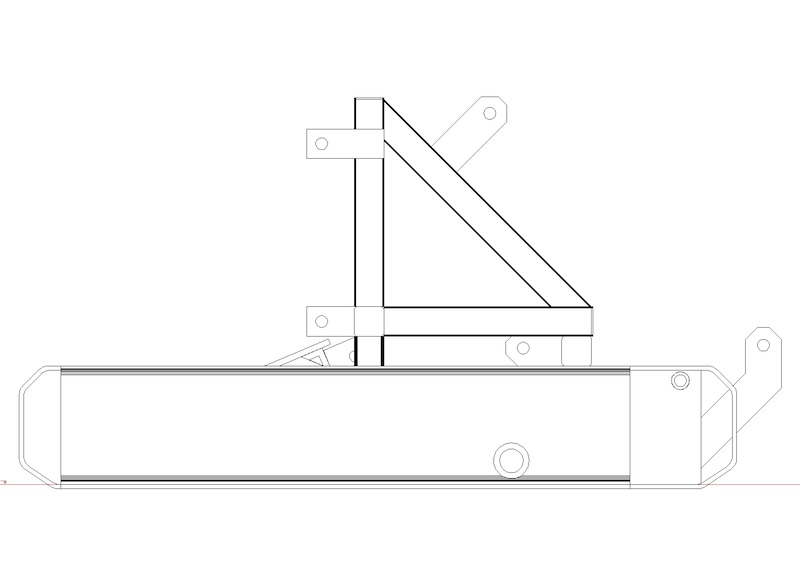

Worked out all the hydraulic cylinder attachment points and brackets.
The tailgate cylinder is Lion 2 1/2" bore x 10" stroke 2500 psi cylinder with SAE ports. Surplus Center must have an overstock of them (200+ in inventory) and be trying to move them because they were pretty cheap ($50)
It will provide slightly greater than a 90 degree range of motion, with the present bracket geometry and attachment points.
The blade adjustment cylinder is Wolverine (Prince) 2 1/2" bore x 4" stroke 2500 psi cylinder with SAE ports. A little pricier @ $64.
With the present bracket geometry and attachment points, it will provide a blade adjustment range of roughly minus 1 1/2" (cutting edge depth below the skids ... variable, depending on exactly where on the carrier I mount the cutting edge) to a positive height over 9" above the skids (again, varies on cutting edge mounting)
There is a potential interference issue with the top of the blade and my SpeeCo Quick Hitch ... but it's fairly slight. Might see if I can fix that.

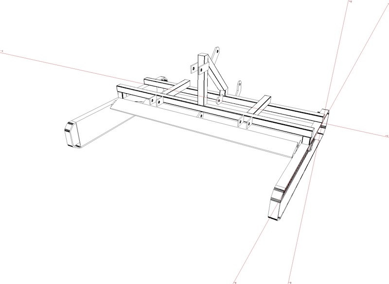

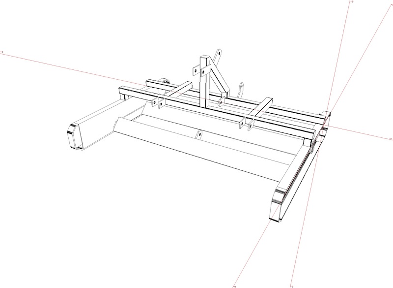

A few new renders:
Blade down:
Blade up:
   / LPGS For Kubota B2910
#86
Non-perspective (flat) sideview with blade up. (You can see the potential inference issue):

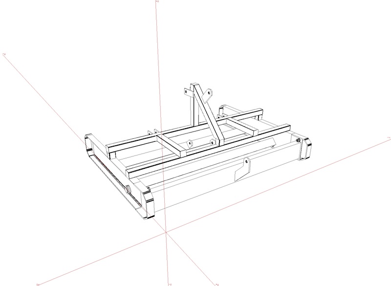

#87
A perspective three-quarter view:
(Might be more like 10:00 or 11:00 ... :laughing:)

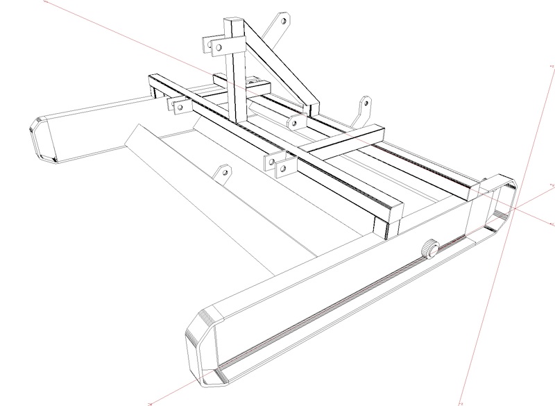

   / LPGS For Kubota B2910 #88
If you haven't already, trying filling the bucket on the FEL ... it'll get ya a little more traction ... wet soil or gravel works good ... ;)
Last time, I decided I was going to try that next time. ;) Thanks for the tip!
#89
One more from towards the rear:

Sure do wish I could operate a computer to make pretty drawings like that. Got "sketchUp" downloaded, but too dumb to do anything with it:laughing:
