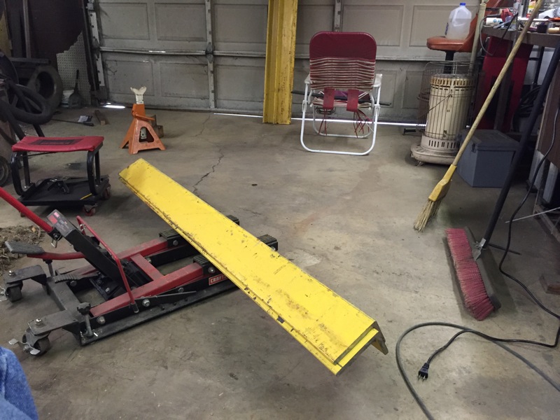

Got the blade carriers trimmed to length yesterday:
Made them 70 7/8" to allow for the 1/2" thick bars on either side that will connect them ... plus a little (1/8") for clearance.

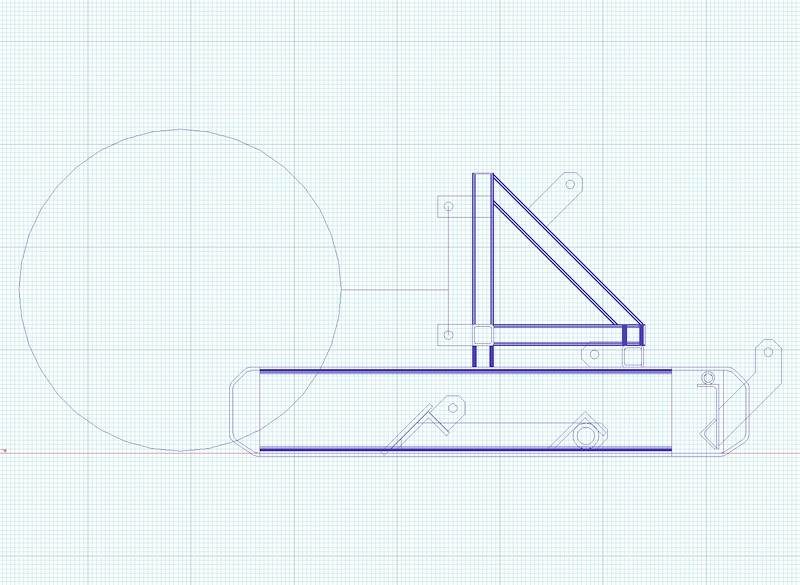

With your skids overlapping the rear wheels, you are limiting the tractors this can be used on. What if you weld the 3PH frame to plates (4 total) which can be bolted to the top of the skids, rather than welding the frame directly to the skids? Then you could move the 3PH frame forward or rearward if needed to better balance the LPGS on smaller tractors, but also have the ability to move it all the way up front and use it on tractors with wider wheel spacing. Just a thought, since this is going to be a great scraper built to last decades. You never know what you might want to use it on years from now.
   / LPGS For Kubota B2910 #78
There are some definite advantages to being able to adjust the frame placement as you mentioned.
My concern still is the overall width and weight is pushing the limits of a 1700 lb. tractor. By the time the rear gate and adjustable blade height is added to this 72" land plane it will be more than the 2910 can handle in all but the best conditions.
My smaller land plane has 60" skids and 48" blades and I know from using it that it would be close to a perfect match for the 2910. My x749 is about 1300 to 1400 lbs. 4x4 and at times it struggles to pull the 48" lpgs. If I were to build a custom lpgs for the 2910 I would cut the blades down to 56 inches and use 60 to 66 inch skid length with the ski shape and set the blades where they had optimum clearance for trash to flow through. Add a top hydraulic link and be in great shape.
For a more generic fit a 60" lpgs will work well but longer skids would be better.
Yes I am ... mine ... :D
That's actually a worthwhile idea, but unfortunately somewhat hard to implement.
The problem with it is, is that all the base end attachment points for the hydraulic cylinders are on the 3PH frame.
Start sliding the lower portion (skids) around - relative to the 3PH frame - and all of sudden hydraulic cylinders don't fit ... or have a very different range of motion.
That's true ...
It doesn't really look like I'll be getting another tractor ... but that could change I guess ...
The distance from outside to outside on my rear tires is > 54" ... I have 72" between the skids/side plates.
That's an additional 9" on either side.
Of course, a larger tractor will have larger diameter tires and a wider track (side to side width) ... but the setback on the 3PH lift arms may be greater as well.

I have made a couple of changes that reduce the weight a little and provide more clearance for the trash flow. See what you think:
I'll be interested to see just how well my top link works, with the weight that will be hanging back there on this one ... ;)
There's little doubt (in my mind anyways) that longer is better ... since length coincides with the direction of travel.
But there is also an issue - at least for me and my equipment - of weight past the pins on the 3PH ...
It's always a series of trade-offs ... ;)
