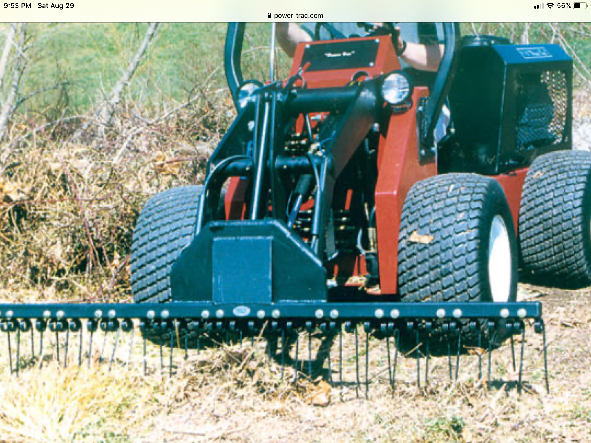

Sorry - NCstriped was obviously talking about a power rake.

That's a dethatcher..... and it looks like the tines are backwards.

So far I have only used it for planting grass.
I guess it will rake leaves - I will find out.
I do hate raking by hand so that could be good put I generally use the leaf blower anyway.

The tines are not backwards....you run the machine backwards.
I get more use from the rake than expected.
Leaf raking it's great I can accumulate faster than the blower especially when damp leaves are stuck to the ground. I usually accumulate a line then blow to the destination.
Also good to prepare for overseeding and spreading light material like mulch.

Gotcha. I have one similar that goes on the front of my Walker mower. ..I just assumed we were looking at the front of your machine.

You are looking at the front of the machine.
....that's even more strange...so you have to run it backwards ? ...my neck hurts just thinking about that. If you can turn the tines around and drive it forwards it would probably be a lot more efficient

If you turned the tines around and drove forward, the tines would dig in and the machine would try and drive up over them.
If you put gauge wheels out in front of the tines, then you could drive forward.

That makes sense, mine does have the gauge wheels..I forgot until you said that

It is one of the few attachments that you use with tractor in reverse. The beauty of the PT is all the other attachments that are right in front of you as you drive forward, unlike a 3pt hitch which hurts my neck looking back.

I think a rake like that on the PT would be handy for cleaning out ditches or under pine trees.
