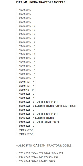

I thought so too until I realized that same clutch is used in a Case/IH 523 which has 11 more HP. I think its more of a one-off failure, especially with only 250 hours on the machine.

Yes, I was amazed to see that the same clutch plate is listed as a replacement on an 80hp Case/IH 845. Should defiantly be strong enough for my little 40hp Mahindra.
   / Loud bang and the clutch stopped working .... #16
You mean it has the exact same part number??
