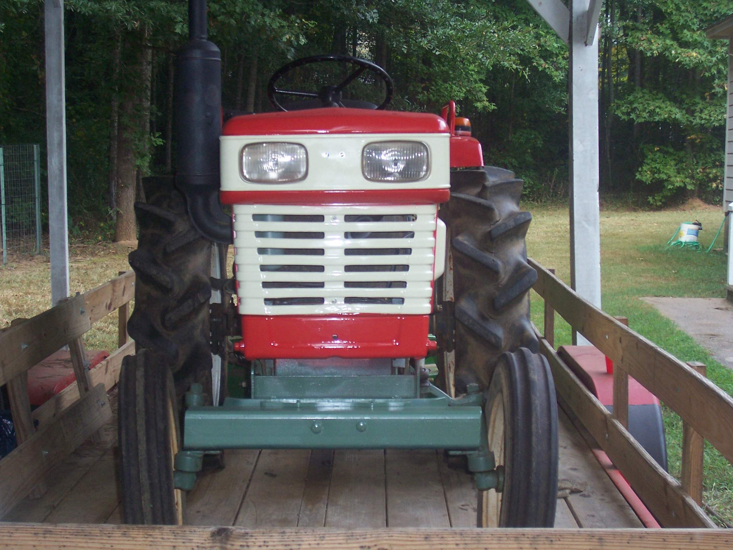

This morning at temps around 35* I started the tractor without the normal glowing time, to see if in fact this position of the switch is glowing the plugs, and it must do... because I turn to start the tractor right away and it took about 6-7 seconds to start and a large puff of smoke came from the exhaust,
so it will crank and run but takes longer to start, typically as I said before I would turn the switch on for around 10 seconds and then on to start and it would start right up in a matter of a couple turnovers, so I'm thinking my assumption of this type of ignition switch has the glow on the on/run position:thumbsup:

I'm confused:confused:. Your profile says you have a YM1700. If so, you do not have glow plugs, other than TS, and it is, (should be), active only in the TS switch position.
I might have confused my self here on this statement, of corse it is TS not glow plugs, I must get a manual some day and read up more on the terms used for the technical parts of my tractor:D
and about the TS position which way are you saying suppose to activate or heats what ever it heats;) in order to start the engine? there is simply No turning my switch to the left either.

Do you have a clutch safety switch? (It interrupts the cable to the starter unless the clutch is depressed.) If you do have the clutch safety switch - put the transmission in neutral then turn the key to Start with the clutch engaged. This should send power to the Thermostart but not to the starter. After 10 ~ 20 seconds release the clutch to allow power to the starter too.

Safety Start Switch. Left-center in the schematic. Black/white wire tracers. It is a solenoid the size of a golf ball mounted above where the clutch rod goes into the bell housing, and the clutch linkage includes a tab to push the plunger up.

No no no guys, I suspect ALL Yanmars were all born with the clutch safety switch, (some have been by-passed), just never heard of the thermostart being activated in the start position when the clutch is disengaged, (switch open).

its I'm just trying to come up with a logical answer for both of us, I cannot argue the fact that my ignition switch might have been replaced in the past, only that I know it will only turn one way, ( to the right ) and that it will start faster if I let it sit on run for 10 seconds before attempting to start it,
here is something I found from Hoye tractor parts, this is to be an ignition switch diagram for my 1700
