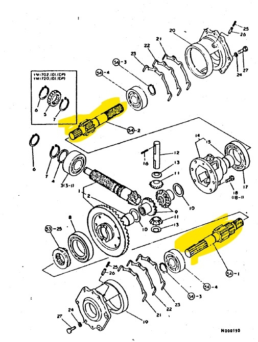

Are you saying you do not have rear wheel drive? Front wheel drive only?

It sounds like you are saying that the rear wheels are not trying to pull at all- only the front. If that is the case then you likely have a broken brake stub shaft or something wrong with your rear differential. The stub axle shafts were a pretty common problem on those models. They were usually broken when an operator would depress the differential lock when one of the rear wheels were spinning in the mud.
If it were a powershift problem it would not move in 2wd or 4wd.
Aaron

"I can shift out of 4wd smoothly, but getting into 2wd is super stiff/stubborn."
It's shifting into gear so I don't think you broke any Hard parts ...... Sounds to me like the clutches are slipping. Dirty Screens, Filters, Low Hyd. Oil pressure Etc..
