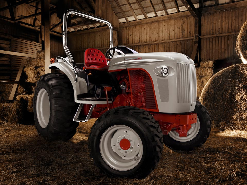

Hello,
I am looking to purchase my first tractor. From my extensive research online and locally, most of my questions have been answered but I would to hear your guys opinions.
What the tractor will be used for:
40 acres tillable (currently leasing 35 of this and using 5 for sod/garden but may take it over as time passes)
80 acres forest
bush hogging
log yarding
snow blowing
Goals:
Want a tractor that will be able to work the field and go out in the woods and yard logs as well as general grading of roads
Specs I think that are priority
4x4
50hp
bucket loader equipped
3 point
remote hydraulics
Price range
25k
Units I've found:
New Holland Boomer 8N low mileage, meets above critea
McCormick CT50U low mileage, meets above critea

The Boomer 8N makes 50 hp?
Must be the special edition that NH made back in 2009-ish.
