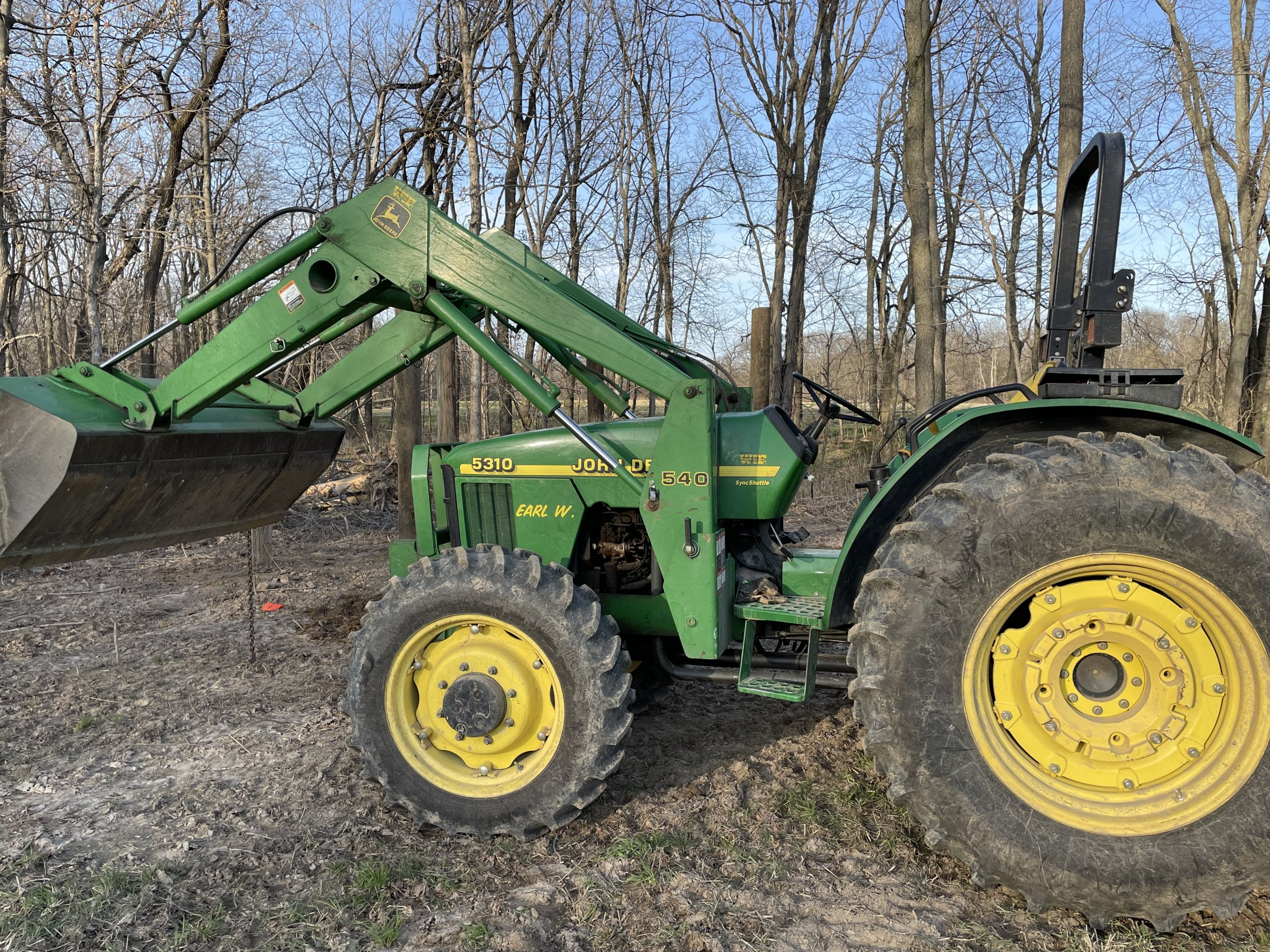

This is a friends tractor. JD 5310, it’s around 20 years old. It’s a clutch and stick shift. I personally wouldn’t want that system but he is good with it to the point you would swear it’s an HST. The advantage of something like this used is it’s around 60 hp and 2500 pounds of lift capacity.
About loader capacity. Look at the specs carefully. The lift I quoted above is at the pins. Sometimes they list the lift so many inches in front of the pins. In the real world you aren’t lifting at the loader pins but things in the bucket or on forks. Just make sure you know how the loader is speced.
Dalton, this was back on message #12. If I was doing the work you are describing this is EXACTLY the kind of tractor I'd be looking for and hoping to find. Not beat up, 4wd, JD, powerful, manual tranny & clutch, and 20 years old. Look at that heavy front drive axle... & it even has decent tires. Smallish loader, but heavy 3pt lift. My guess is it will go for somewhere at the top of your dollar range.
