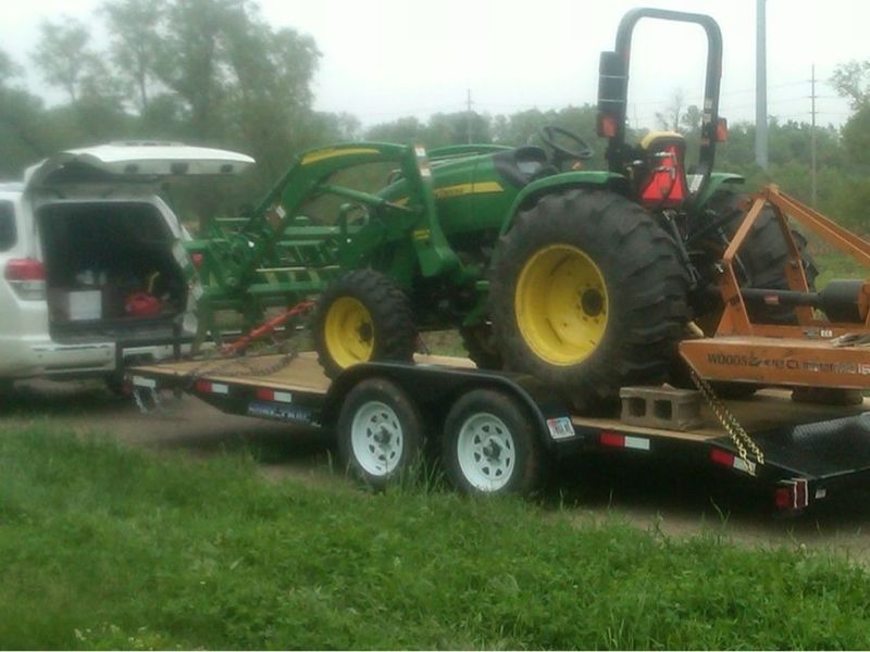

I have an 18' Trailer and my CUT barely fits -- guessing you'll need a three axle trailer.
