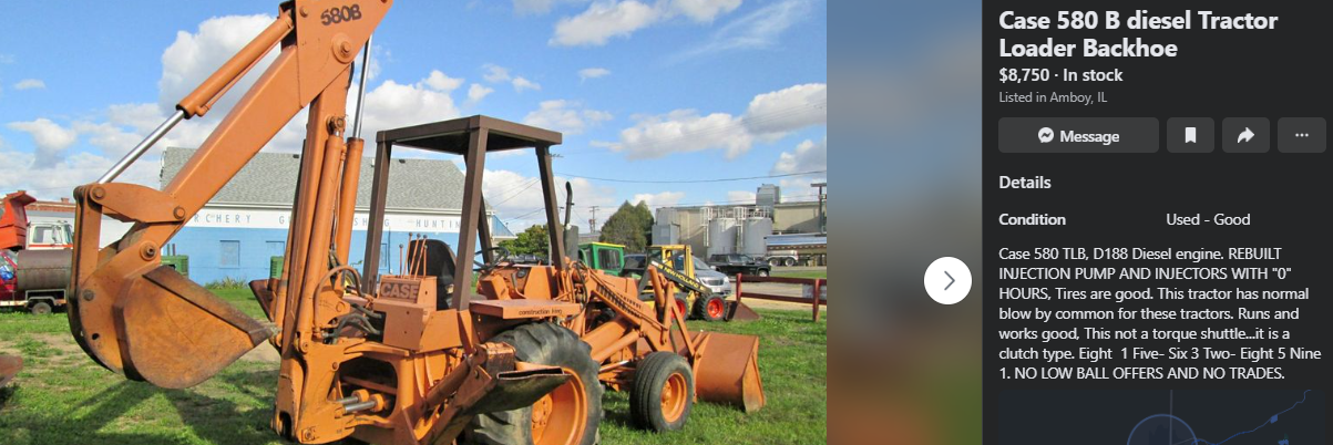

Exactly what I'm recommending. I wonder if it could possibly run anywhere near as good as it looks? What it looks like for that price is if it runs and works it is pretty close to a steal. A guy could use that 580 for a couple of years and sell it for same. Both the Case 580 and JD 310 of that vintage are very similar. But if you aren't the kind of person who enjoys tinkering with old machinery I'd give it a pass.
A lot of times the work to be done doesn't depend so much on how much land it is, it depends on what kind of work it is. An old Case 580 or JD310 can scoop and move close to a cubic yard of soil and and kind of rock at a time and handles it without stress or damage. The loader can push snow like a champion, and literally lifts tons. The bucket alone weighs a thousand pounds. We used the backhoe on ours to turn over the soil on a 20x40 garden plot. A tiller could have done it better, but no easier. Trenching? No problem... Trees? Rocks? all the same.

Add in the industrial backhoes ability to lift around a ton with a chain from the backhoe bucket and its ability to place it wherever wanted as well.
With all the rock digging being proposed an older "good" working TLB sounds like a perfect fit.
Until a new prospective buyer that has not had a fair amount of experience, actually gets to use a full size TLB and utilize its mass and hydraulic power, It is hard to really understand just how much difference there is when push comes to shove versus a brand New and Shiny CUT.
I agree with rscotty and finding a decent Case 580, that way if a problem does develop everything is modularized and should be easy to service.
