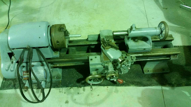

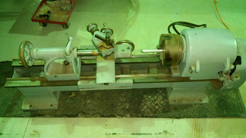

Around here, he is asking "full market price" for that, assuming it is in good condition with minimal tooling, up to maybe 2000 fully tooled. Worn out it might be 500 to 800 bare and 1200 tooled.
Look at it this way, if you did both halves of the transaction separately, and dickered down to 800 on both sides before closing the deal, could you still live with it, knowing you got a pretty good deal on the lathe and did not get full value out of the snowplow? If so, go ahead. If it would feel like the amount you saved did not compensate you for the value you lost on the snowplow, then either walk away or see if he will chip in a little. And by swapping straight up, you just saved a ton of time dickering. Reduced hassle on a deal has value to me, but if you like dickering it might not be worth much to you.
But if the snowplow is something you can't use and you really want a lathe, my gut is to go for it (carefully, making sure it's not worn out and busted enough to concern you, or with compensation in tooling, money, or other trade goods if it is).

As to the lathe, its a nice little lathe. Smaller than what I would want, but a nice little lathe none the less. But more important than looks or tooling, is its condition. A few posters ago mentioned all this. And making sure all the feed and speeds work. Would hate to get it and think everything works and the first time you need to turn some threads, that particular pitch wont feed but all the rest do....

If it is something that you are still thinking about there is or use to be a couple of places not to far from you location. If you do a search in the GRand Rapids phone book I know there are still some in that area. I use to live not far from your location. The shop I worked at had lathes from 8 foot to 40 foot beds. We had one just like you pictured that we used for a lot of small parts

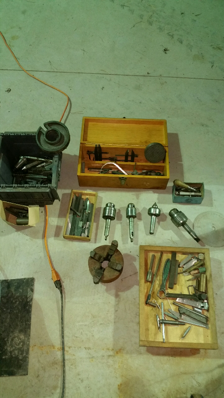

Try to wait for the machine that is loaded with tooling, even if you have to pay a little more than what you had in mind for a budget.
I was fortunate to get my mill and lathe that way. Tooling and DRO's were prob worth 3 or 4 times the value of each (used) machine.

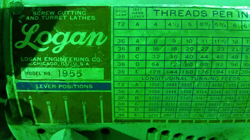

I have asked the guy. I'm assuming he will get them tomorrow along with the finish mower he mention. Only lathes I have seen are $2,000 or so but the problem is they usually are 3ph and 360-460 volts. Only got single phase and up to 220 volts
How many turning tools and associated stuff comes with it. Good set of turning tools can be worths more that the lathe.

I have the same lathe as in the photo. I paid $300 for it about 5 years ago. Nothing wrong with it, works great and isn't wore out.

the tolling will cost more than the machine many times, if your getting all the tooling and it is ready to go, may be a very good deal, you go and start buying tooling even import tooling, will add up fast, some In my opinion is what the extras are, and how usable it is when you get it,
I bought a few old lathes about 30 years go, and I have easily spent over $1500 over the years on tooling and stuff for the machines, and would still like to add more yet,
If it was me I would prefer a little more between centers on the first unit,

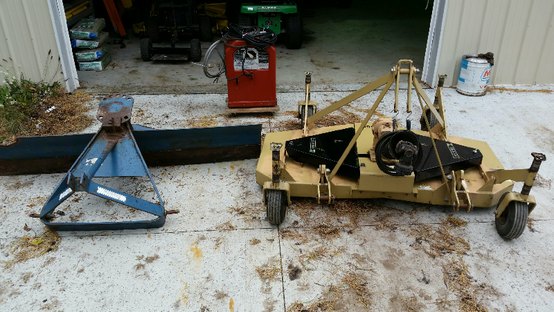

Guy is coming from 2 hours away to trade my plow for his finish mower back blade and arch welder.
Reason why I went this root is I need a mower for pastures which right now I hopefully will be able to take the shaft off this and do a first cutting with my brush hog, back blade for fixing the driveway before winter, and lastly welder so I can start learning to weld. My dad can weld in his sheet medal shop but I really want to start learning to weld

Probably a comparable trade vs the lathe. Mower $500-$600, blade $150-$200, welder $150-200.
Is the welder AC? If AC/DC?

I'm not sure. Didn't think to ask but I'll find out tomorrow morning when he comes. Your prices are right on point really for what I was thinking. Right now multiple equipment is better for us

I would say that the value of the basic lathe is probably $500 to $750 depending on whether it has quick change gears or not; and more importantly, how straight the ways are. Tooling runs up the price quite a bit, so I am not sure what comes with it. It could be worth it, maybe not.
