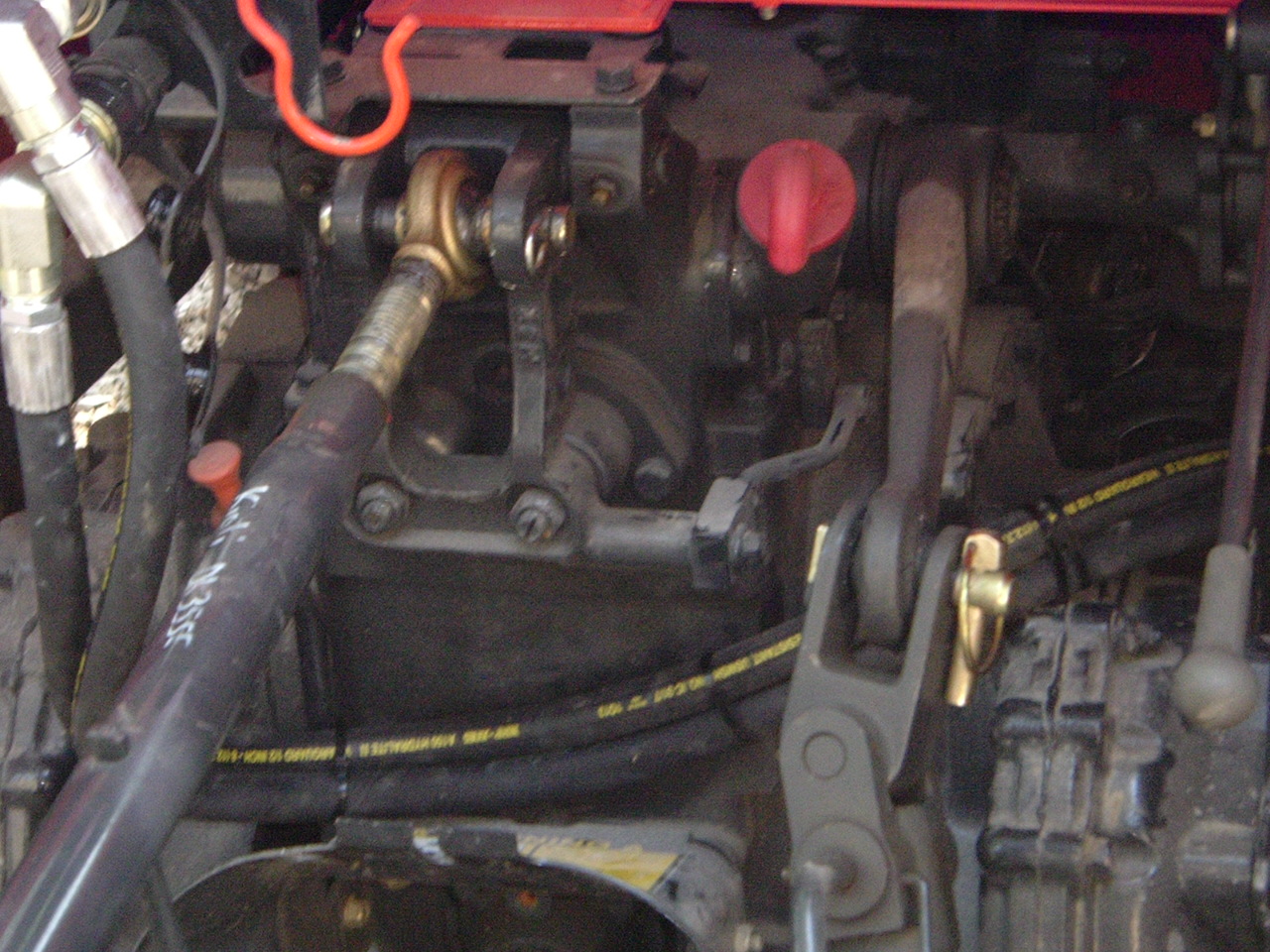

Remotes are pairs of Hydraulic Ports usually on the back of the tractor. They terminate in QD or Quick Disconnect fittings so that you may plug in mating QD connectors to deliver hydraulic fluid to other devices you may wish to operate using the hydraulic system of the tractor.
These remotes are controlled by control valves onboard the tractor. Tractors can be set up with 0, 1,2 3 or more of these "remotes" Some are standard original equipment, sometimes they are added by dealers or users. I only have one set of remotes at the present time on my tractor. I have "plumbed" them to go to the front of my Front End Loader to operate my grapple.
Of course in a few seconds, i can disconnect the hoses leading up front, and use it to power something at the rear of the tractor like a hydraulic cylinder for a log splitter or what ever I can build or buy that needs fluid power.
Hydraulics are a wonderful thing. They are only limited by your imagination.:) In the photo's you can see the Selective Control Valve that controls the remote, just in front of the joystick. Also you can see the remote pair of QD's on the back and the hoses I ran to the front to terminat in more QD's where the grapple hoses plug in. There you go, a little tractor 101:)
