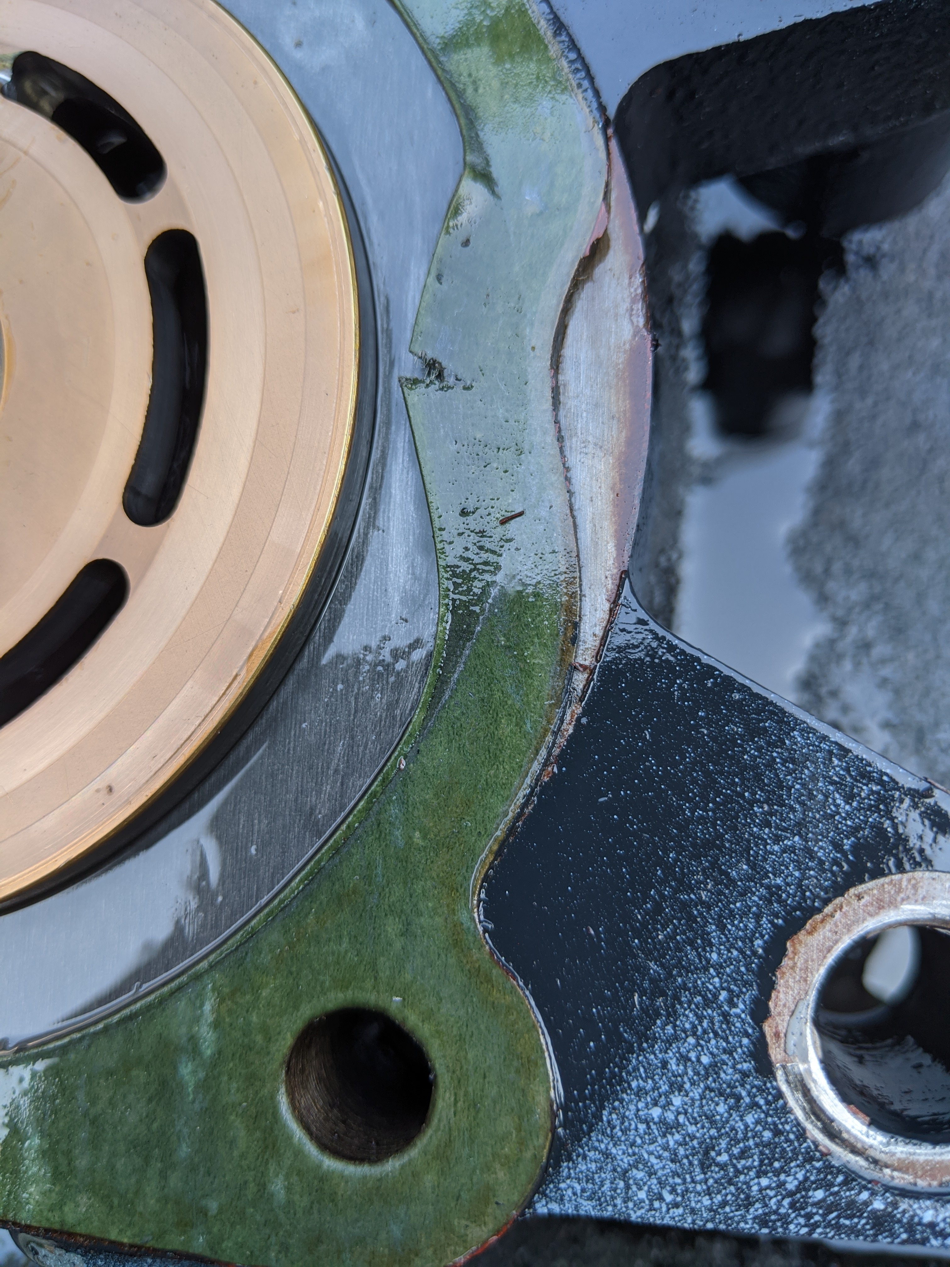

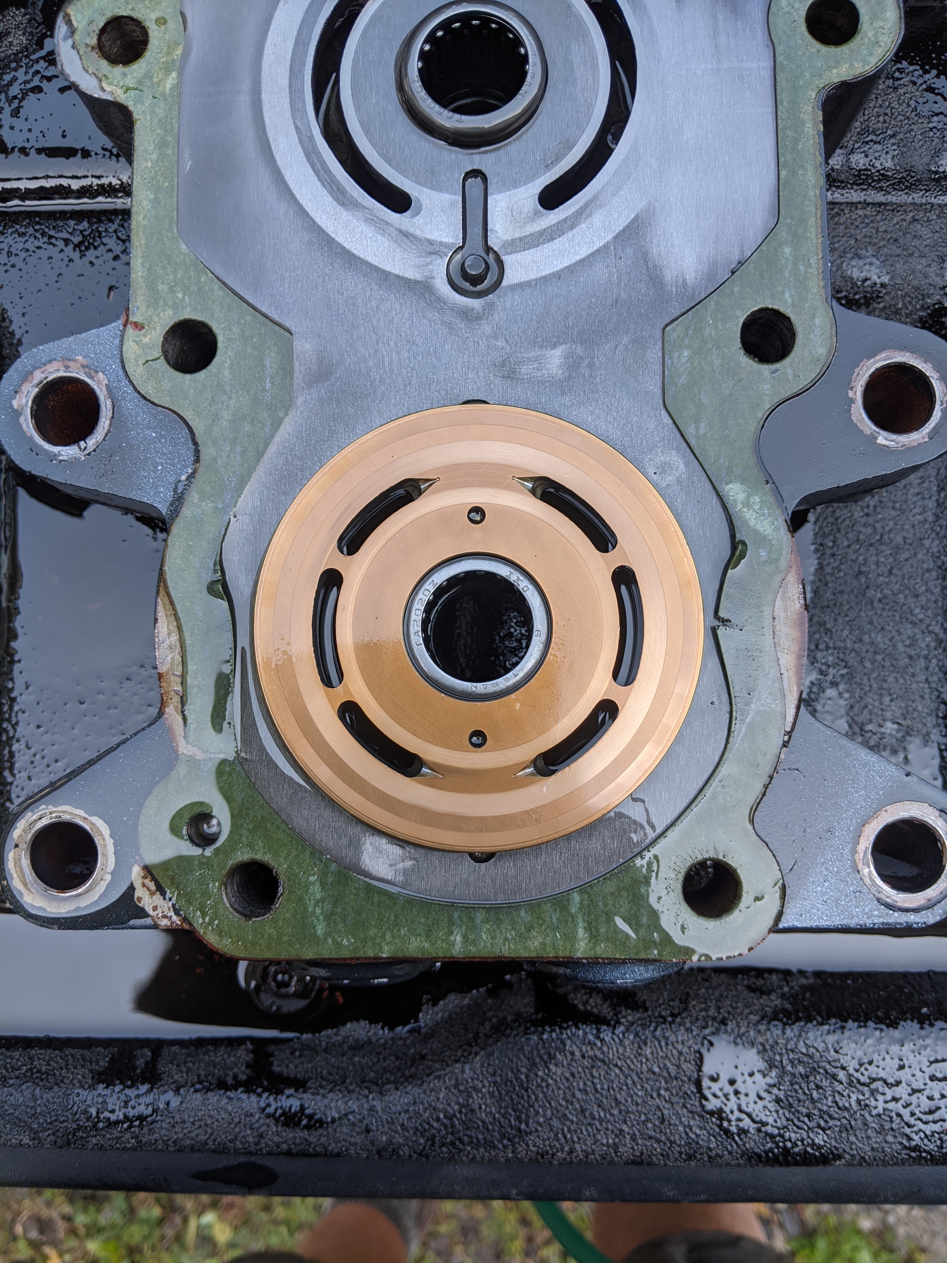

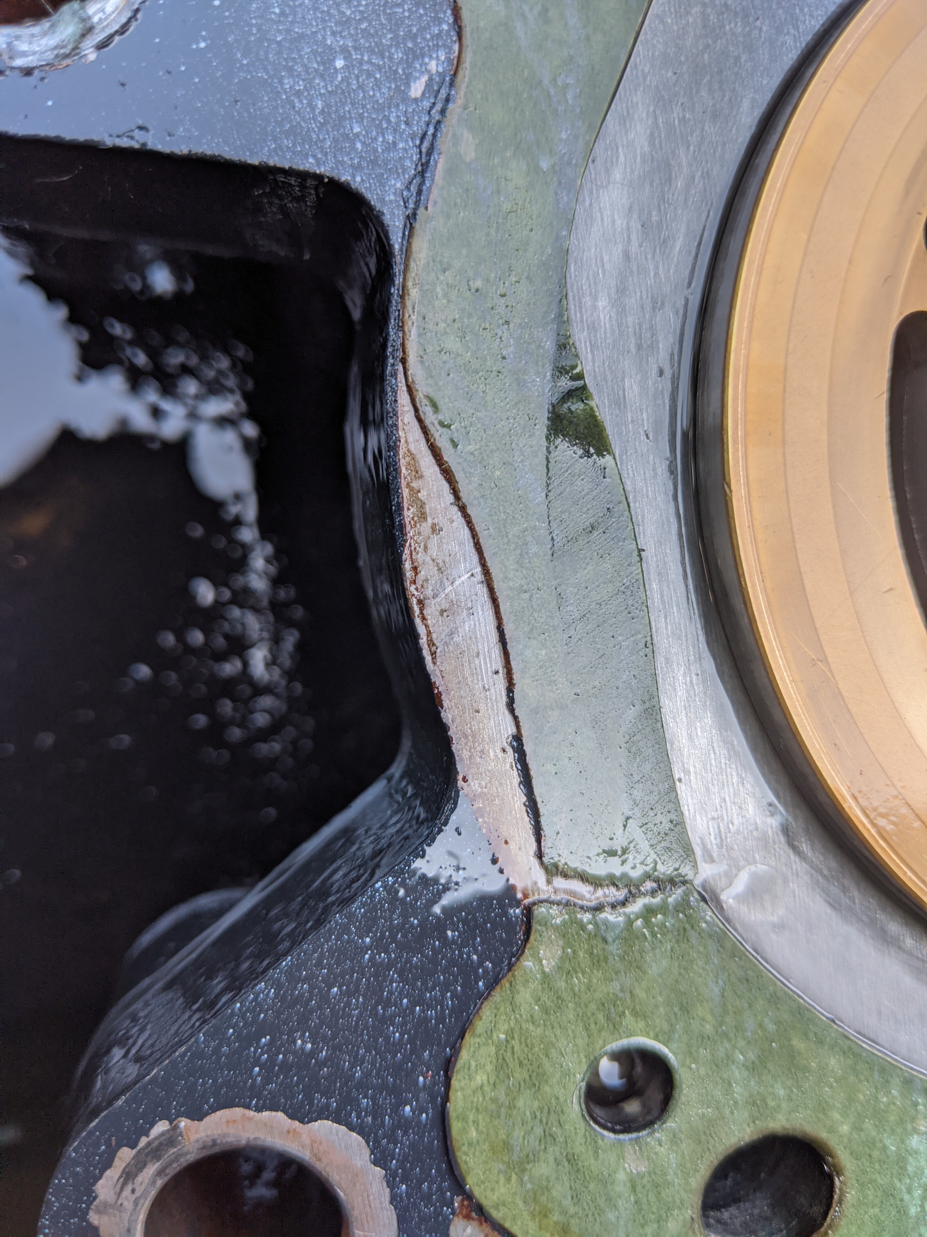

Long time no post... I'm in a bind.
I'm looking for a cross reference for Bobcat PN# 6697252, Gasket, for the hydrostatic assembly.
It goes between the Front Cover casting and the pump body.
Bobcat CT235 SN# A9JY11001 & above.
Hopefully Kioti still carries the part, but I don't have a parts manual for them.
Thanks.
   / Looking for Discontinued gasket
This is the part in question. You can see the deformity in two places. I don't know how it ever not leaked.

Interesting how the gasket got sucked in and cracked. Must be low pressure/vaccum in that area.
Curious what symptoms you had to direct you to this gasket. Did you have a lot of air introduced into the hydraulic fluid?
It's been like this since day one. ( the tractor is a 2011 )
You can see the witness marks on the gasket where it was clamped out of shape between the castings.
It started as a slow drip that I noticed in early summer and by the time I got my hay in the barn it was pissing fluid everywhere. No loss of performance to either the hydrostatic or the hydraulics.
