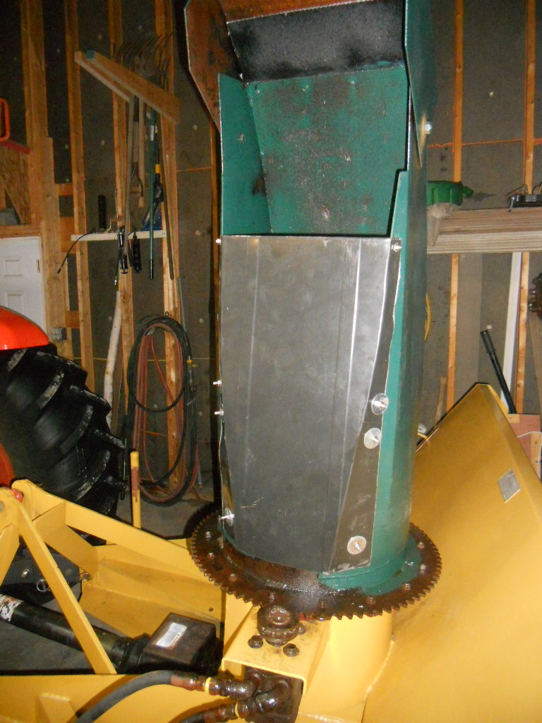

Well I covered that giant hole in the side of the chute. I had a piece of heavy (for roofing) standing seam roof metal that I felt would make a easy prototype and hopefully work for at least today. It worked fine and held up just fine. Fab time was all of about 45min. It cut the dust down by A LOT!:thumbsup: and visibility was highly improved. Busted the "A" frame on the plow and replaced "shear bolts" & auger chain's until I ran out of parts. We got about 15", not the 2' forecasted but there is no room for it. Several week's ago a rain then a few real chitty slushey snow's made the banks I was pushing & blowing today real ice'y and hard. (on equipment) Thanks for your help.

I am glad to hear the surgery on the snow caster worked and you have less snow dust.
