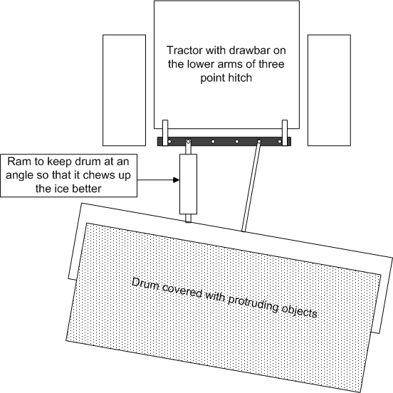

Here is a hair brained idea. If you have available one of those lawn drum rollers that they fill with water to flatten out sod and such. Or even a small barrel or something. either weld on dimples over the entire thing. Or self tapping screws. Just something on the surface of the roller to scratch up and dimple the ice. Fill the roller or drum with concrete so that it is plenty heavy. Then tow it behind the tractor. As it rolls along it could break up the ice for you or at least pit it up for better traction. Basically the same effect as studded snow tires....
/ Looking for a implement to remove ice #40
It might be more effective to run the drum at an angle to the direction of travel of the tractor. See the attached picture for an example.
Aaron Z
