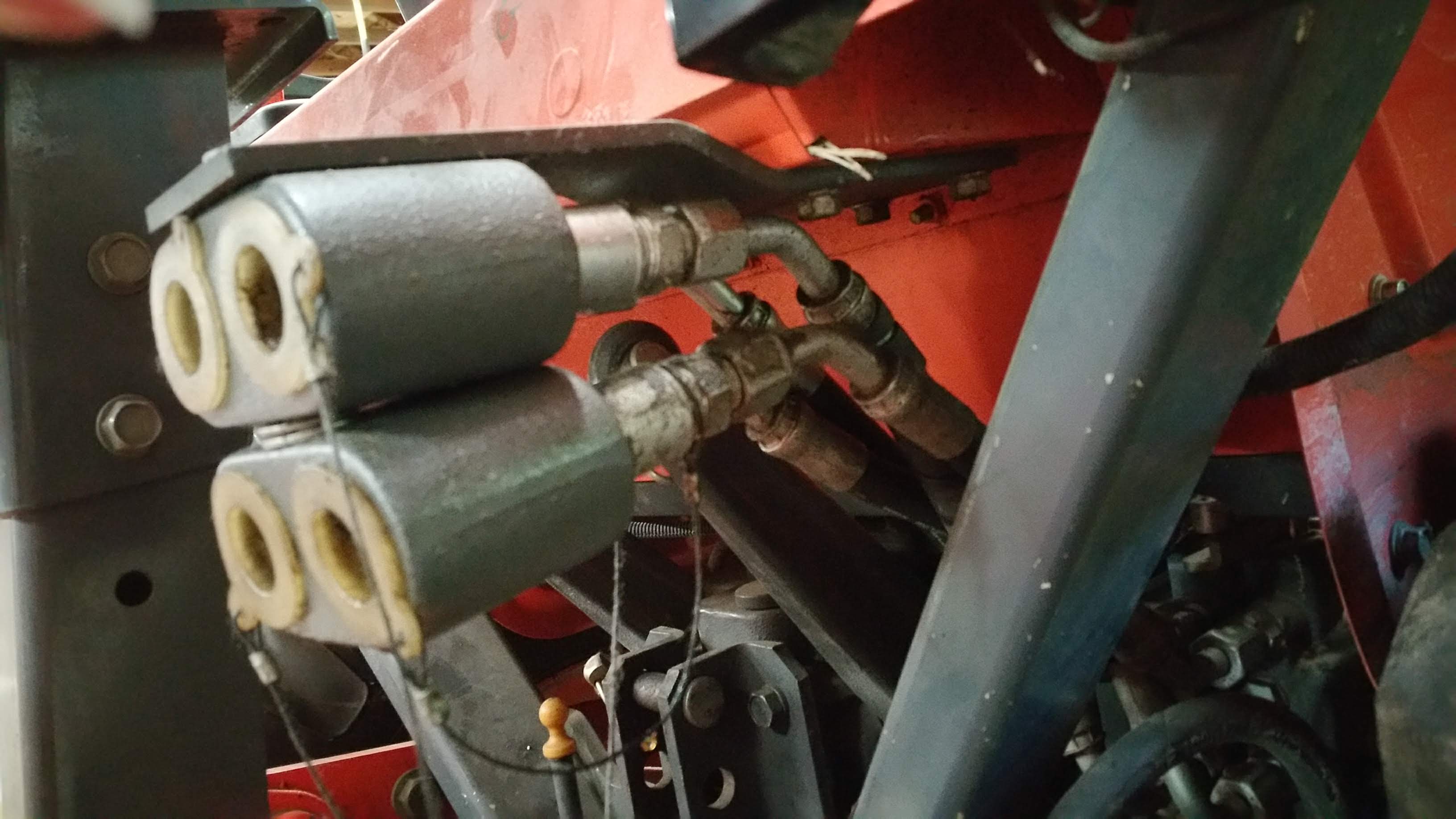

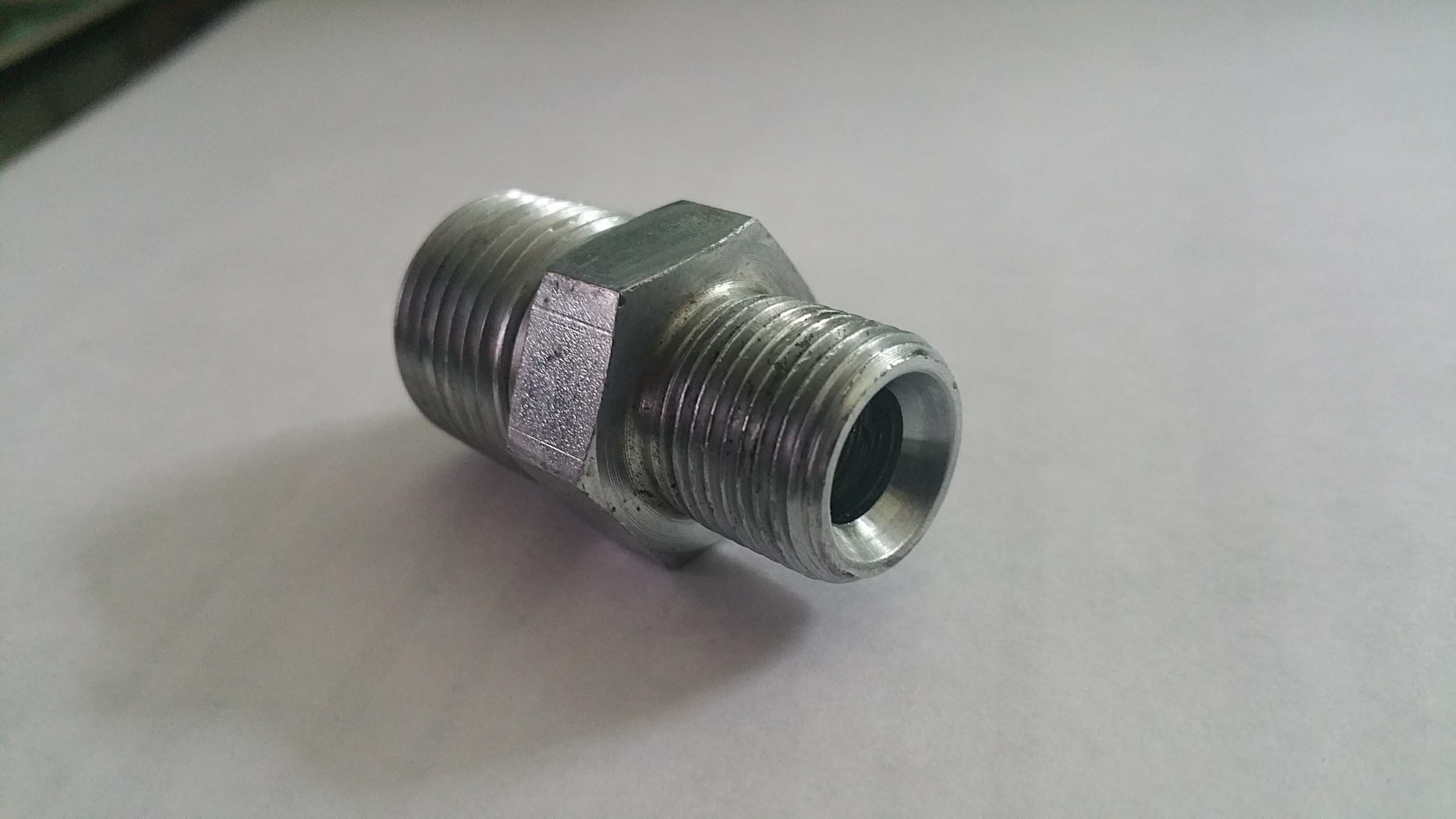

First off, I have little idea what I'm talking about, I've done research and reading so I think I'm calling everything correctly but, if I were, then I should be able to locate the bulkhead fitting I need or a way to do what I what to do.
I am replacing both of my rear remote circuits from the Parker 9006 (push on pull off) couplers to a more traditional coupler/collar. What I have is a hydraulic hose attaching to an adapter that fits into the hydraulic coupler. The coupler side is a 1/2-14 NPT, the hose side is a 3/8-19 BSPP with an internal 55 degree flare (see picture). I would like to find this fitting in a design that could be mounted in a plate I can frabricate to replace the silly and hard to use push to connect and pull to disconnect system now on the tractor (see other picture).
If you know where I can find the fitting I'm looking for or perhaps another method I can use to achieve the same results, I would be very appreciative.

Or just weld a coupling onto your mounting plate, screw your fitting into one side, mount your quick connect on the other side

Just in case, here's a good article for identifying different types and sizes
Royal Brass and Hose Blog
here's a couple places to look
Hydraulic Adapters | HydraulicsDirect.com
Pressure Connections Corp - JIC BULKHEAD FITTINGS

I didn't, this is the rear remote kit straight from Kubota, they did it. From what I understand from reading, we are about the only country that doesn't use the British fittings.
This looks like the best solution since taking the adapter path I end up with a train of adapters that is too long to be workable.
