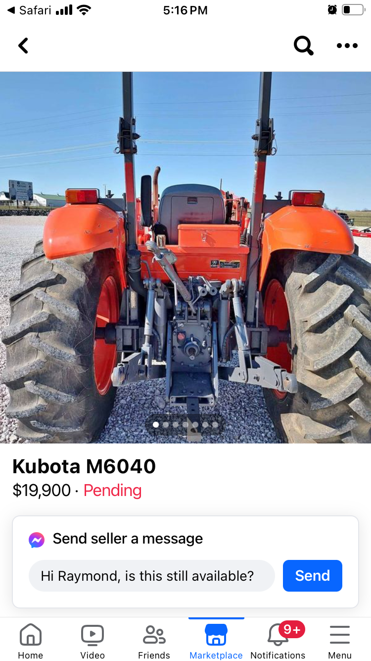

Of those I’d by far pick the Kubota. Newer and Kubota has a good reputation.

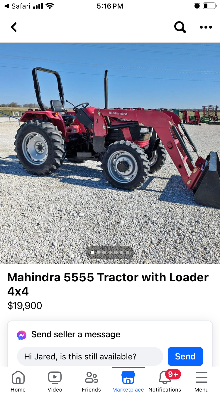

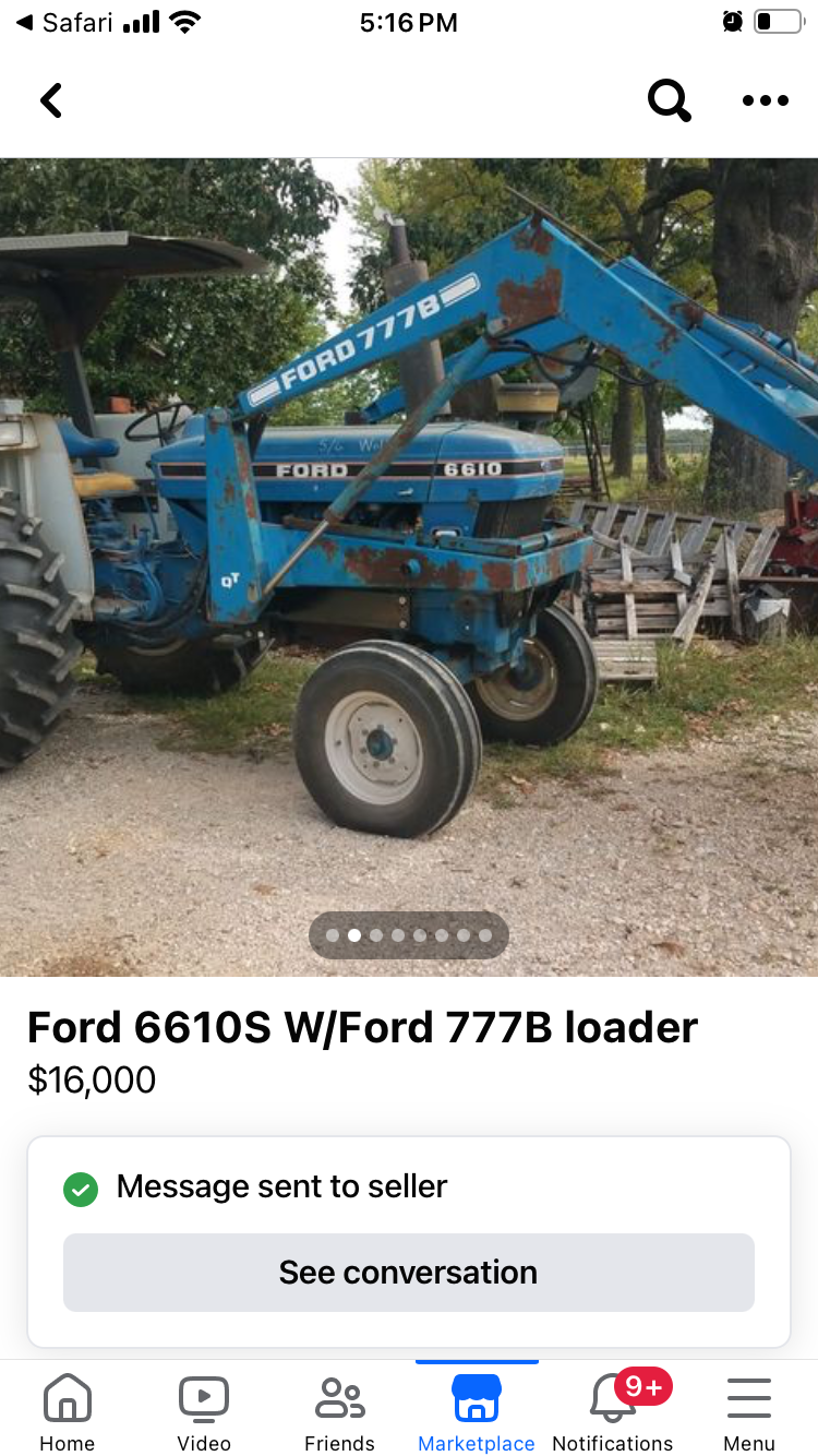

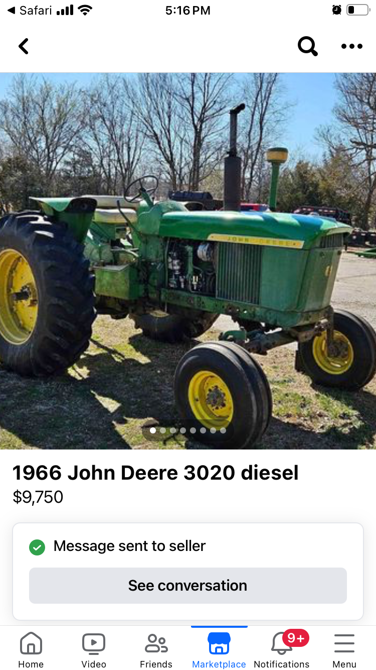

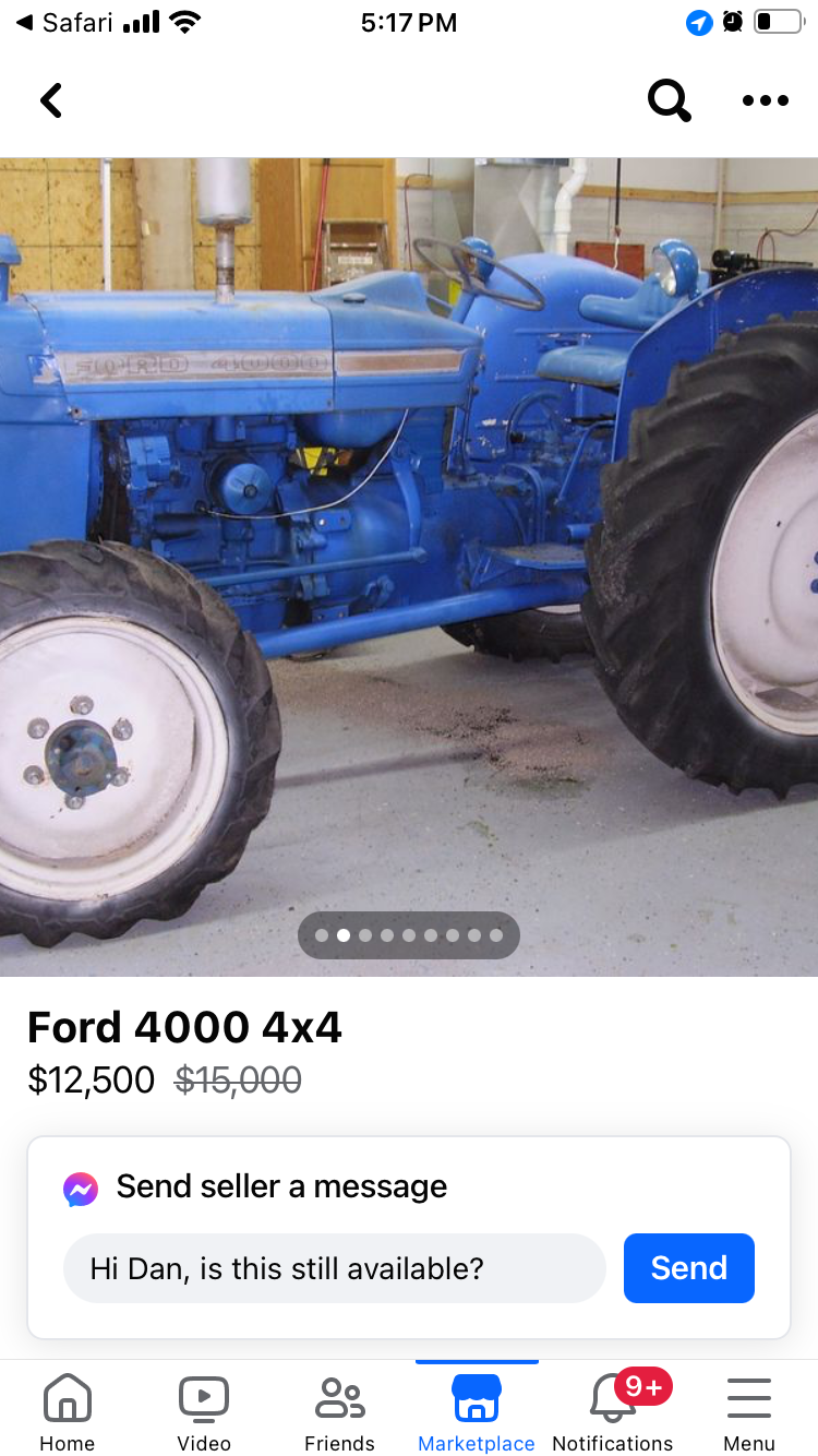

Here’s screen shots for the ones I listed.

To me the Mahindra with less than 400 hours looks like a nice deal.
i own a Ford 6610 just like the picture but mine appears to be in much better condition

Seems like a front end loader would be a very useful and important option for the work you’re looking to do.
That Mahindra 5555 with front loader and four wheel drive with less than 400 hours on it sure seems like an excellent deal. Yes be on the lookout for Facebook scams Facebook is scammer’s heaven !

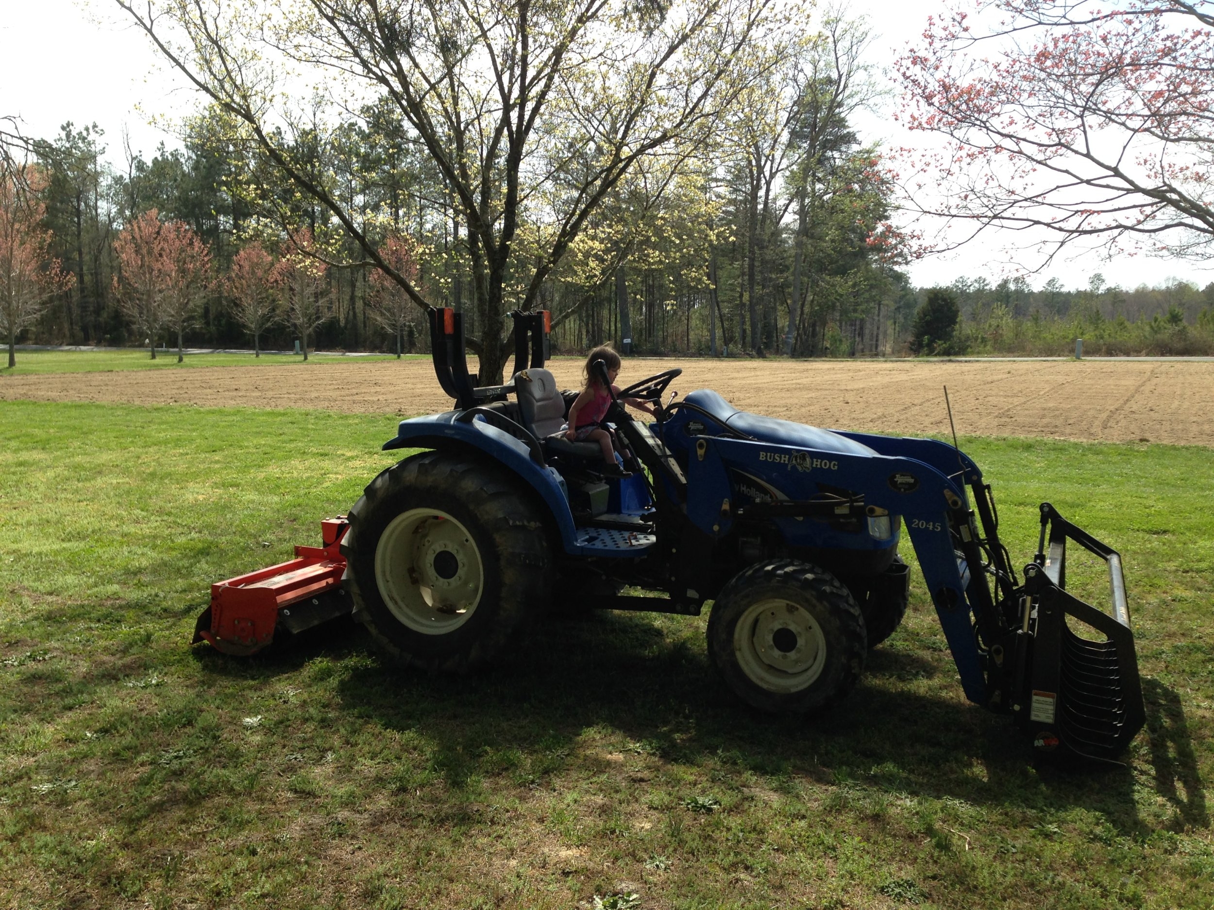

I have a 4x4 New Holland TC40. It is a 2005 model, Shibaura built. Very good tractor and can do what you want. They can be had for around 15-20K. I would shop around and look for something like/similar to this. Dont be scared to pay up to that 20K. Get the best bang for the buck and get 4x4 and loader. Buy once, cry once.
