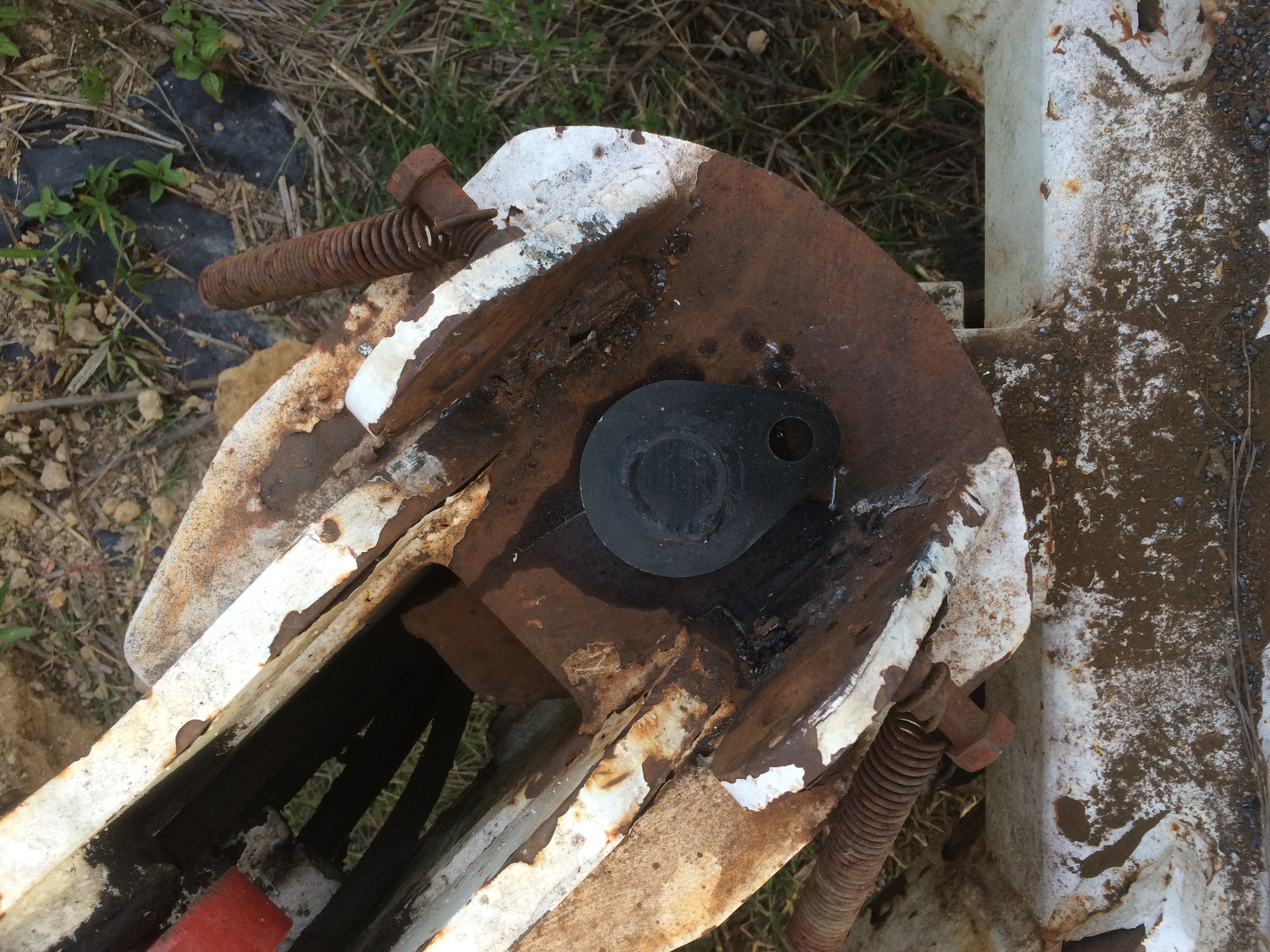

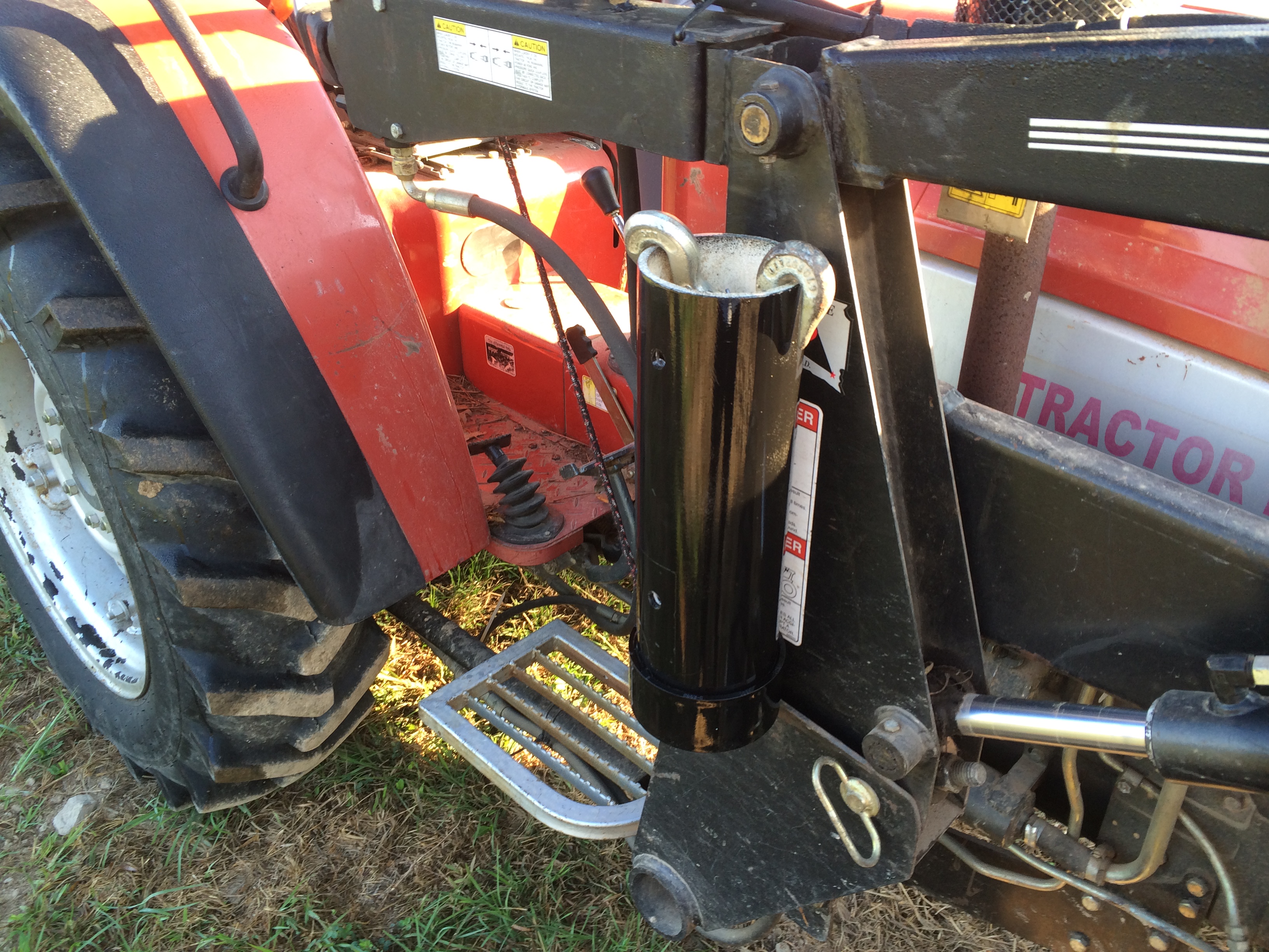

I'll end with our first casualty of the week.. I had a busted up fence section drag up and rip my quick connects apart for the FEL which drained every ounce of Hydro I had in the thing, and promptly after getting that fixed I found another section of that same fence that claimed a tire. That fence was exacting revenge for sure

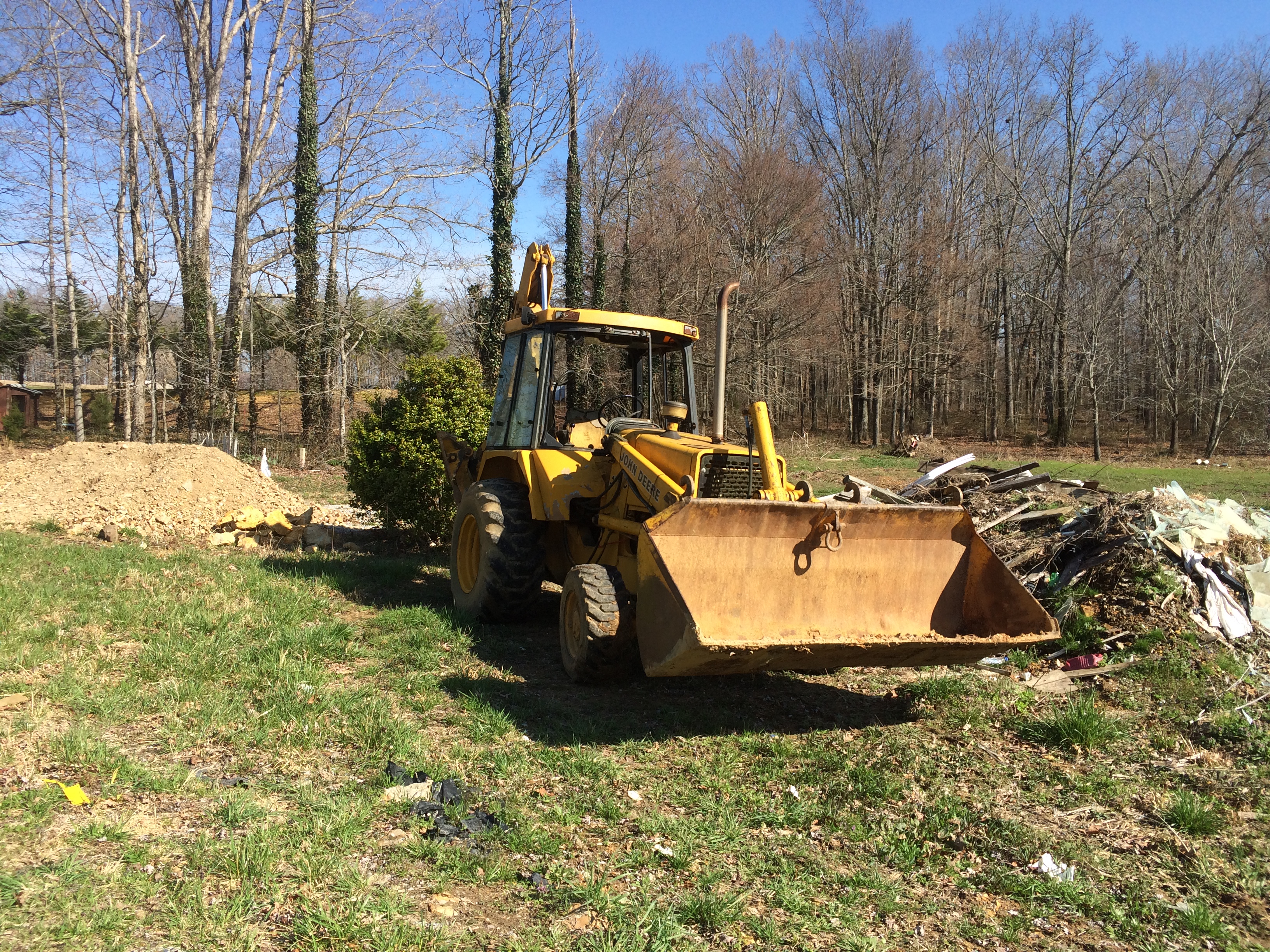

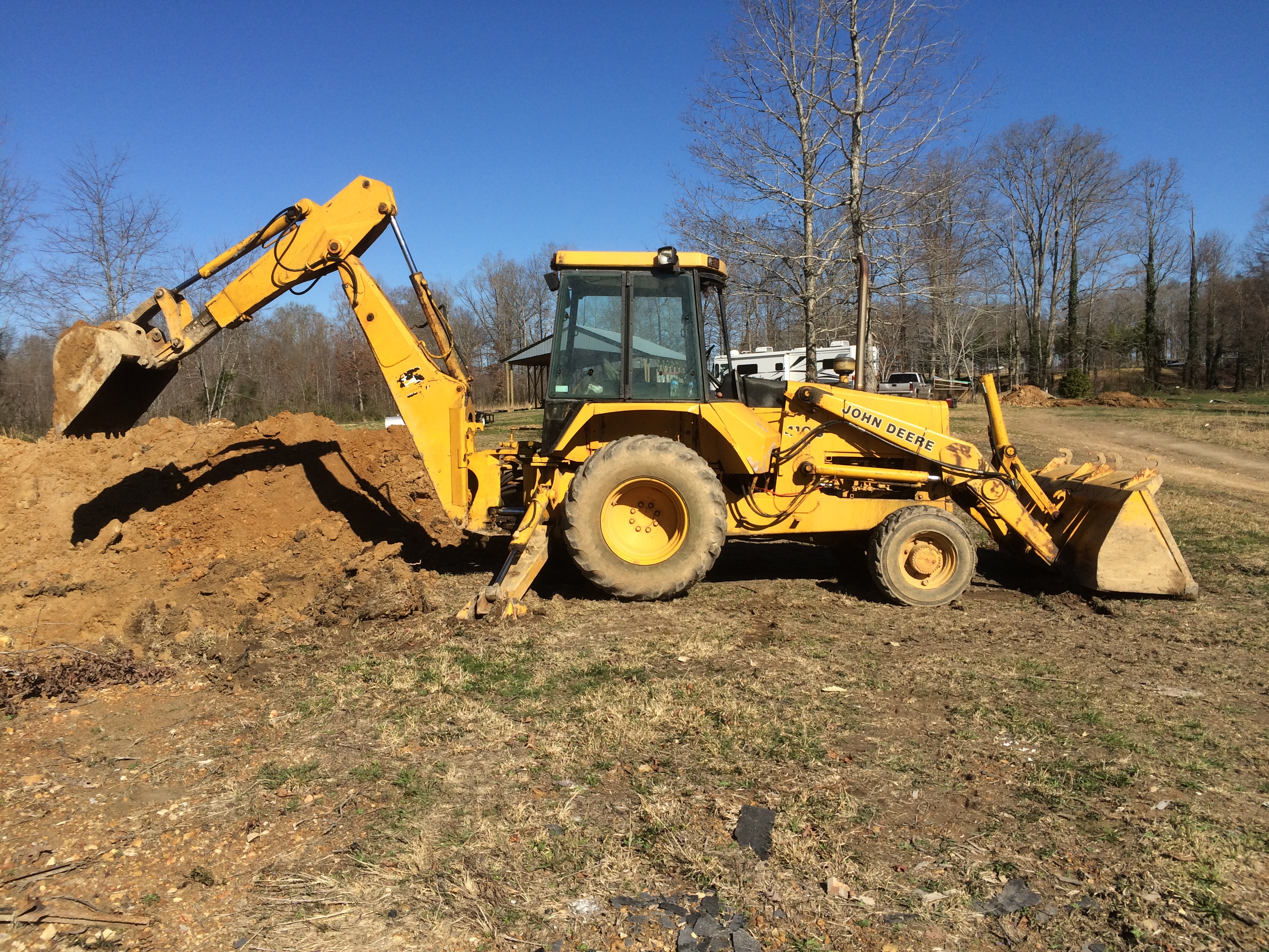

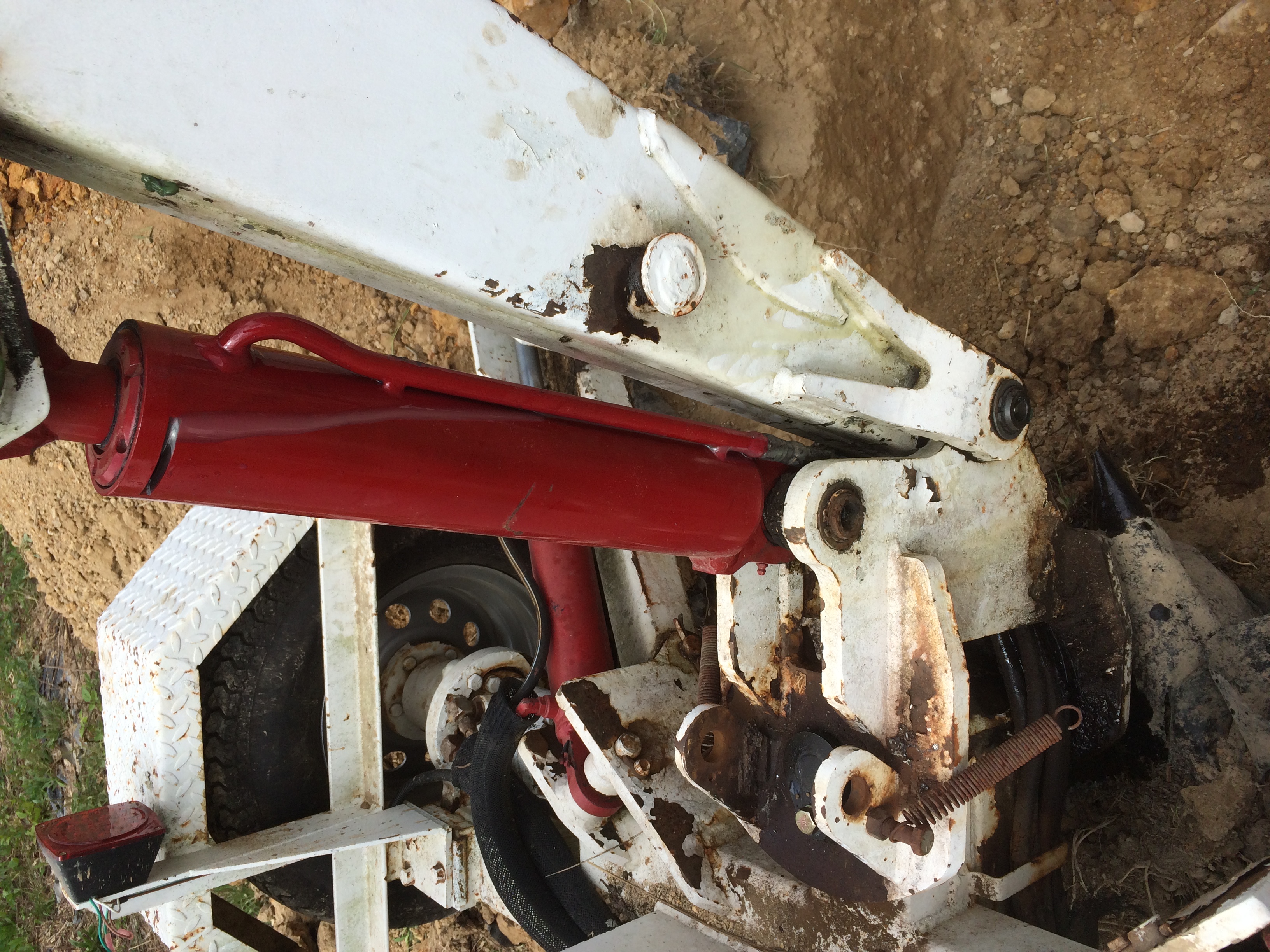

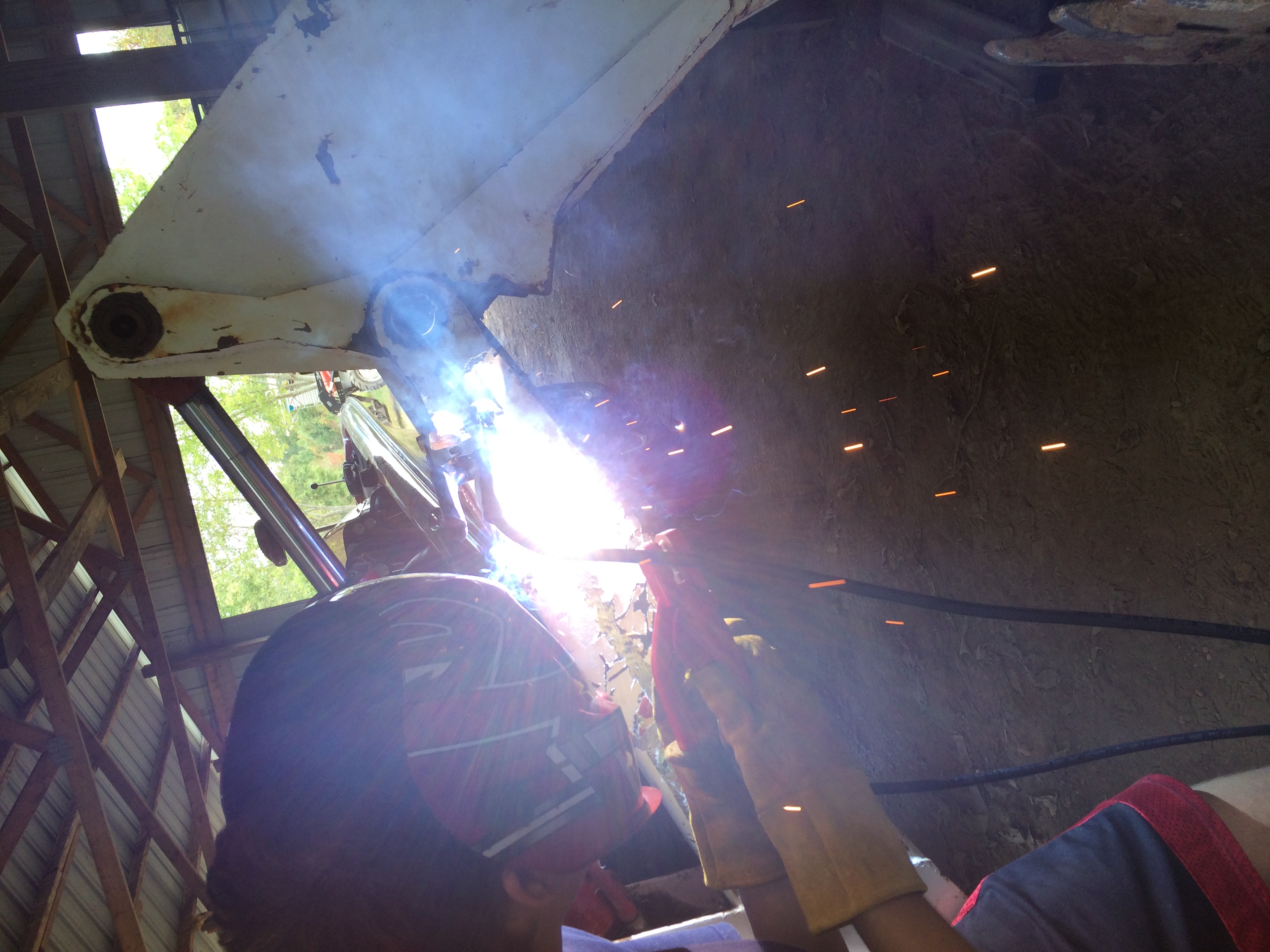

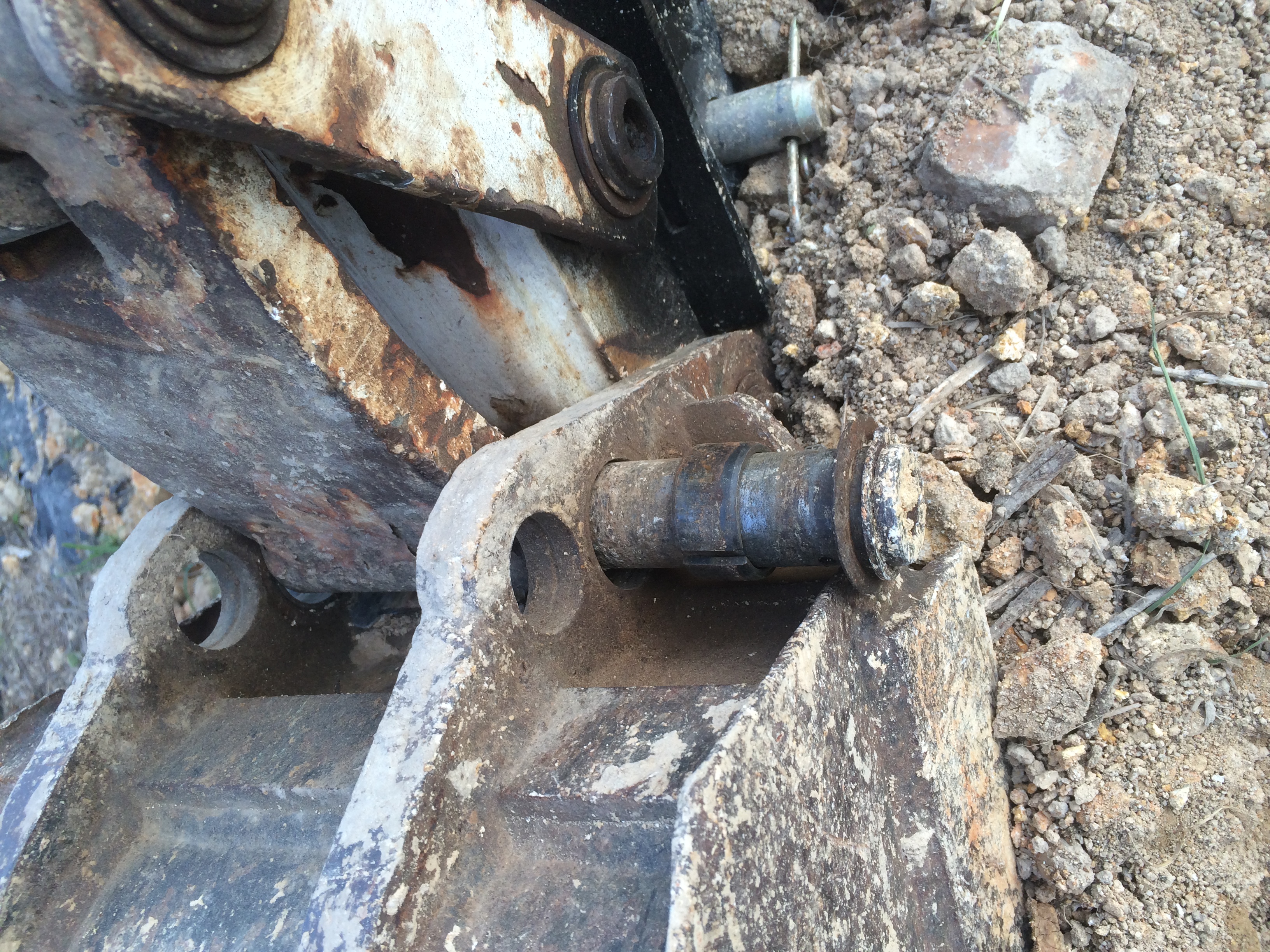

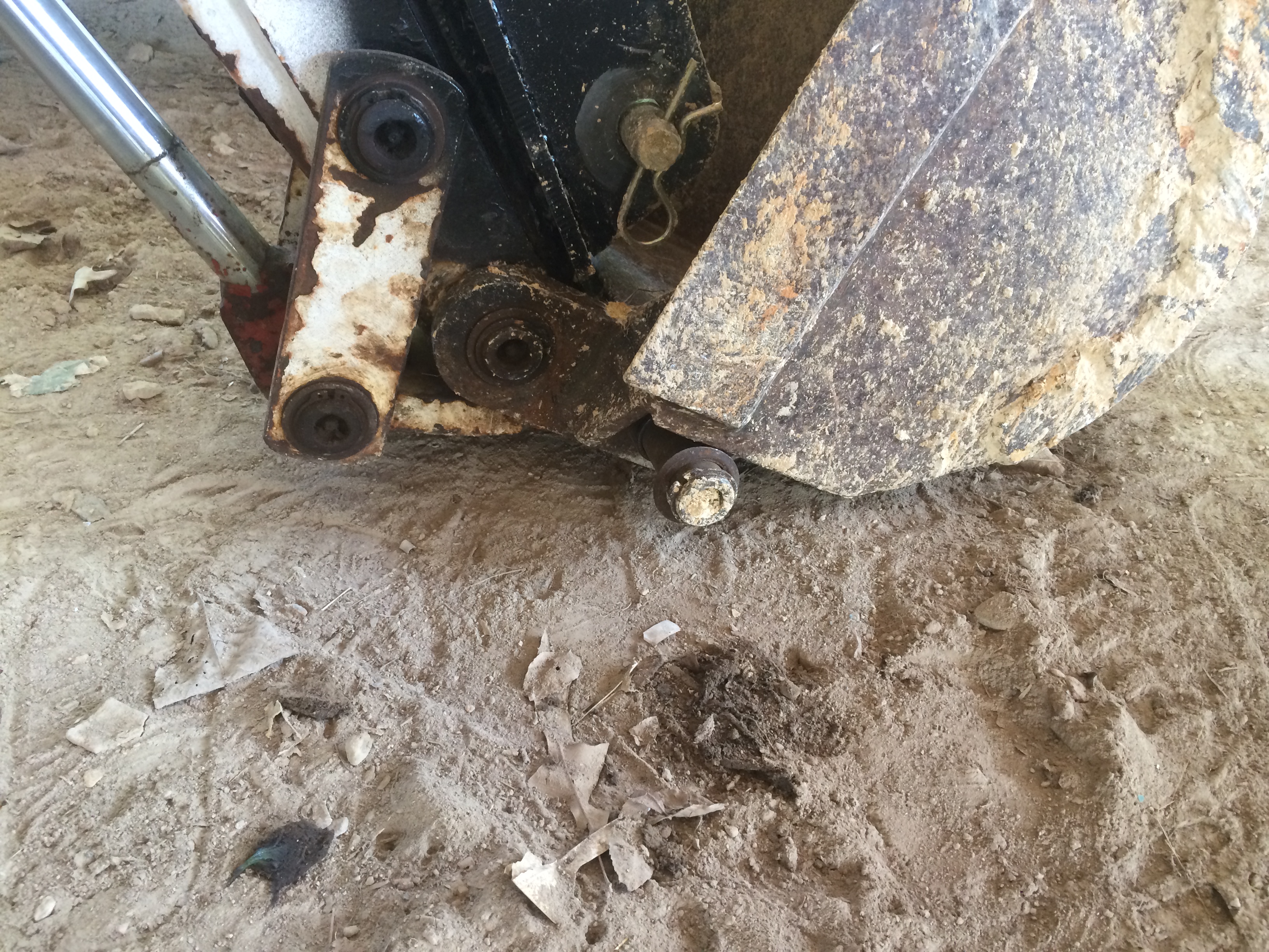

Broke the mini Backhoe
and again
wore the king pin out and man was that a pain to fix
and again
and for the last time these two weeks lol
So... we got big yellar delivered, Didnt break this one at all
I was doing all this backhoe work rolling my fire ash under and under.. It was a lot easier once a 3ft bucket showed up for the task :)

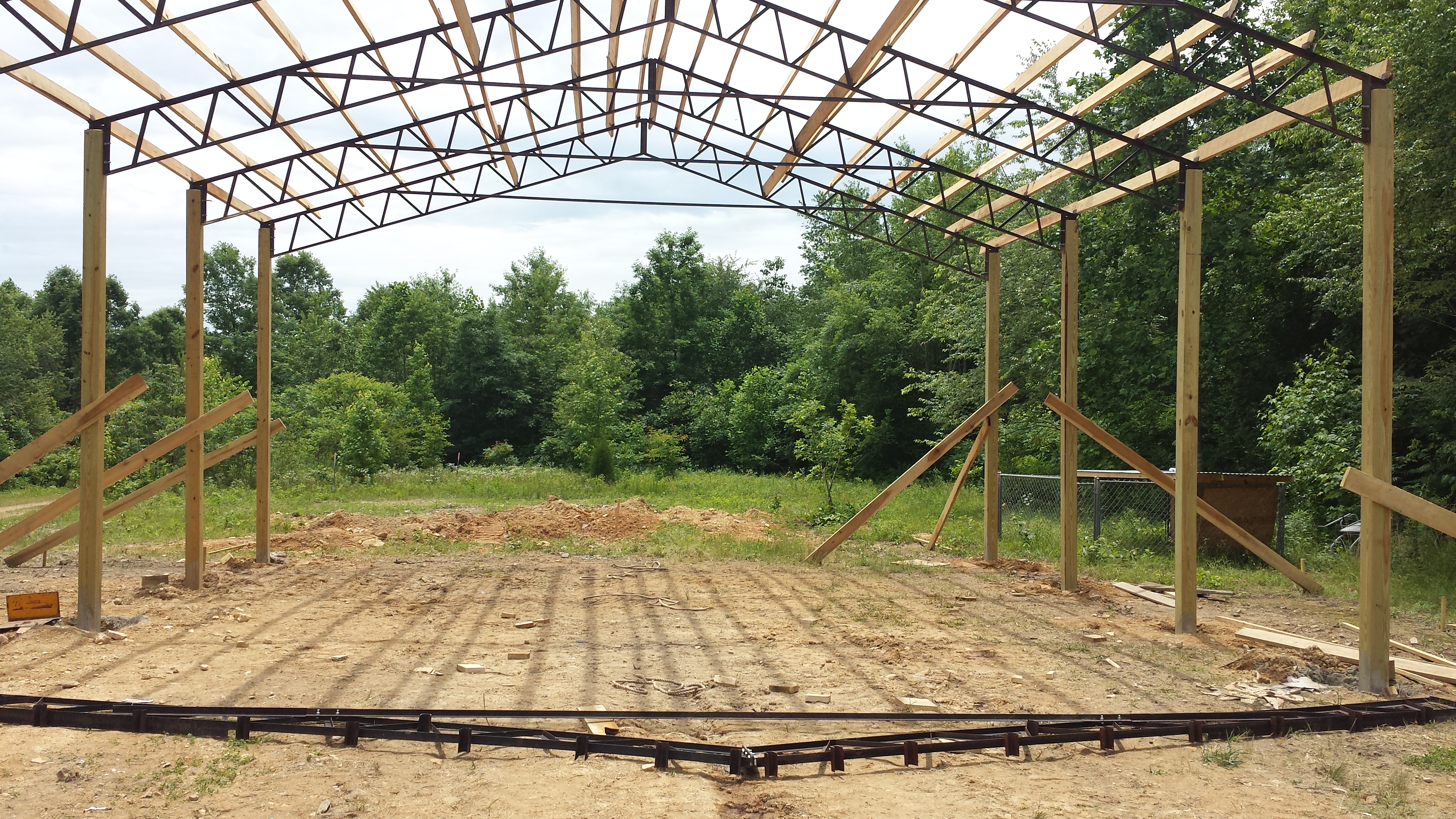

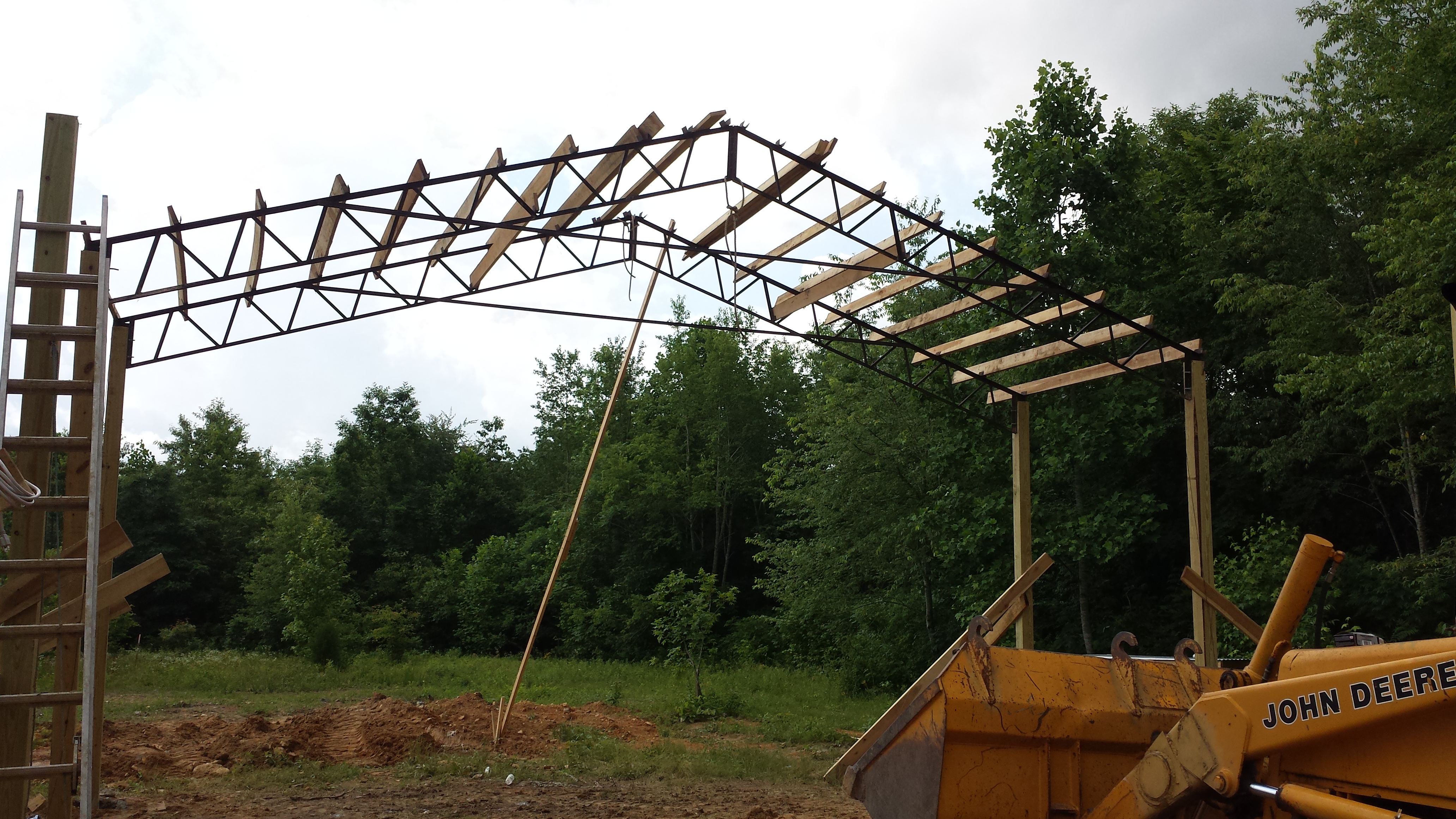

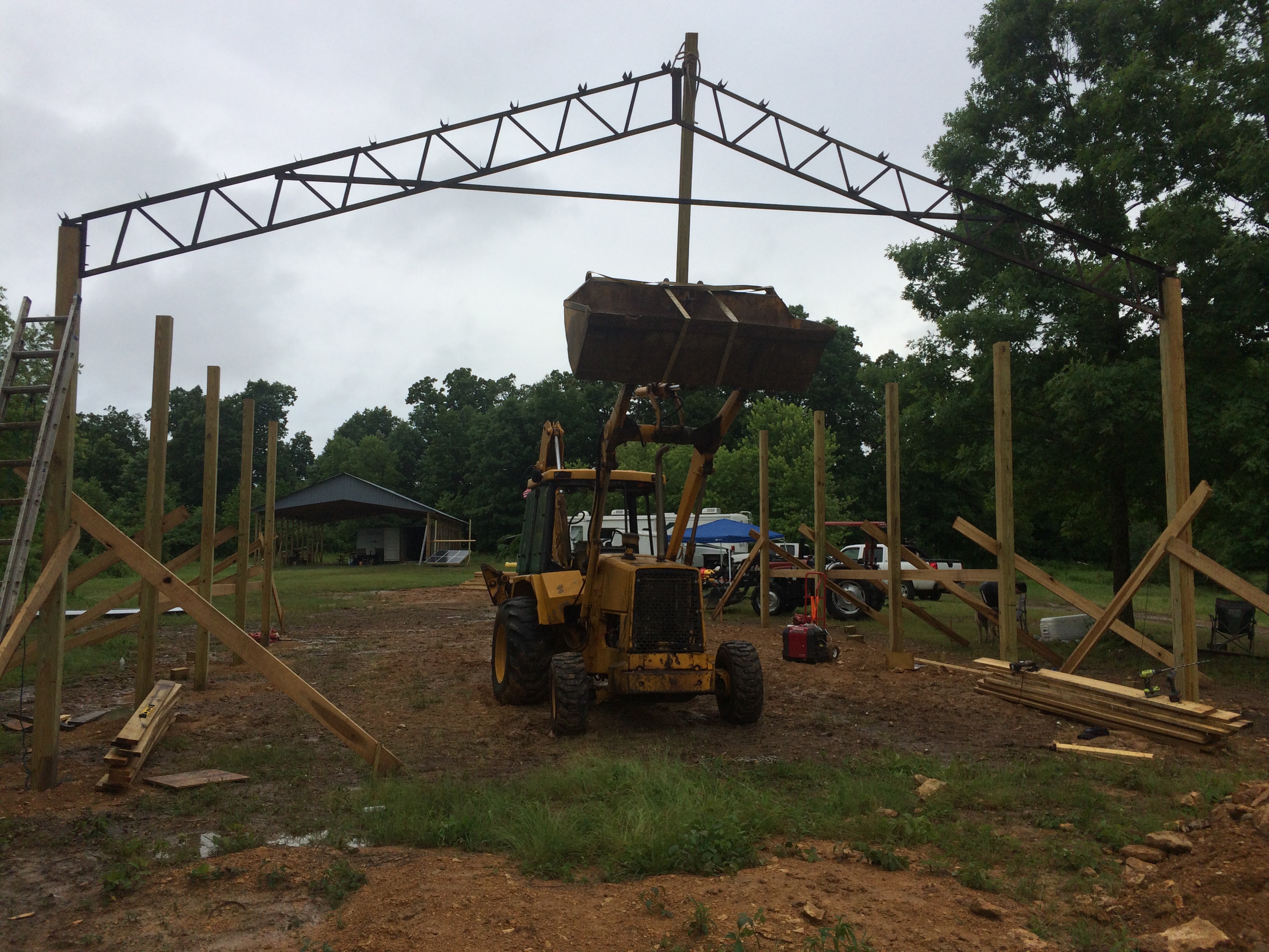

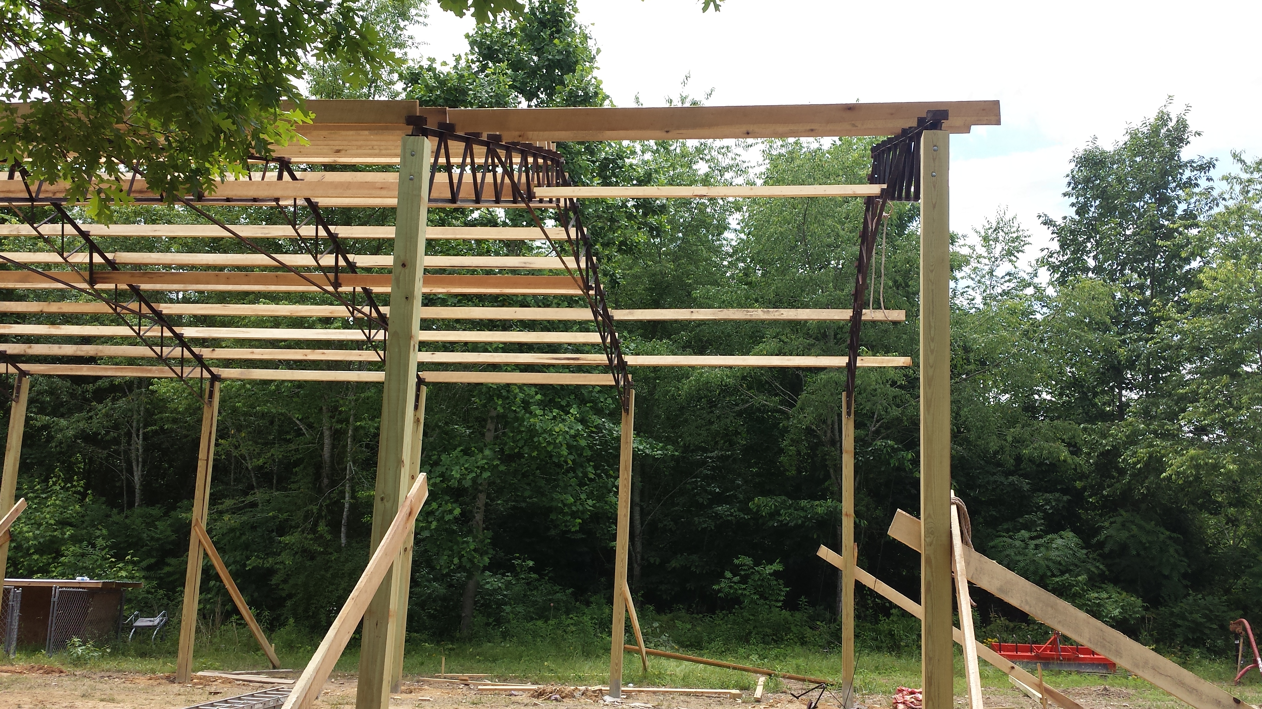

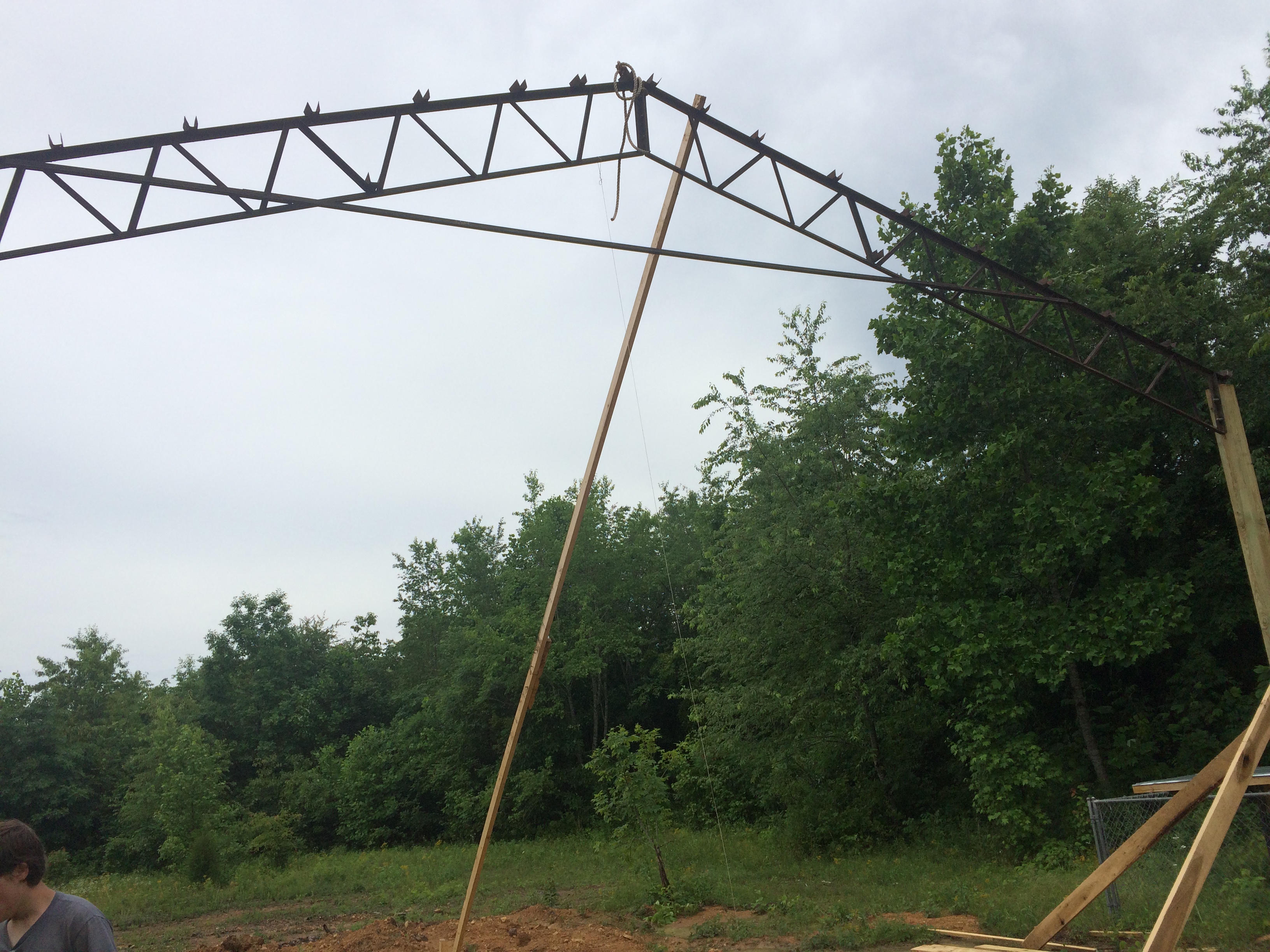

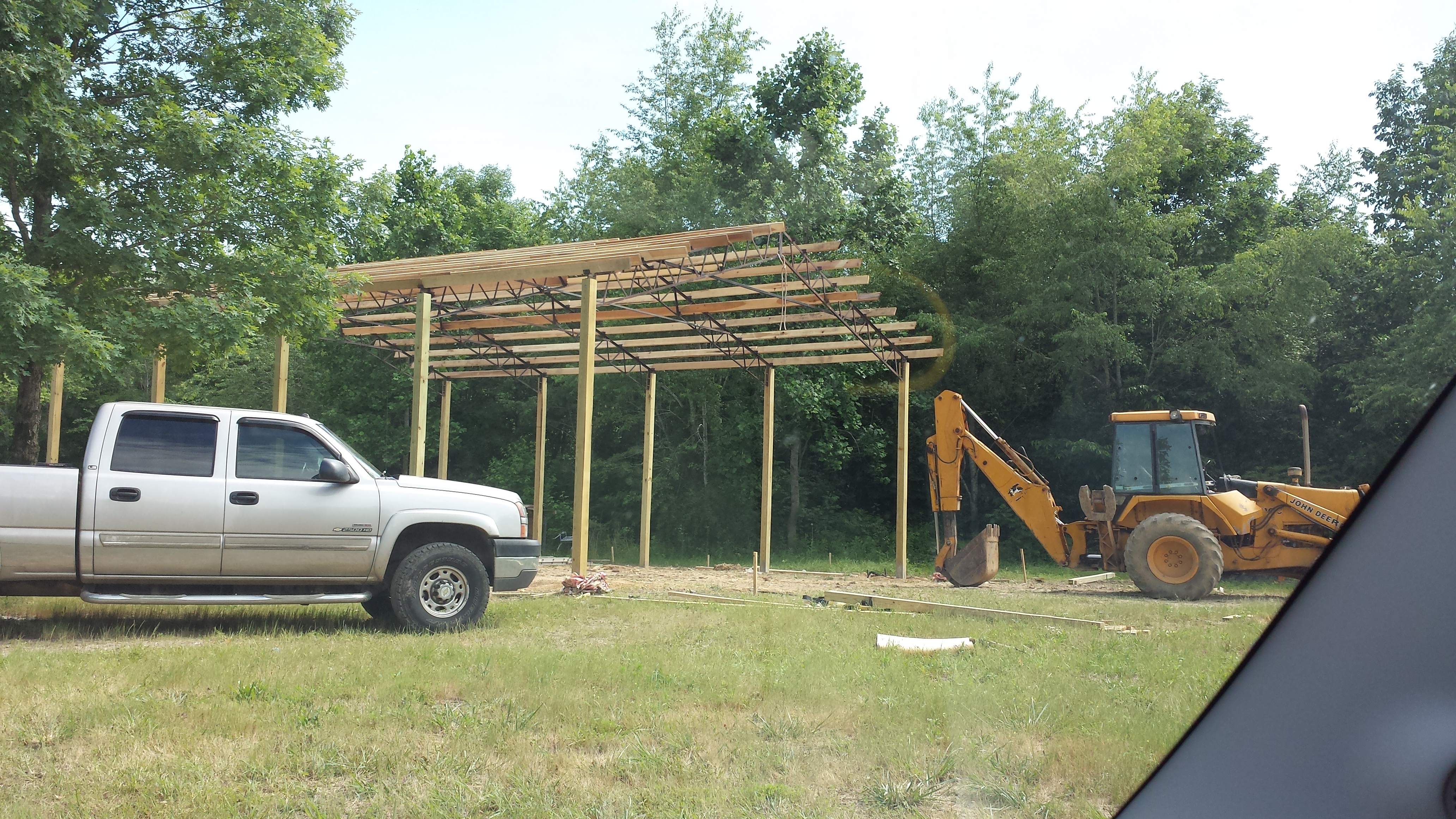

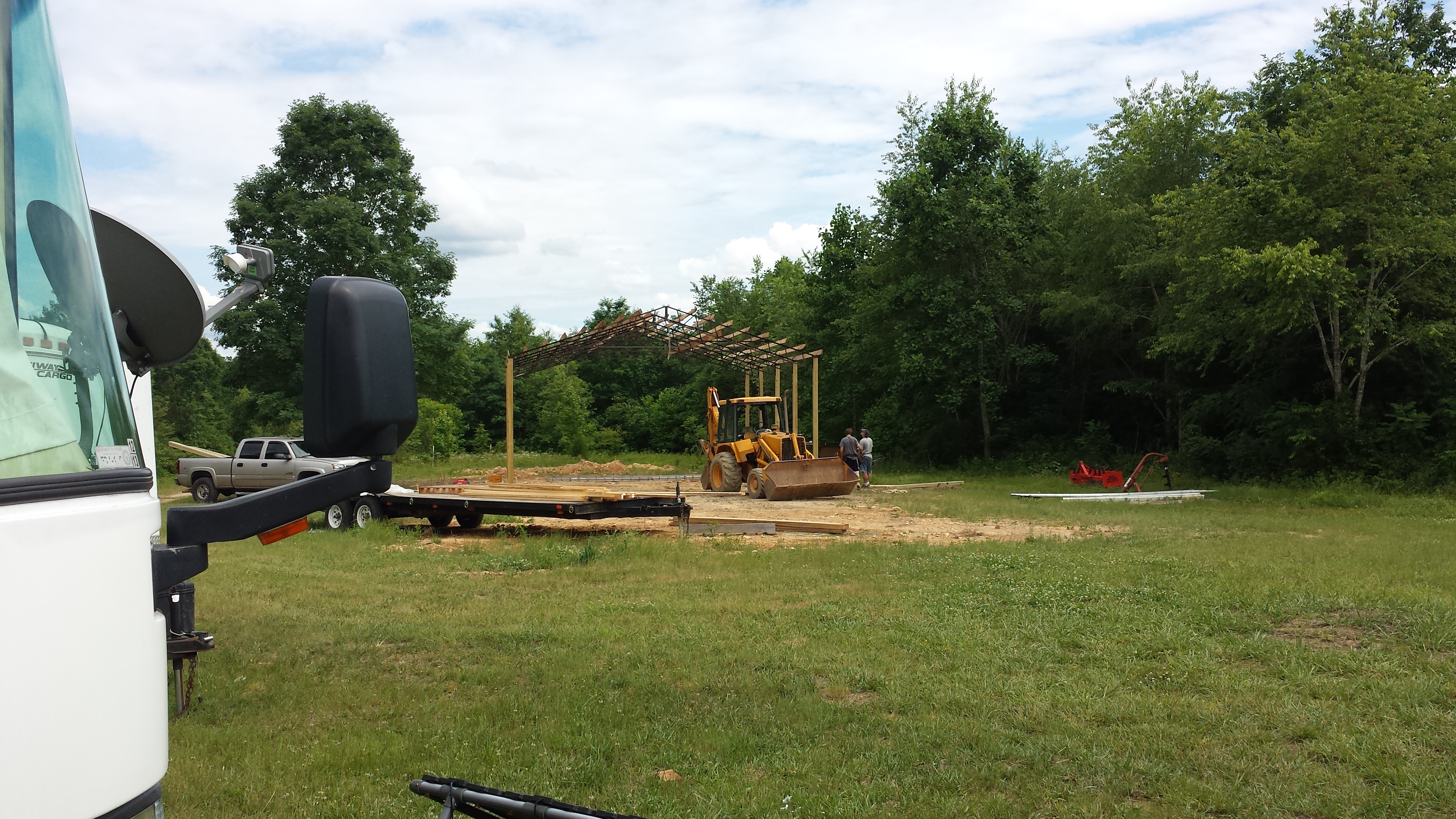

Well, I ended up getting a good deal on a previously attempted 30x40 pole barn. They guy got it up on the 8X8's but never put the tin on. He cut it back down and I bought the tin and the trusses for 900.

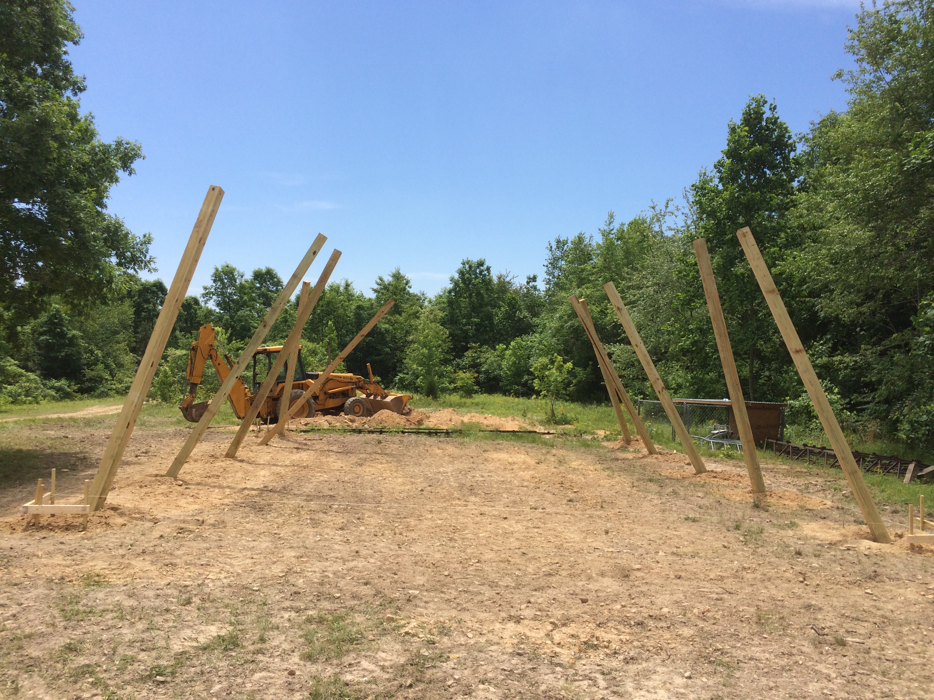

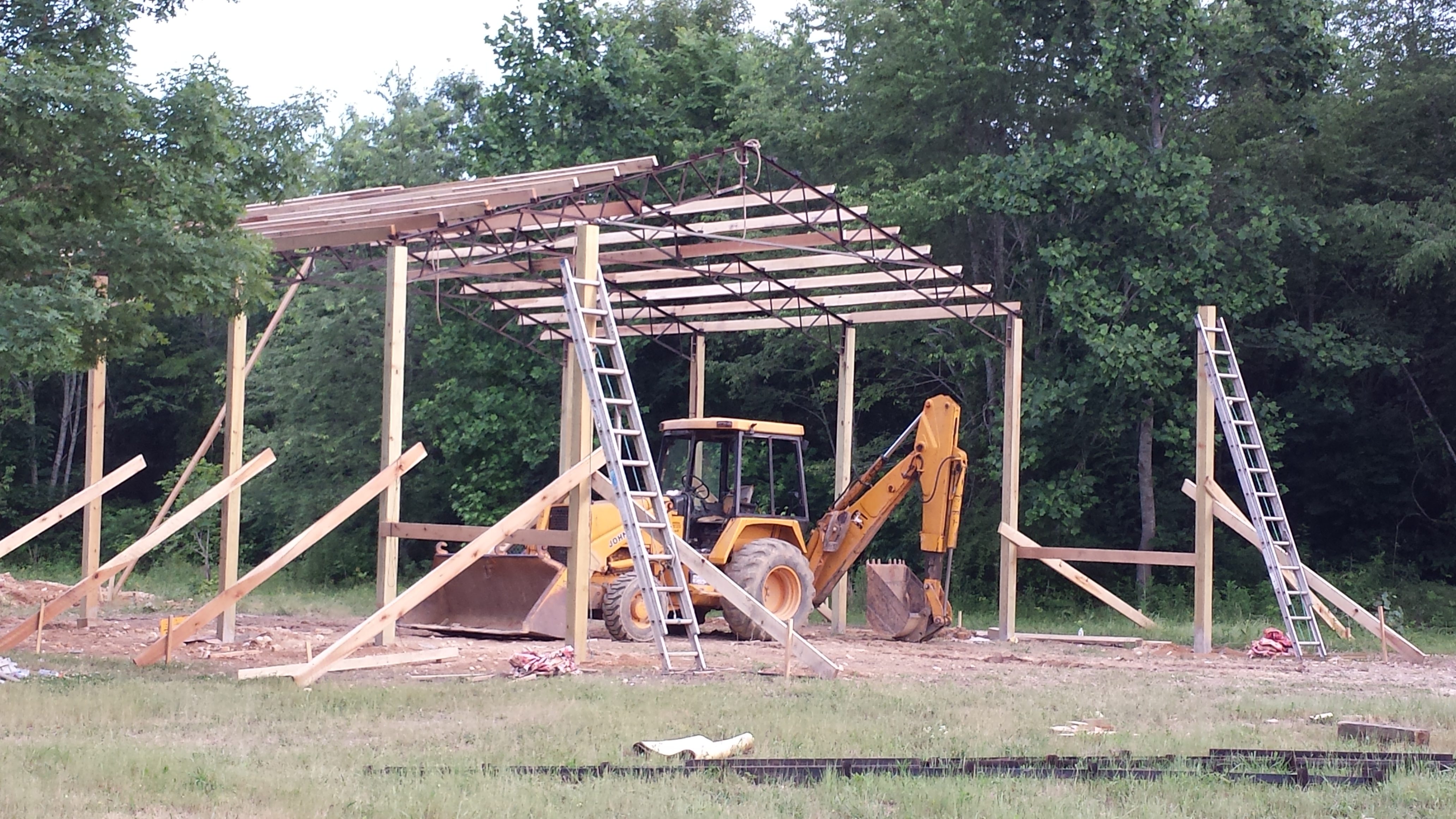

I went and bought a few bolts and the 8x8's and started digging, putting up the posts, squaring things off and leveling the roof. (Something that would have been much easier if I had leveled the ground first :)). We used old yellar extensively in the build

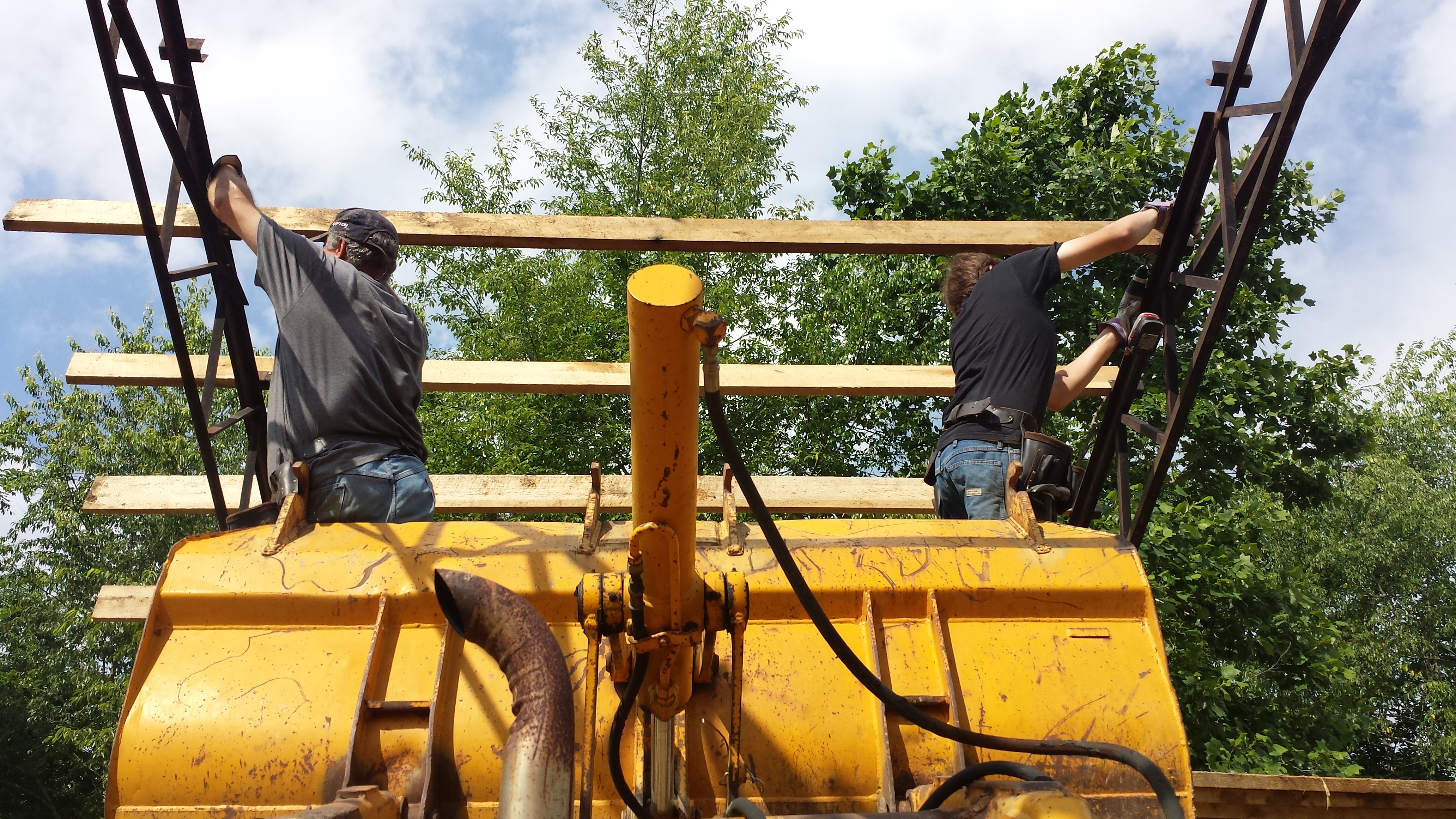

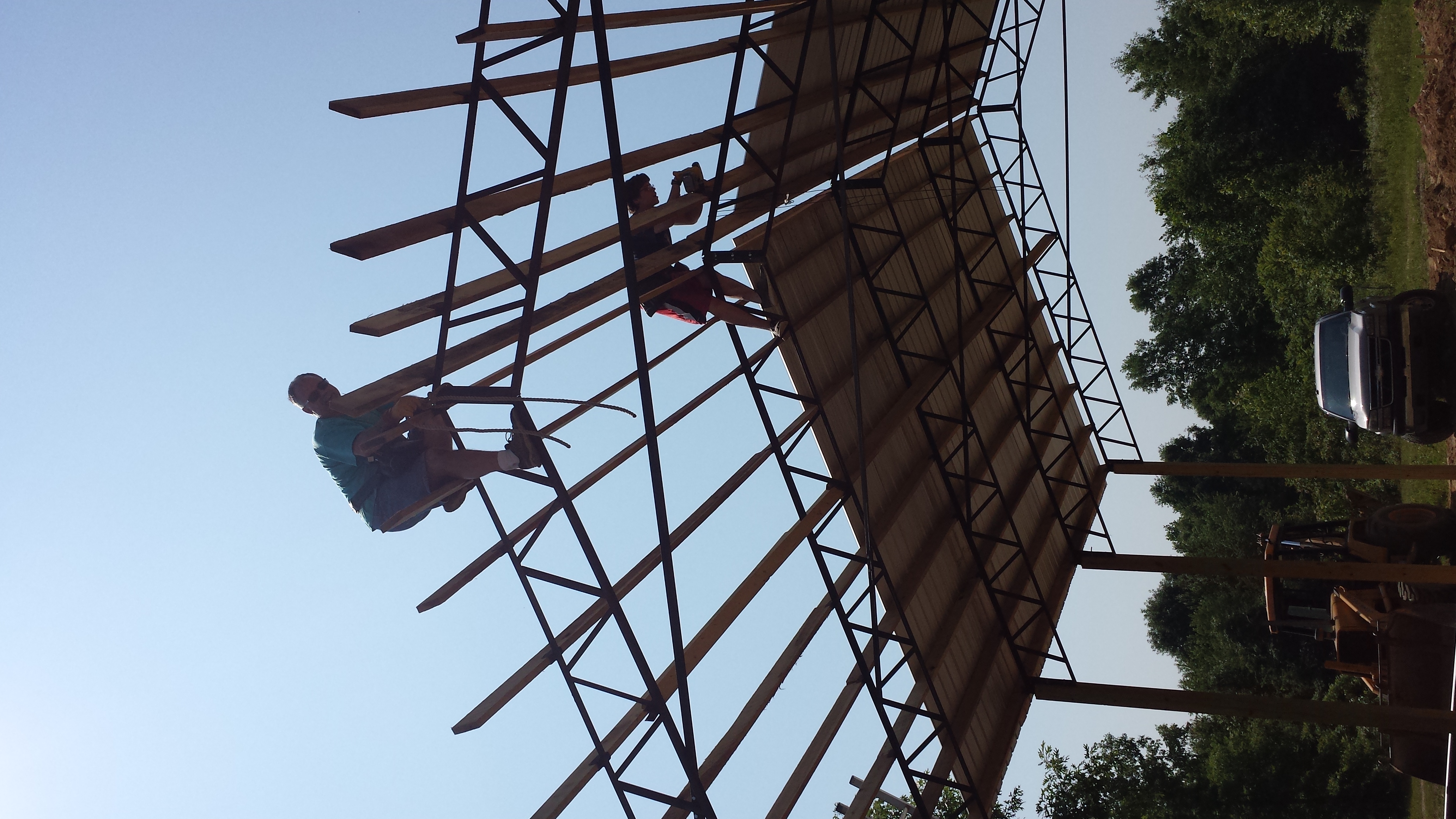

These werent your average trusses and were too heavy for a couple of people to walk up ladders and place on top so we made a fixture for ol yellar and lifted them with that
Our property is near Amish country so I ordered up all the 2x6 perlins from one of the rough cut mills around the area.. it was quite a bit cheaper than dimensional lumber from the box store and a whole lot better quality. We started adding perlins as soon as we could to ensure each truss held the other up. My not so amused wife was the bucket operator for us in ol yellar.

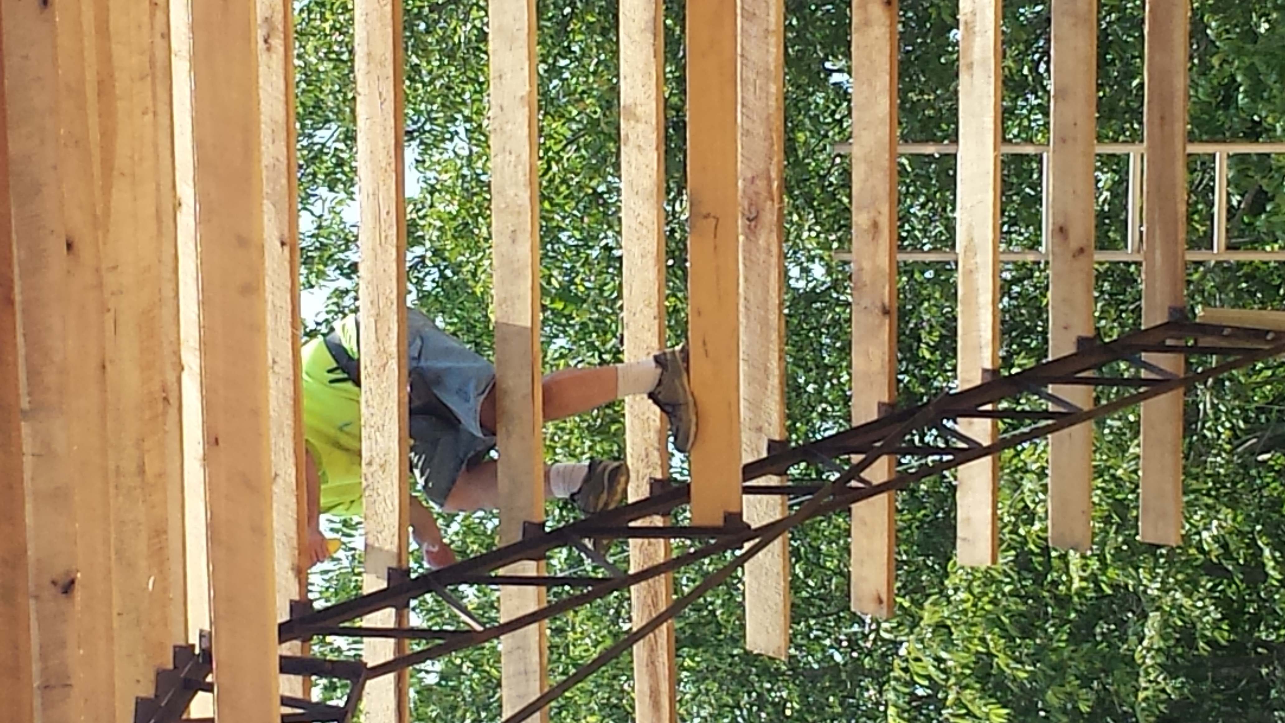

One more to go.. My son was wore out after two weekends of us trying to get to this point. ( A picture of me would show a whole new level of wore out lol)
Last one up and secured... Time to clean up and go home for the weekend. I should have mentioned my son was stone afraid of heights before this build.. He voluntarily used this opportunity to overcome that fear. He still inst a dare devil but no longer afraid to get to the top of a ladder.
Screw check, removing lift lines, and we made shade under it. All in all a good day.. I wont mention how many unnecessary holes we made in the roof missing the perlins but it was less than a half a tube of silicone to fix. I used clear silicone so I could remember them well when it was bright outside :)
