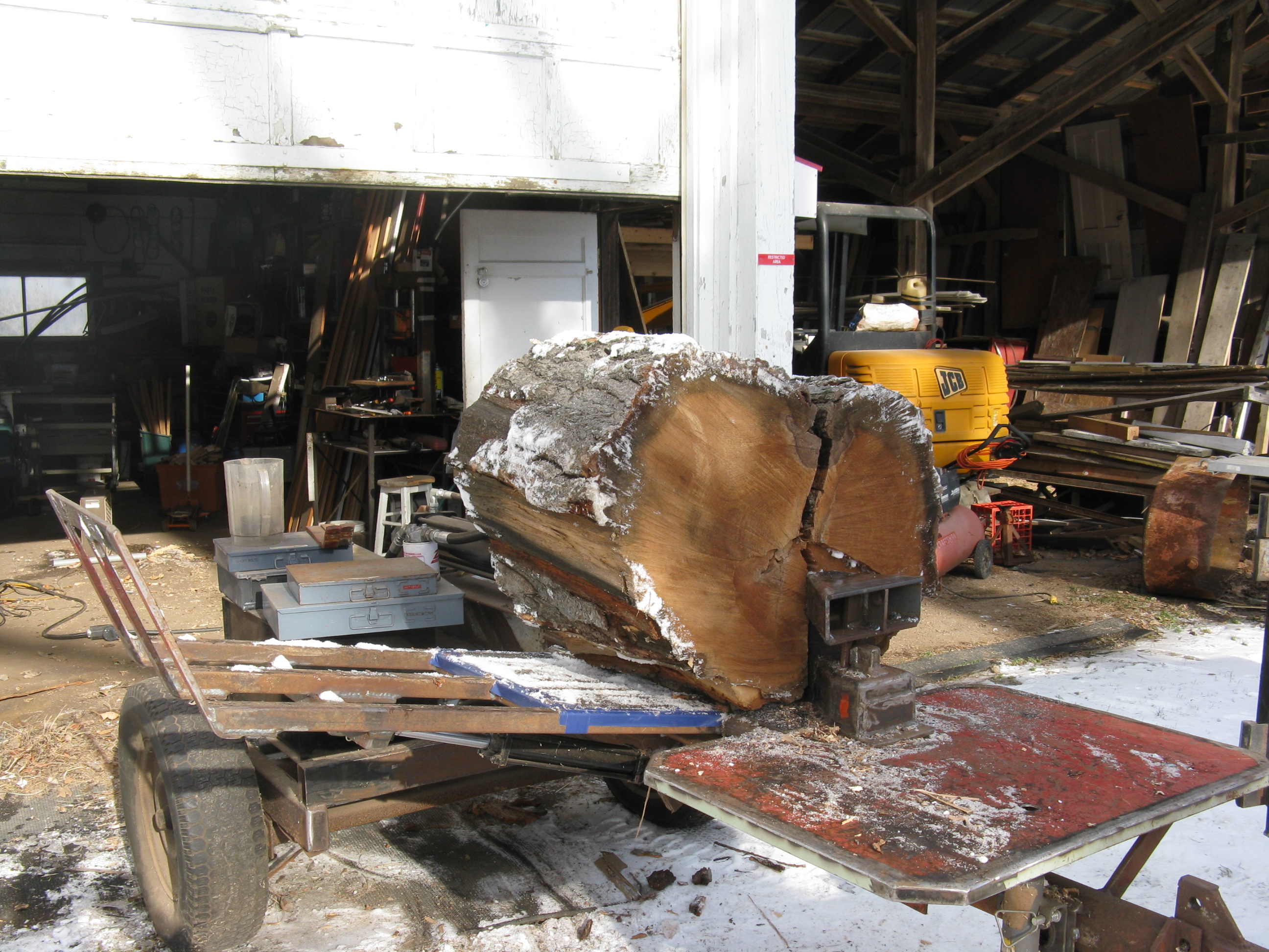

I just played with some numbers.....boy you are right on the cusp. Just barley not working.
You know how an over center latch works....like skid loader quick attach pins......that's sorta what you got going on when you lower the lift. It's almost cam-locking itself into place in which no amount of force will lift.
Assuming AC is 25", BC (cylinder) is 19"....simply lowering the cylinder base mount by 1" has a huge impact.
With AB at 7"....you now have a 9.5* angle. Which yields 16% power. Using a nice round 14k @ 2000 psi.....that 16% gives you a lift force of 2240#.
Account for the leverage aspect....25"/34.5"... you have about 72% of that 2240# available at the center of where a round would be....or about 1600#. Less any dead weight of course.
Drop the pivot another inch....down to 8" and you are now in a 14* angle, with 24% power avaliable to lift. Accounting to the 72% leverage effect....you can lift 2400# at log cl.
It seems you didn't miss the geometry my much at all. Moving that pivot away from the table for clearance....made that cylinder way too close to parallel with the AC line. Like I said....you "just" missed it. But shouldn't be a terrible fix at all.
If you are handy with trig (sin,cos,tan) look up law of cosines......you can easily follow what I did. Only other formula required is the formula for a cylinder on an angle. And that's simple cylinder force x sin(angle)

I would change the log lift design to one long side, one angle and the base. I think that would give you a better push angle for the log lift.
View attachment 479290 View attachment 479291
The one long side works well to stage smaller rounds to be split.
Probably would have been the better way to go, all things considered (like those hinges ... :thumbsup:)

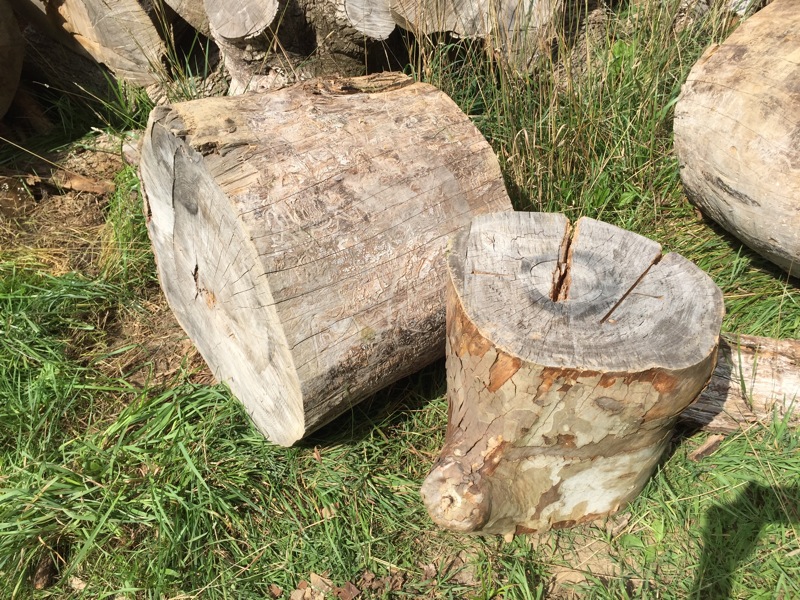

These were the two logs I tried last night.
The one on the left (that I couldn't lift) is what I think is ash ... notice how the cracks along it's length are straight, as opposed to the smaller sycamore on the right where the cracks spiral:
The (longest) diameter dimensions were 31" for the ash, 19" for the sycamore.

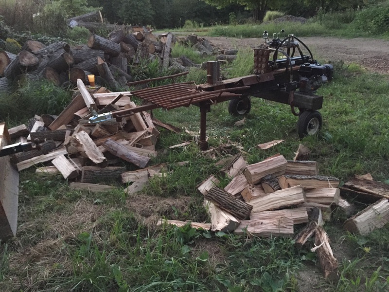

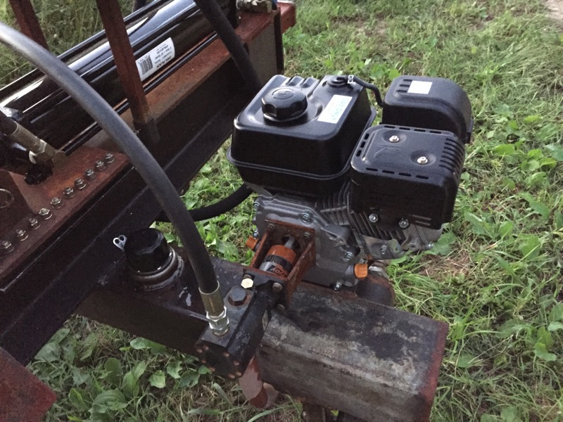

Re-power done:
Everything mated/matched up perfectly. Threw some Permatex anti-seize on the inside of the engine-side Lovejoy coupling, also threw some on the bolts for the pump bracket.
Filled the crankcase up with Castrol straight 30w and filled the tank with gas and a shot of Seafoam.
Engine fired right up ... once I figured out that I had bungied the log lift control valve in "retract" and took that off ... :laughing:
Let it run at 1/3 throttle for several minutes just to make sure nothing sounded weird and then cranked it up and let it run for another few minutes at full throttle. Was pretty surprised at how quiet it is ... seems way quieter than the Briggs Intek that it replaced. Makes me wonder if it is actually running at full rated RPM.
Before I fired it up I ran the adjustment screw for the pump unloader valve all the way in and then backed it out three full turns (I think ... :rolleyes:)
Loaded it by deadheading the log lift valve (Prince RD5200) and checked the relief pressure ... 2000 psi ... and it didn't kill the engine ... although it might have if I had held it there long enough.
Popped the cap on the log lift relief and cranked in the adjustment screw, setting it to 2500 psi by the gauge.
Then threw a piece of that sycamore on the rail and attempted to split it with the 4-way ... no soap ... need to add more of a knife on the edge like LD suggested.
Pulled the 4-way and split the round with the fixed wedge.
After that I took it out and gave it a little workout ... mostly ash and a little oak:
Only thing I noticed is that I probably need to adjust the detent pressure up on the valve for the push block cylinder ... it kept popping the valve out of extend while I was trying to split.
