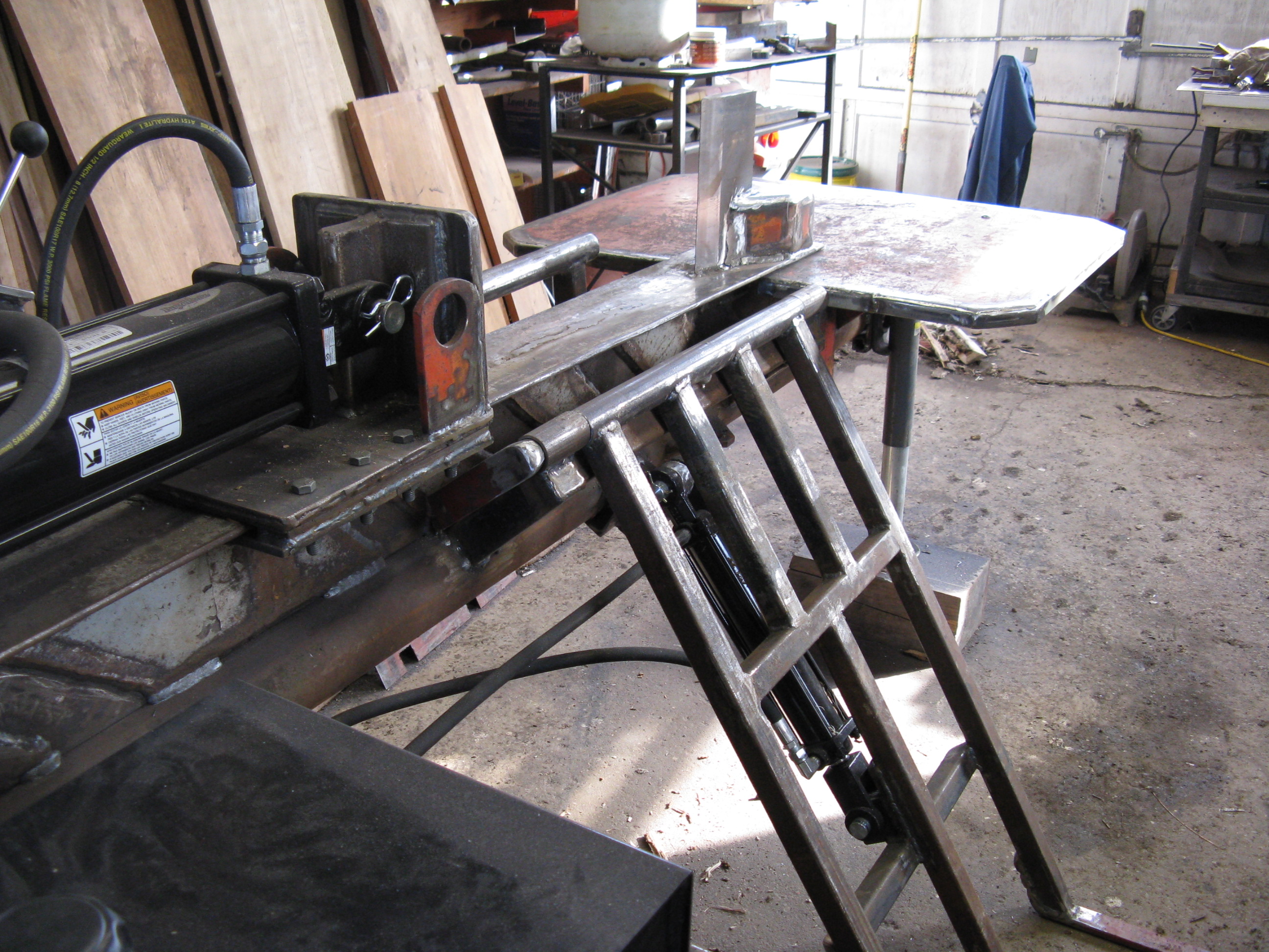

I've been looking at Timberwolf's lift designs ... it looks like they are only using a 2" cylinder ... but the lift is constructed differently (only two panels with one angle - instead of three panels with two angles like I used) ... and the initial starting angle of the cylinder is much greater. But they are rated for up to a 500 lb round.
The extra angle on mine created some problems, in terms of interference with the cylinder, when raised.
A tad over 19" plus a tad under 6" is about 25". The length of the AC side. You are putting alot of force into doing not alot of work. Need more angle difference[/B.
Yup.
I should have put a little more thought into the geometry for the lift. Part of the reason the cylinder got located as it did was ensuring I had clearance with the log lift and the beam. Also the hose routing figured into it as well.
Didn't really figure out effective force being applied which I clearly should have done.
A cylinder on a 2 degree angle only has 3.5% of its force available for the lift. Half that at 1 degree.
So at 2 degrees and 2000psi, you can lift 475# total. Take the weight of the lift of....and you have very little capacity.
Yeah ... the lift probably weighs 75 lbs anyways ... mebbe more ...
And that means the other 13000 pounds of force from the cylinder is trying to push itself apart, as it did
Lemme tell ya, when it popped it got my attention ... :laughing:

... your lifting arm, remember the friction you need to overcome on the start of the lift, if you just rely on pins and holes, this can be very high, even a well greased bushing will make a big difference,
Good point :thumbsup:
and as for the weld breaking, from your picture it looks like a bad weld, no penetration on the solid, grind it out re-weld it and stick a fillet on for good measure, keep on building
Yup ... will grind it out, bevel/fillet it and turn up the juice. Will also gusset it.

Rswyan: how hard would it be to lower the cylinder base pivot 4-6"? That should help with the angle.
You have plenty of cylinder, just have to get the geometry right
Yup.
It wouldn't be all that hard ... just need some 1" x 3" bar stock to make the attachment point.

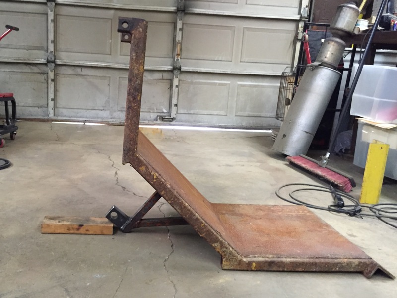

Side profile of the log lift, show the relation of the hinge pins and rod end cylinder attachment point:
I would change the log lift design to one long side, one angle and the base. I think that would give you a better push angle for the log lift.
The one long side works well to stage smaller rounds to be split.
