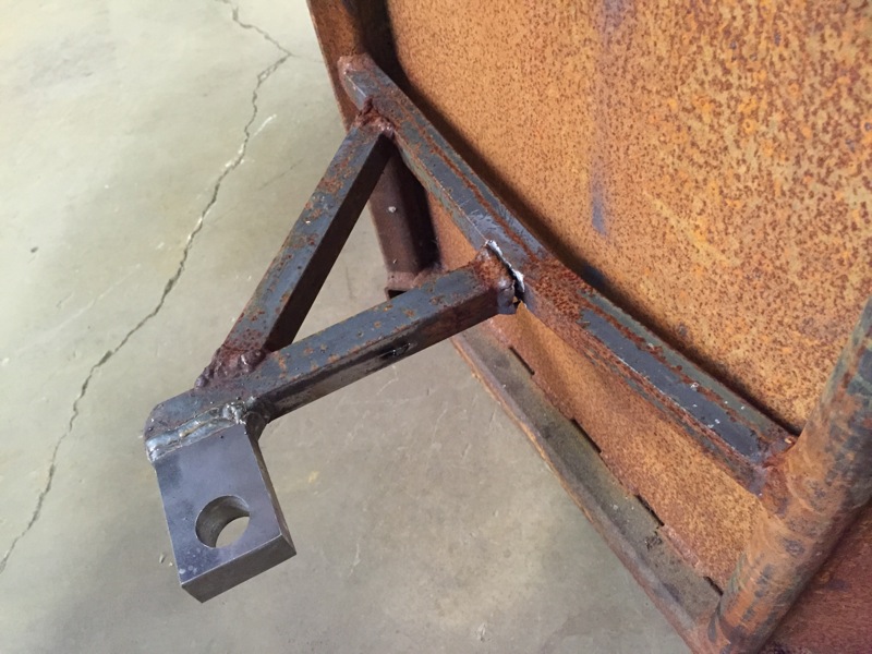

The cylinder did have enough power however to snap the welds on one of the pieces of 1" solid square bar stock that I used to build the brackets on the log lift for the attachment of rod end of the cylinder, after repeated attempts to lift the round. Probably need some gusseting.

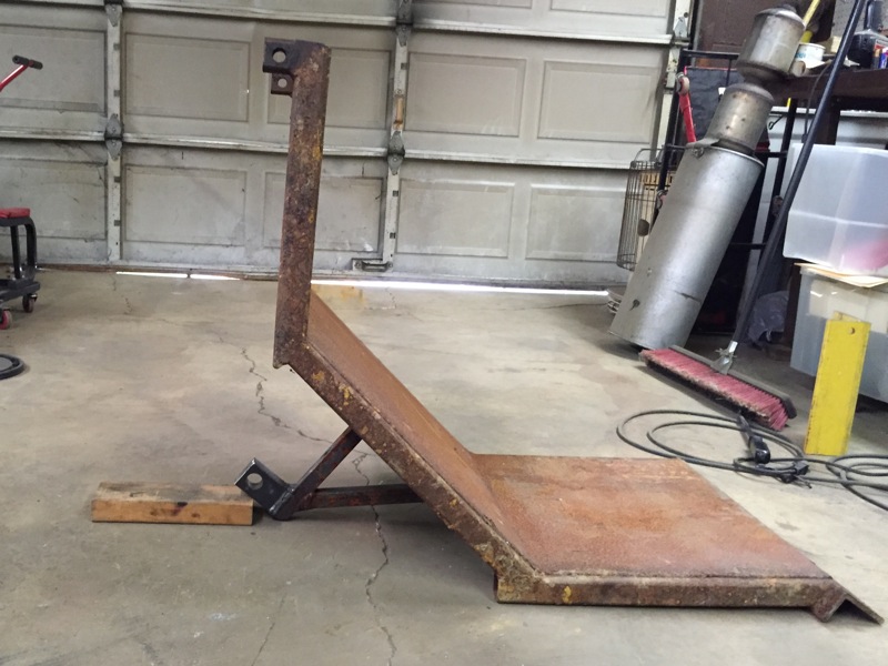

I think part of the problem is the initial angle of the cylinder lacking enough mechanical advantage to get started.

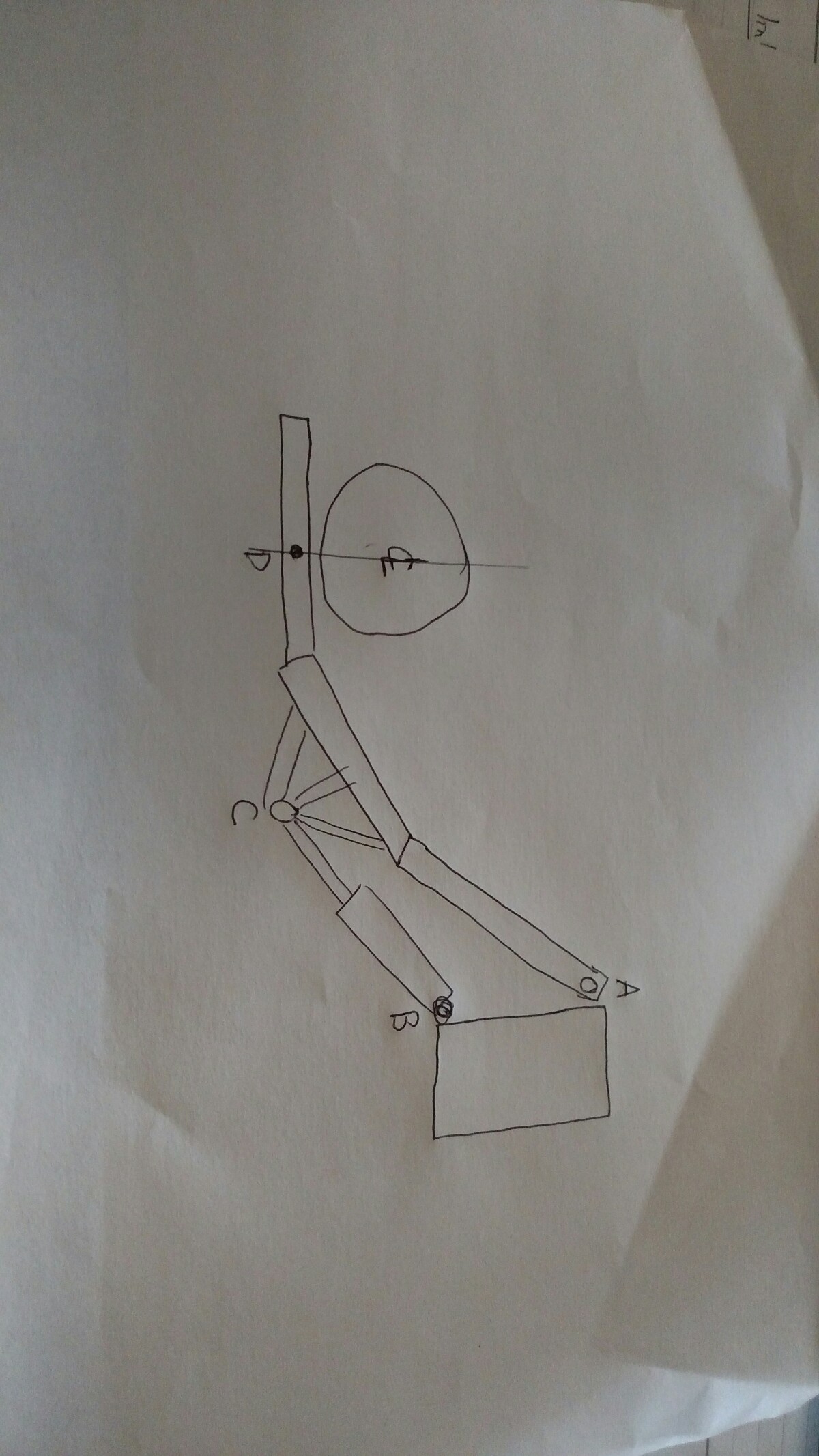

Got any specs on the log lift, or some measurements, And I can figure out what your theoretical lift cap should be? Even just a sketched 2-d drawing showing cylinder, lift , and pivots, and I can tell you what numbers I need.
/ Logsplitter 2.0 #314
I found an older picture, assuming it's still the same design, I'm post 272.
Reference this pic
What are the lengths AB, BC, AC, and AD when o. The ground. And what does BC become when raised?
The design of that lift, (similar to a front loader) is such that the lifting force is greatest at the lowest position. And gradually diminishes as it is raised, as angle c becomes less and less. But at some point the round will start rolling toward the splitter, and the load the cylinder needs to lift it also lessens
I can take some pics and include some measurements.
The cylinder for the log lift was almost vertical ... need to get a little more angle on it I think ... but I'll need to relocate the base end attachment point ... :(
/ Logsplitter 2.0 #316
Get them measurements and I can do some numbers and we can go from there.

Here's the measurements:
On the ground:
AB = around 6" ... a whisker under ... mebbe 5 7/8" (log lift hinge pin to cylinder base end attachment point pin)
BC = 18 1/4" (cylinder base end attachment point pin to rod end attachment point pin, retracted)
AC = 25" (log lift hinge pin to cylinder rod end attachment point pin, retracted)
AD = 34 1/2" (log lift hinge pin to center of log lift base panel)
Raised:
BC = 26 1/4" (cylinder base end attachment point pin to rod end attachment point pin, extended)
All measurements involving pins are from the center of the pin.

Broken weld:

Side profile of the log lift, show the relation of the hinge pins and rod end cylinder attachment point:
