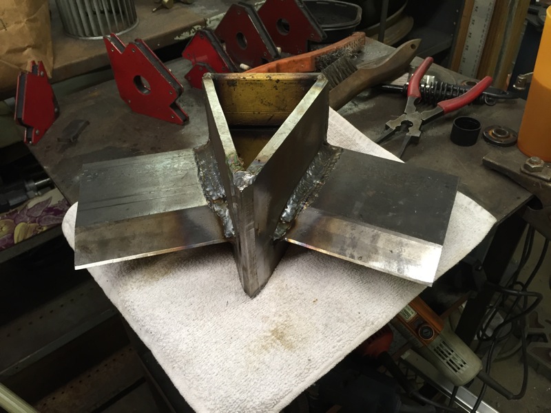

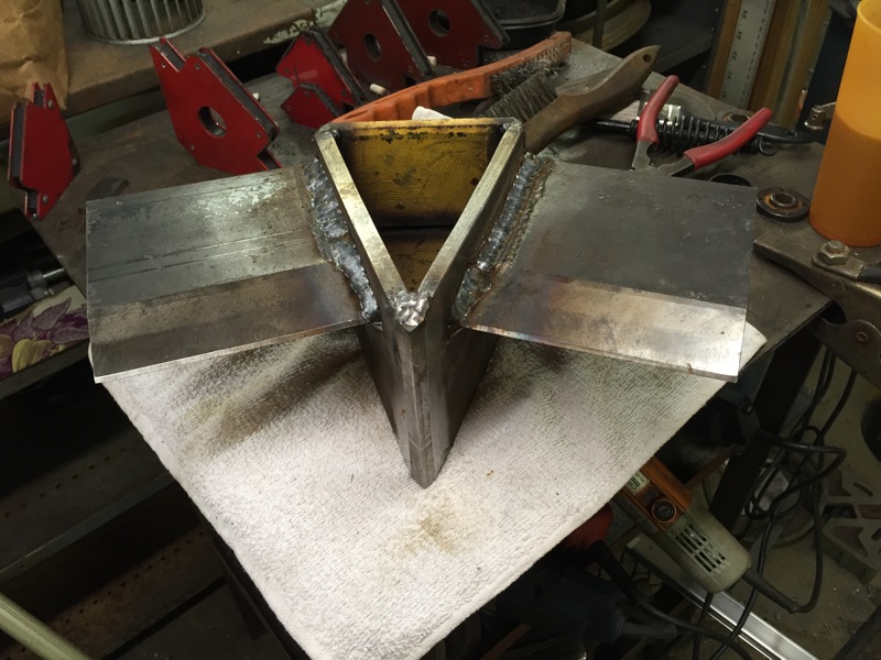

A couple of the 4-way wedge, with it flipped both ways.
Low:
High:
Could probably stand to have a little more taper out on the vertical knife edge.

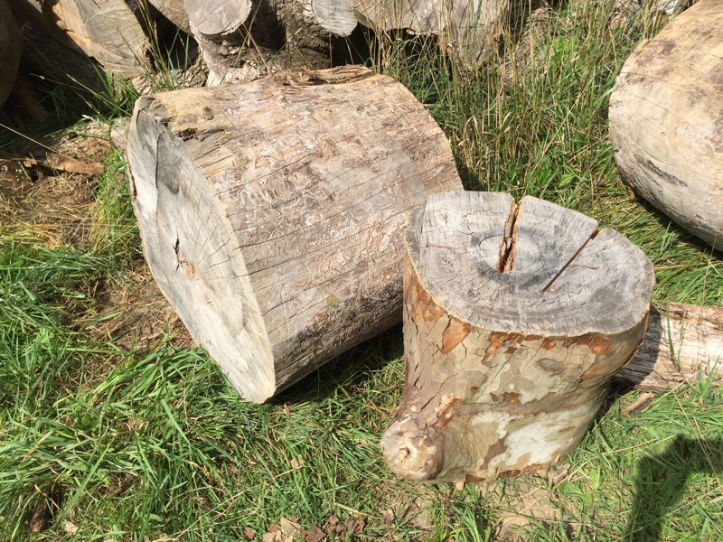

These were the two logs I tried last night.
The one on the left (that I couldn't lift) is what I think is ash ... notice how the cracks along it's length are straight, as opposed to the smaller sycamore on the right where the cracks spiral:
The (longest) diameter dimensions were 31" for the ash, 19" for the sycamore.

I think you need to add a piece of the thinner flat material in front of your wedge. To help it get started before it widens. Like a few inches of knife edge to penetrate first.....then the main show.
