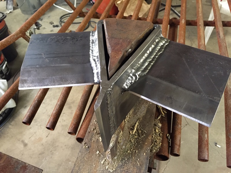

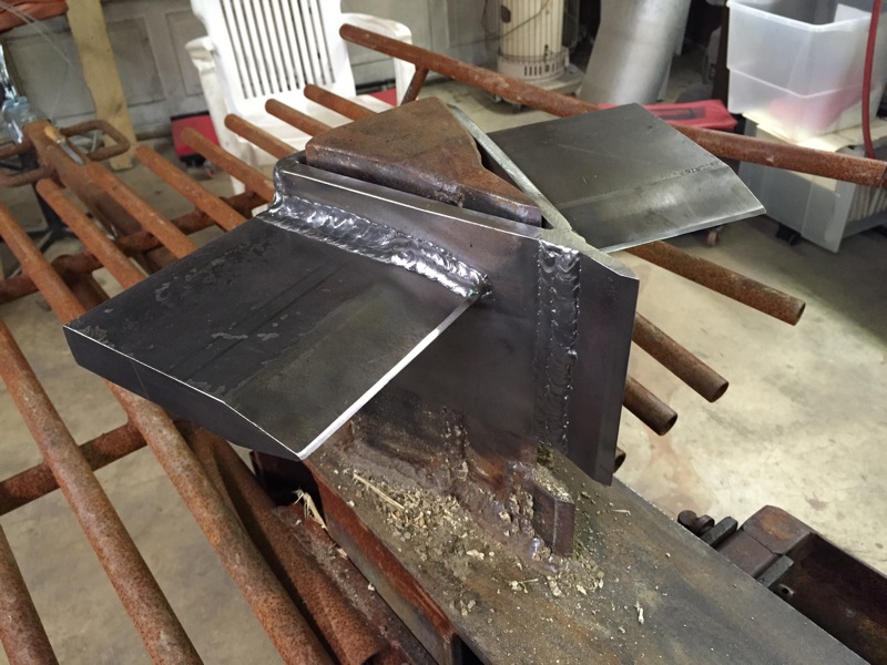

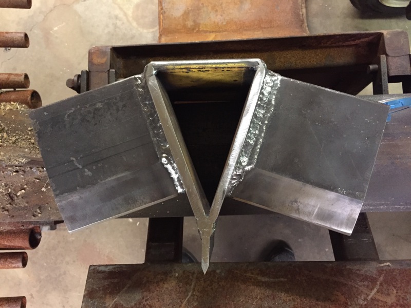

Added a thinner knife edge on the 4-way wedge yesterday to see if that helps getting it to piece the rounds a little better.
Used a piece of 5/16" plate about 1 1/2" wide ... which leaves an opening of just under 23 1/2" inches between the 4-way and the push block:

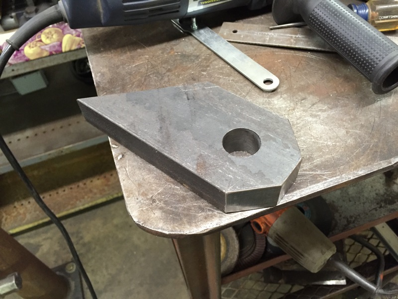

Also got the attachment bracket for the base end of the hydraulic cylinder for the log lift cut out and drilled. Made it @ 45 degrees, thinking that there would more weld length to secure it to the beam.
Still need to put some bevels on it before I weld it on:
This will relocate the base end attachment point down, and in, approximately 3 1/2 inches, and will give the log lift cylinder an initial angle of better than 20 degrees.
The bracket for the rod of the cylinder is also being located a little lower and further out on the log lift.
