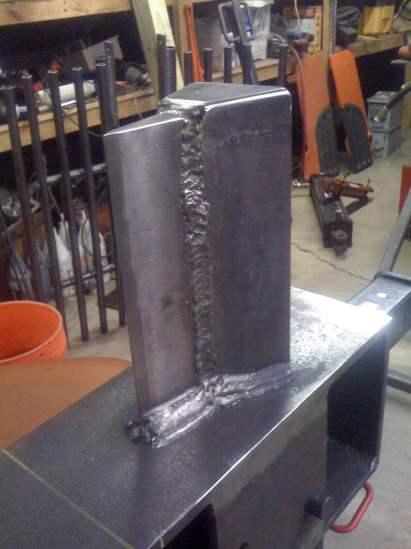

Sliced, diced, and tacked:
I must be livin' right :rolleyes: ... or something ... the two pieces of 1 1/2 square tube that I added in the middle ?
They were sitting on the shelf ... right length, right cuts/angles ... didn't have to do a thing to 'em, other than grind a bevel where I was going to weld them together ...
And it's actually pretty straight ... :thumbsup:
