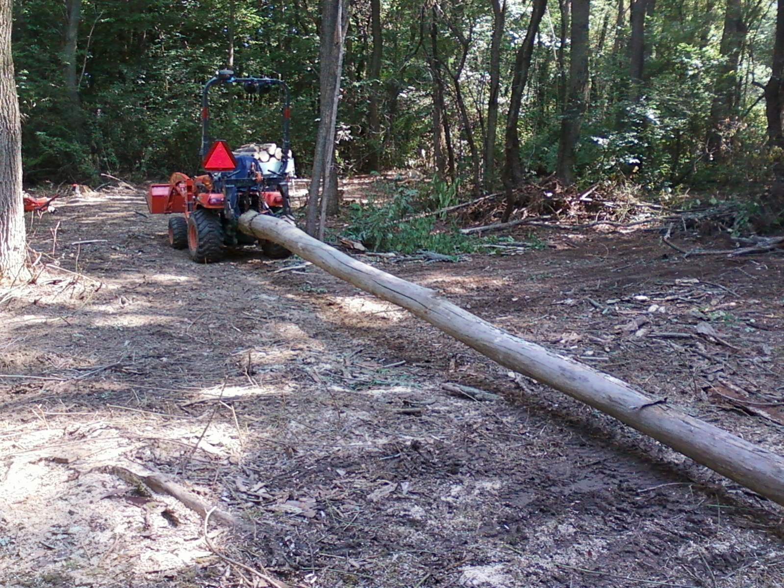

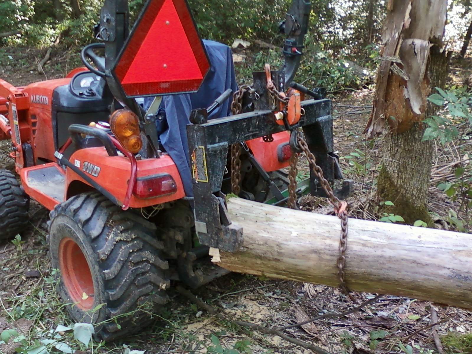

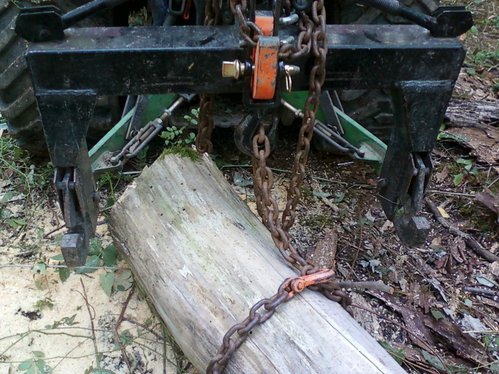

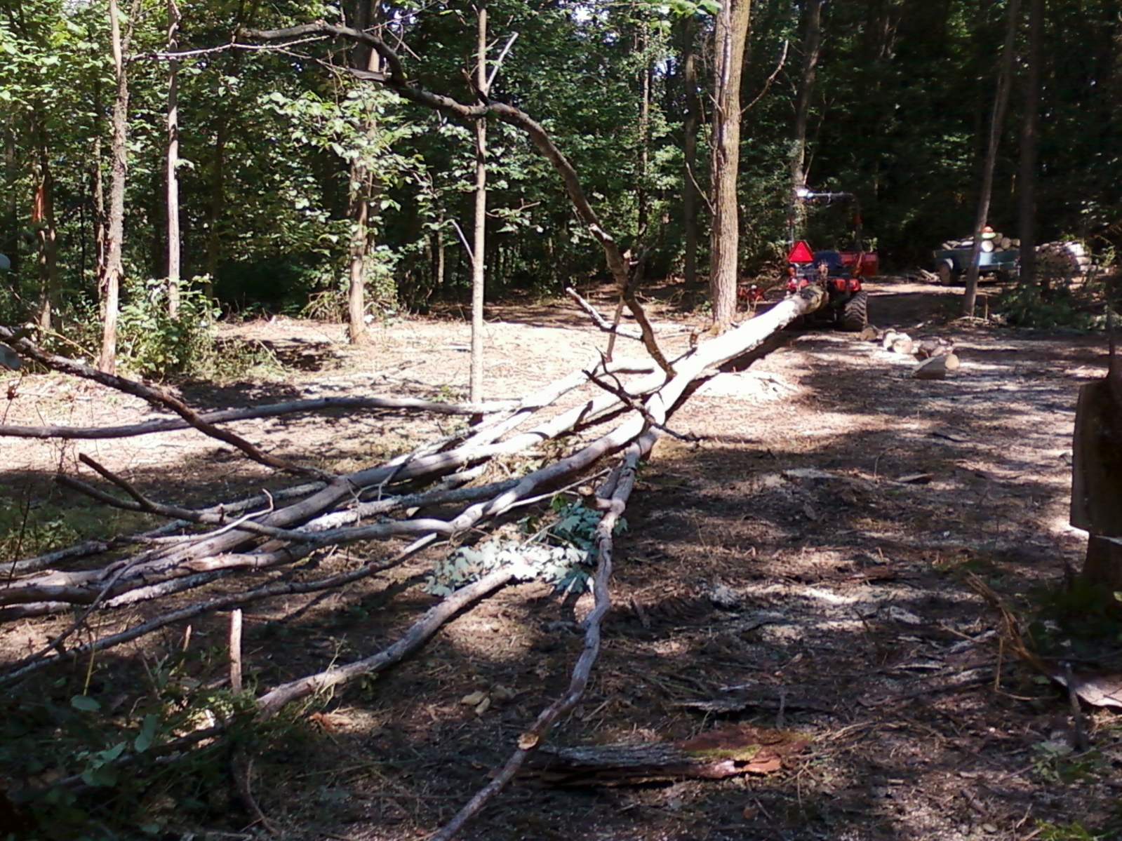

I've taken to using my Harbor Freight quick-hitch as a poor man's skidding arch.
I use a snatch hook that you can get from either Harbor Freight or Tractor Supply and hang it from the top hook on the hitch. I think that the attached photos speak for themselves.
Yes, you do have to be careful to prevent the butt of the tree from smashing into your PTO shield or the like. I just try to keep the chain close to the end and lower the butt if it starts to get too "intimate" for my liking.
Lifting the butt of the tree makes it a lot easier to move by reducing the drag and adding rear weight for traction. The first tree was a toothpick by weight compared to the second one. You really can move a lot with a SCUT as long as you have traction!

I have a Kioti CK30 another thing you can do is loop the chain around the drawbar looped around the log at the butt. just one big loop. The another loop on the hitch around the log. when you lift the hitch the first loop stops the butt from coming up and the rest of the log is lifted ready to be cut. I do not have pictures but will take some tomorrow to show you.

Careful putting too much weight on that Harbor Freight quick hitch. You can bend the arms in if you overload it. Don't ask me how I know.
/ Log/tree skidding with your quick-hitch #17
I had wondered about that ... can you give us some details? Like what implement (if that is how it happened) and conditions. Just curious - I'm planning to build a skidder attachment out of mine. I'm mostly concerned with it's ability to take the load of the log when it moves forward against the back of the hitch, where I intend to weld in a plate and some tube. Trying to figure out how much bracing to add.
/ Log/tree skidding with your quick-hitch #18
After hurricane Gustav I was moving a large green oak log, and got the bright idea of picking the front of the log up enough with my quick hitch to skid it to where I wanted it. I passed the chain around the end of the log and attached it around the lower hooks on my quick hitch. The 3 point hitch lifted the front of the log and I was able to move it slowly but when I unhooked the chain I realized that the weight had bent the lower hooks on the quick hitch in towards each other! Not the hitch's fault, it simply was not designed for that type of load.

I can see that in my mind's eye. I hook the chain to the top hook so that the butt is suspended above and between the two lower hooks. Working the log like this reduces the strain on the QH, and gets better ground clearance for the butt of the tree.
Pretty amazing what a small tractor can move when you use your head:thumbsup:
