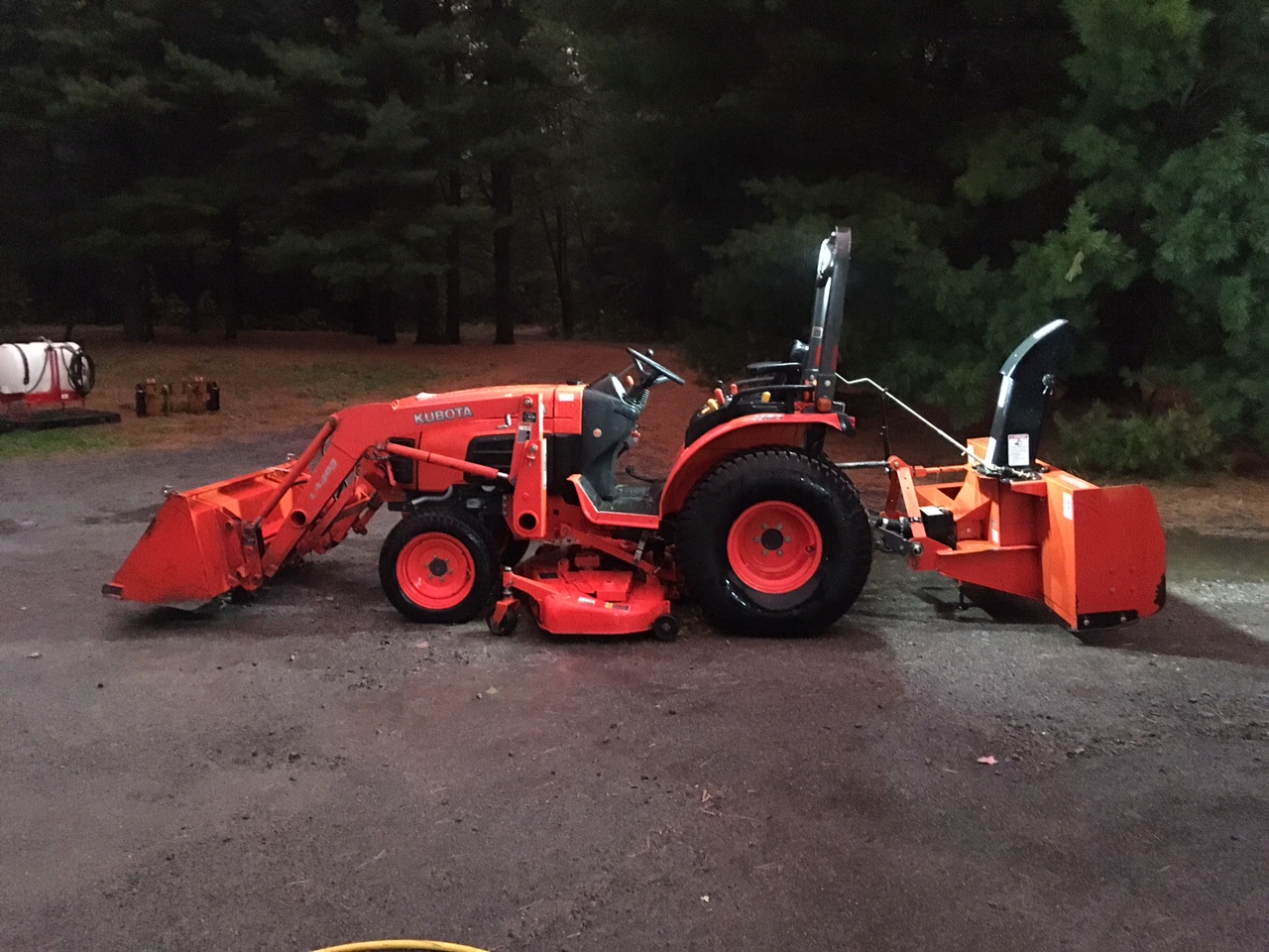

Hey All,
First time poster. I am in need of a log splitter and the last thing I want to do is have another small engine to replace. Was thinking about adding remotes to the tractor and buying a hydraulic one. I've be reading and it appears as though I can expect a longer stroke time due to the 5.6gpm coming out the rear, is this going to be very noticeable or should I be ok?
The other question is if we decide its going to be ok, I plan on getting the Kubota remote package. I've seen some conversation around floating valves yea or neh but I am slightly confused. When adding remotes isn't it just the valve that is already on the log splitter that does the work? I do plan on adding one of the factory levers so I can see that I probably want the float for one of them but with regards to the log splitter shouldn't it be fine with a float?
Thanks in advance

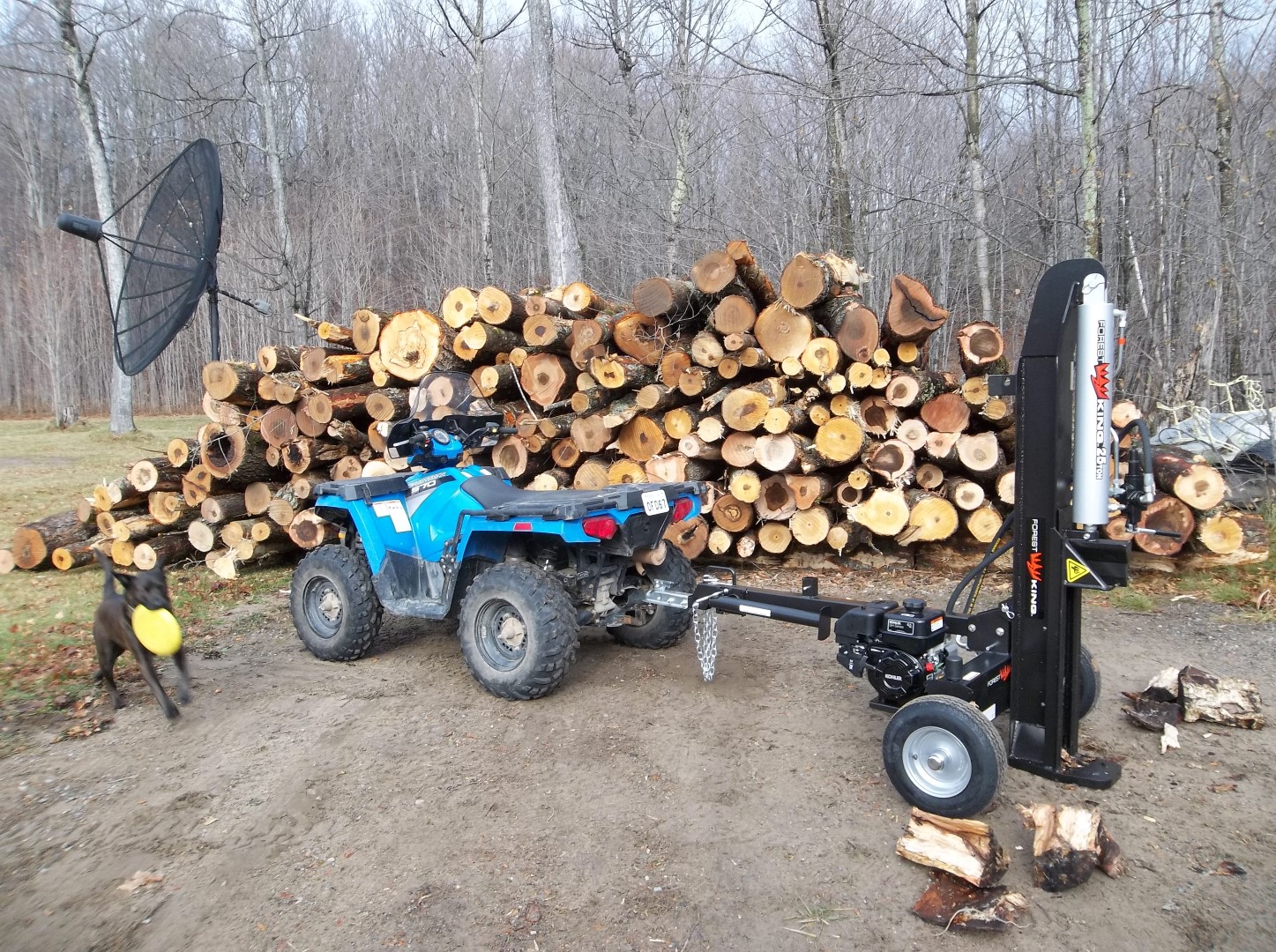

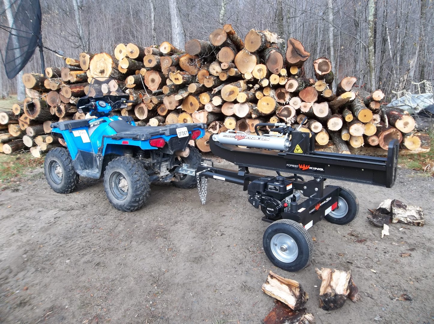

I debated this too Natethegreat. My big splitter is pretty tired and I wanted to replace it. I ended up getting a 25 ton Forest King on sale at Tractor Supply for $1000.
It can used horizontal or vertical and has a 5 h.p. Kohler engine on it. A motor like that can be replaced pretty cheap. So like you say....better to wear that out than put hours on your tractor.

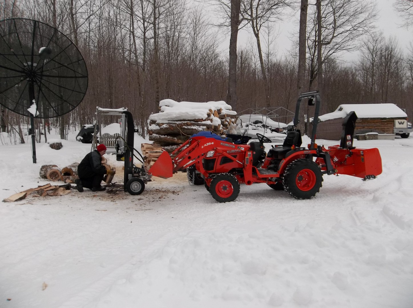

Good plan. When I'm splitting my tractor sits there with the hoe/thumb on one end holding long logs for bucking and/or I'm throwing the split wood right into my bucket to haul it for stacking. Meanwhile, my assistant (DW) is running the splitter and life is good.
The price of a decent splitter is not much more than the remote kit (which you should get anyway). A replacement engine is not much and I do 20 or 30 cord a year with mine (we do a needy person firewood give away program) and I've been running it 12 years without a hitch.
