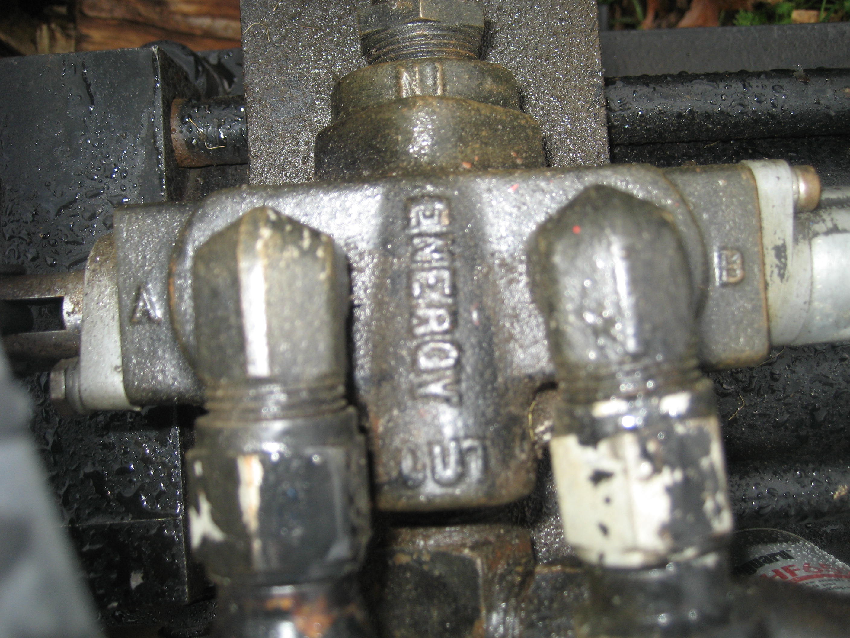

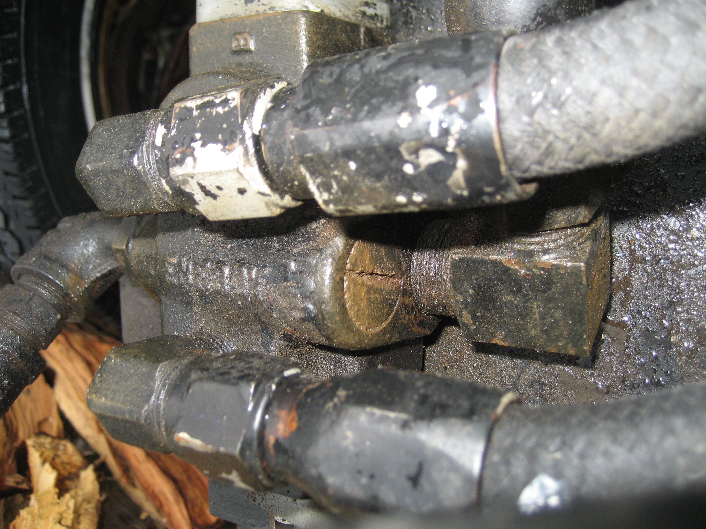

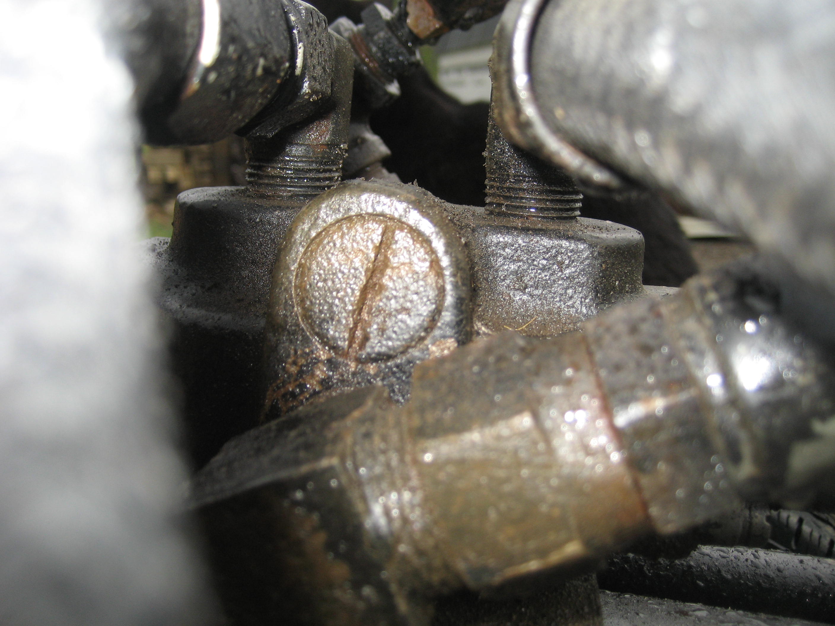

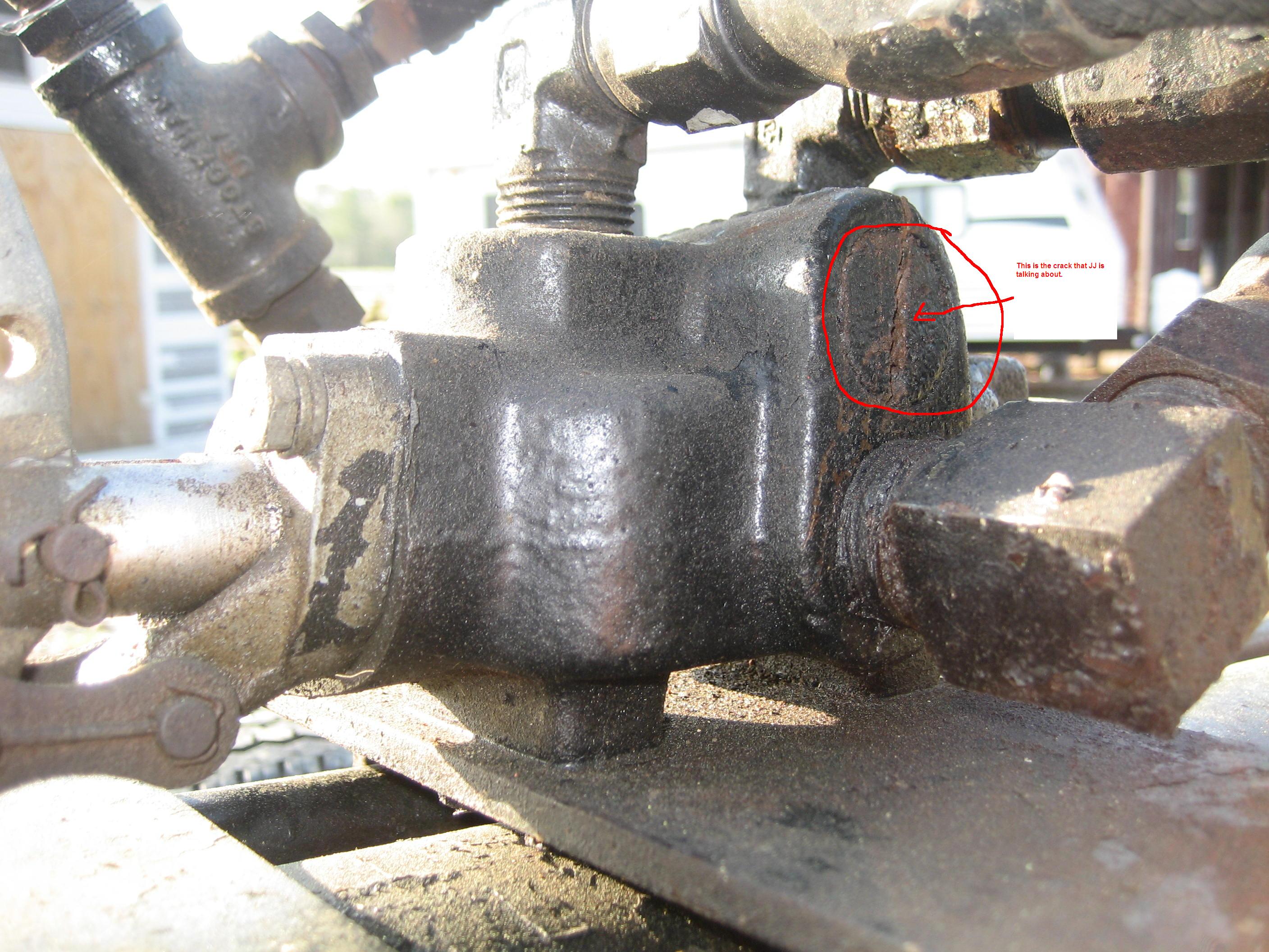

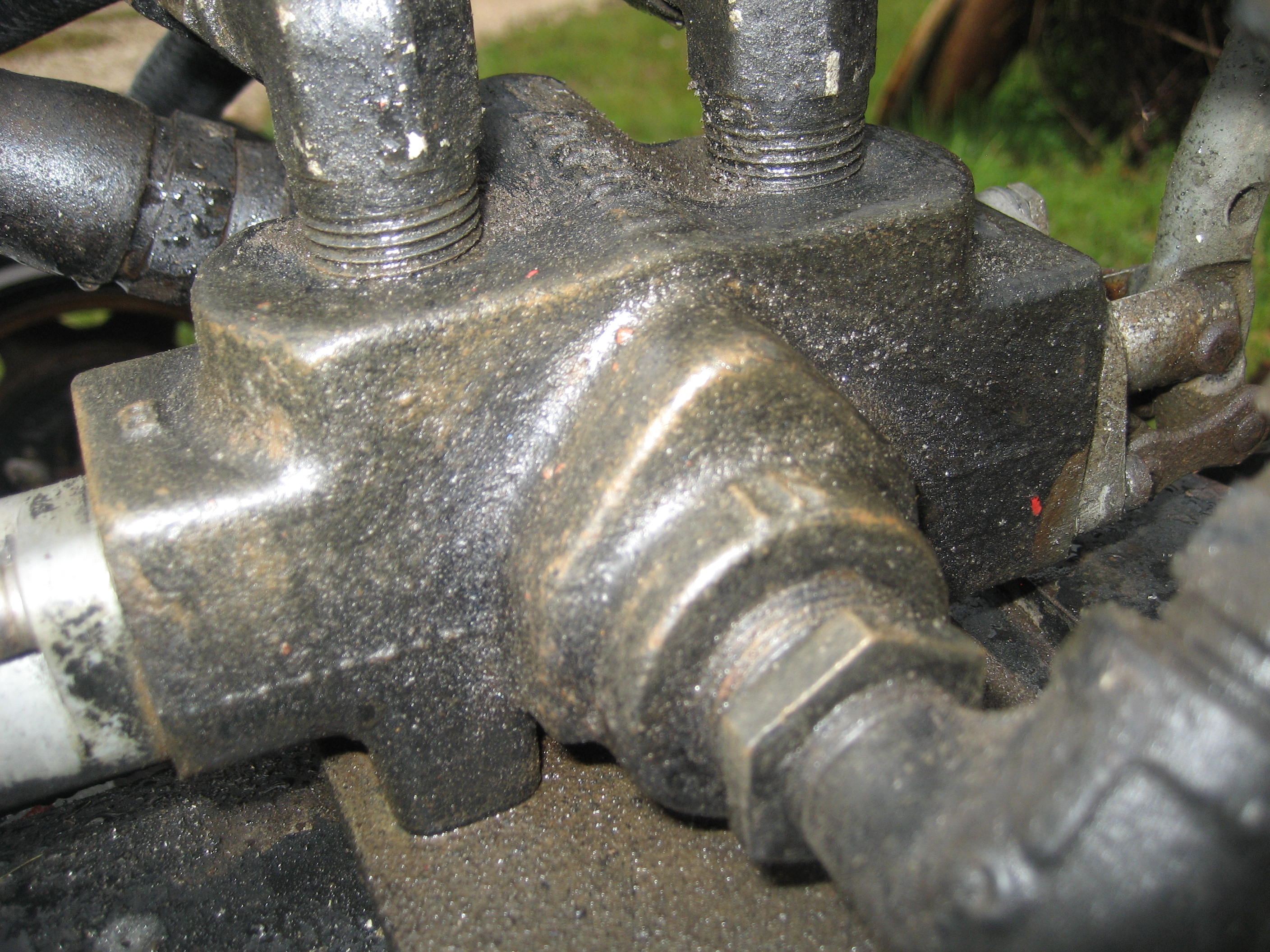

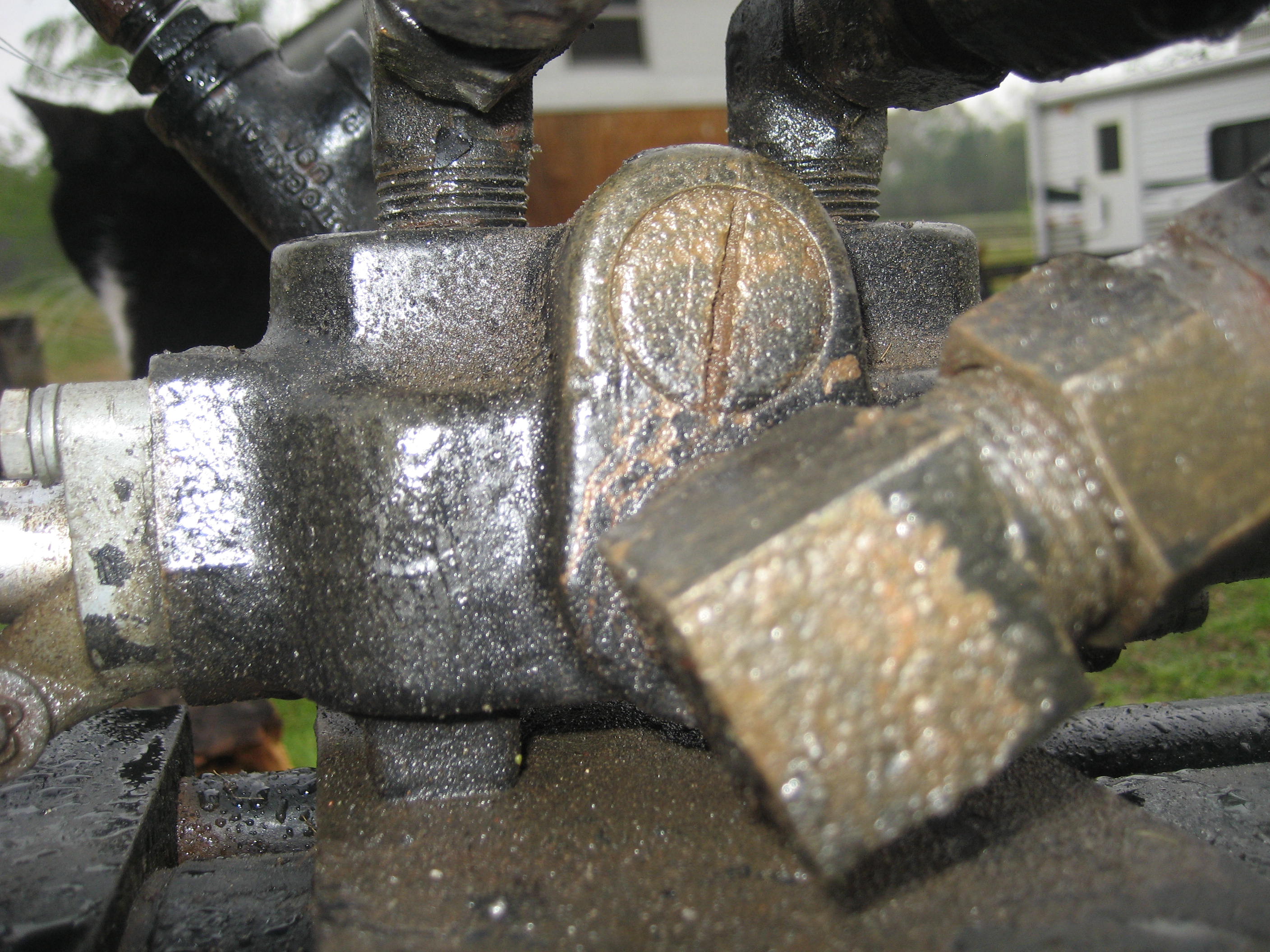

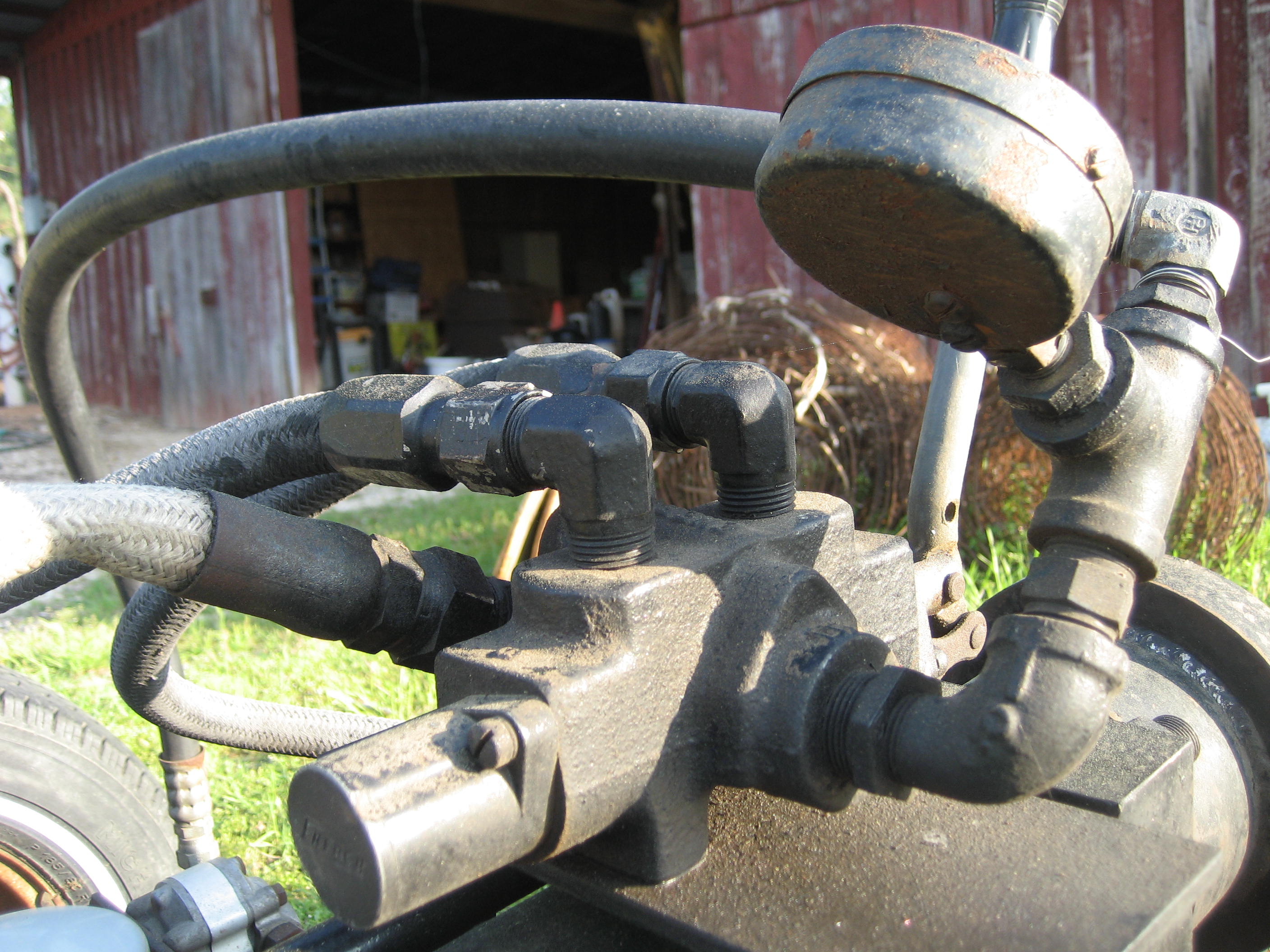

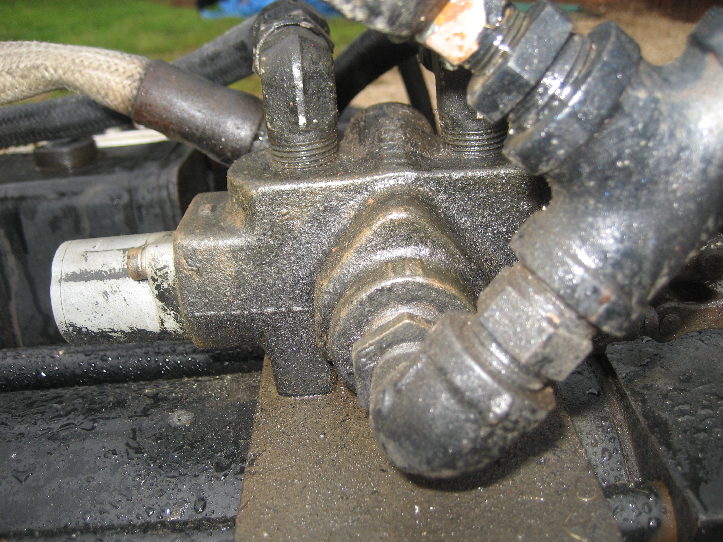

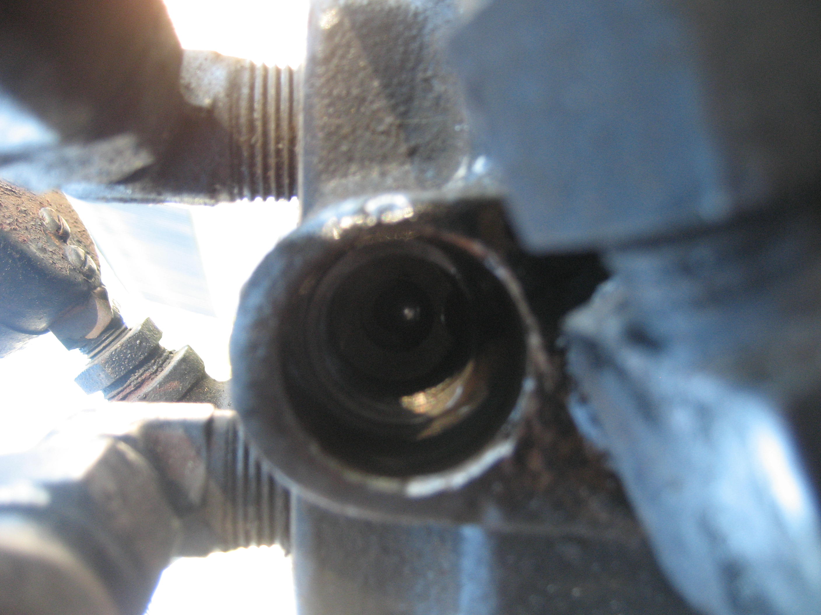

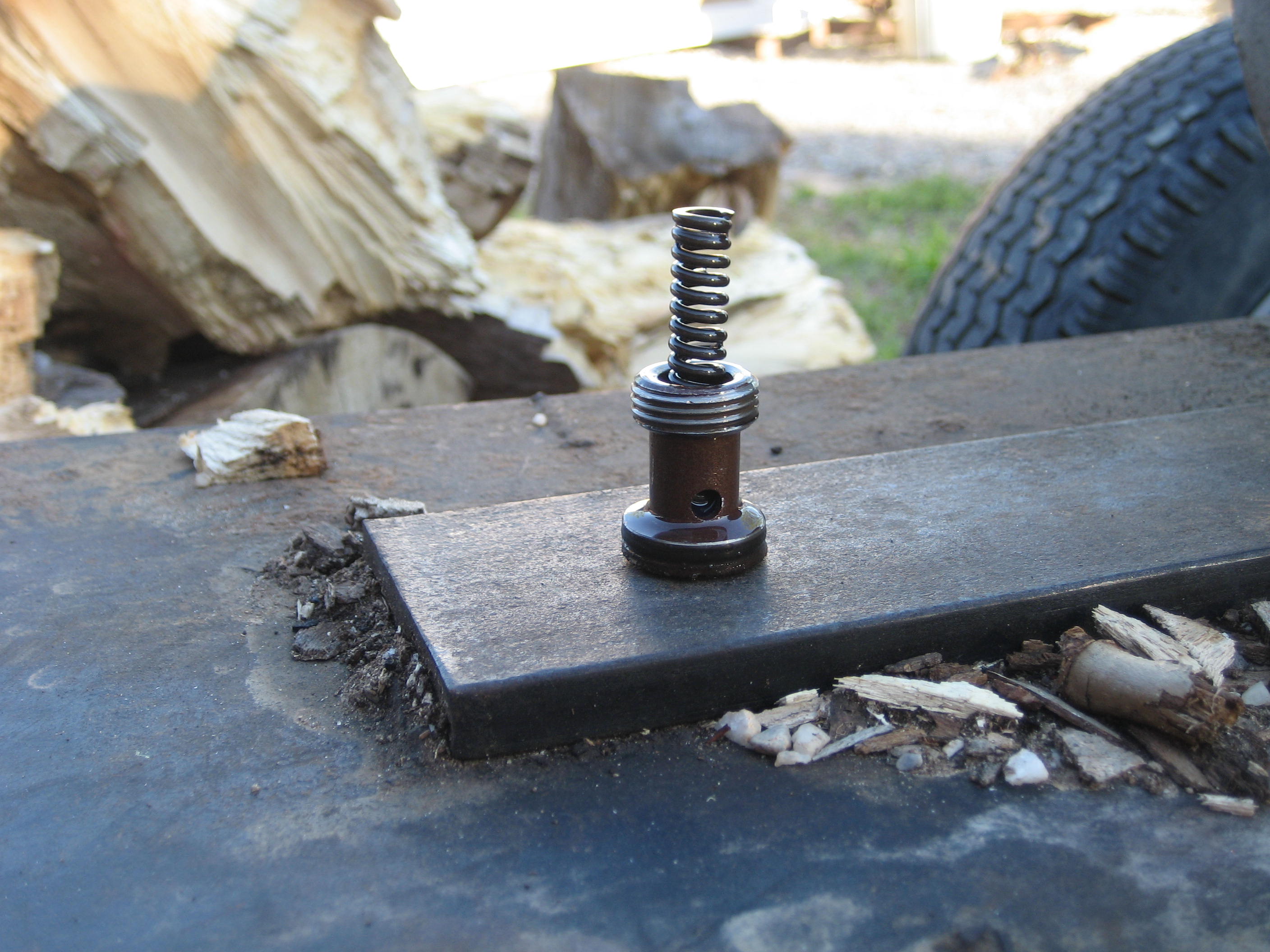

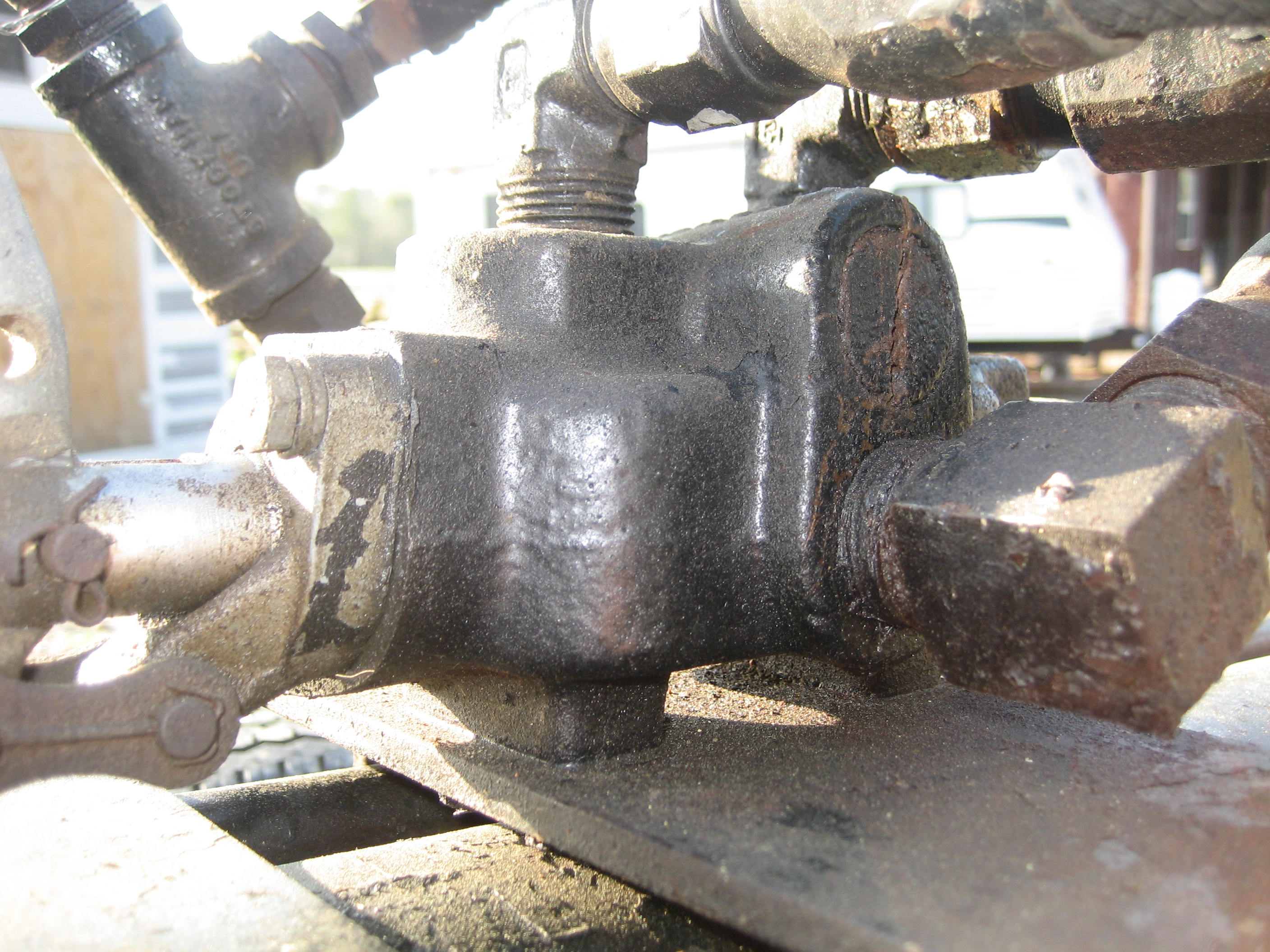

Well making a divit on the edge of the plug and hitting it using a punch and hammer several times did the trick. I started to think it was not going to do it but it finally gave way.
But, I did not find what I thought I would. There is not a pressure adjustment screw. Just a spring and steel ball pressed against the inlet side. I guess a new log splitter valve is needed.
Now, since my cylinder is 6 inches doesn't that require a different valve compared to smaller cylinders. I thought I saw that somewhere.

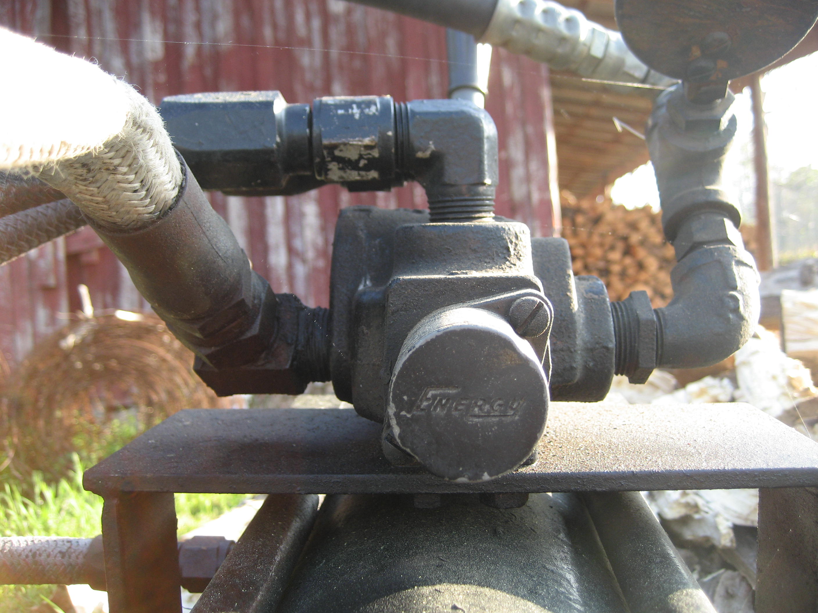

The control valve should be able to handle the volume from the pump.
The PDF you showed had an adjusting screw. Apparently what you have is an older valve with a non adjustable relief.
/ Log Splitter Pressure #23
the plug ,spring and steel ball are your PR, to adjust it you turn the plug in to increase the pressure and turn it out to decrease it. the plug pushes on the spring that pushes on to the steel ball. the more spring tension applied on to the ball the more hydraulic pressure needed to move the ball off its seat to release oil back to the tank side of the valve. the balls seat is just a hole between the in port and the tank port.
as far as the valve being to small this is not a problem in your case because of the pump size, at 4 to 5 GMP and a 6 inch cylinder you will have a slow machine. at 6 inches you require at least 16 GMP to increase the speed to a good workable speed. Jim

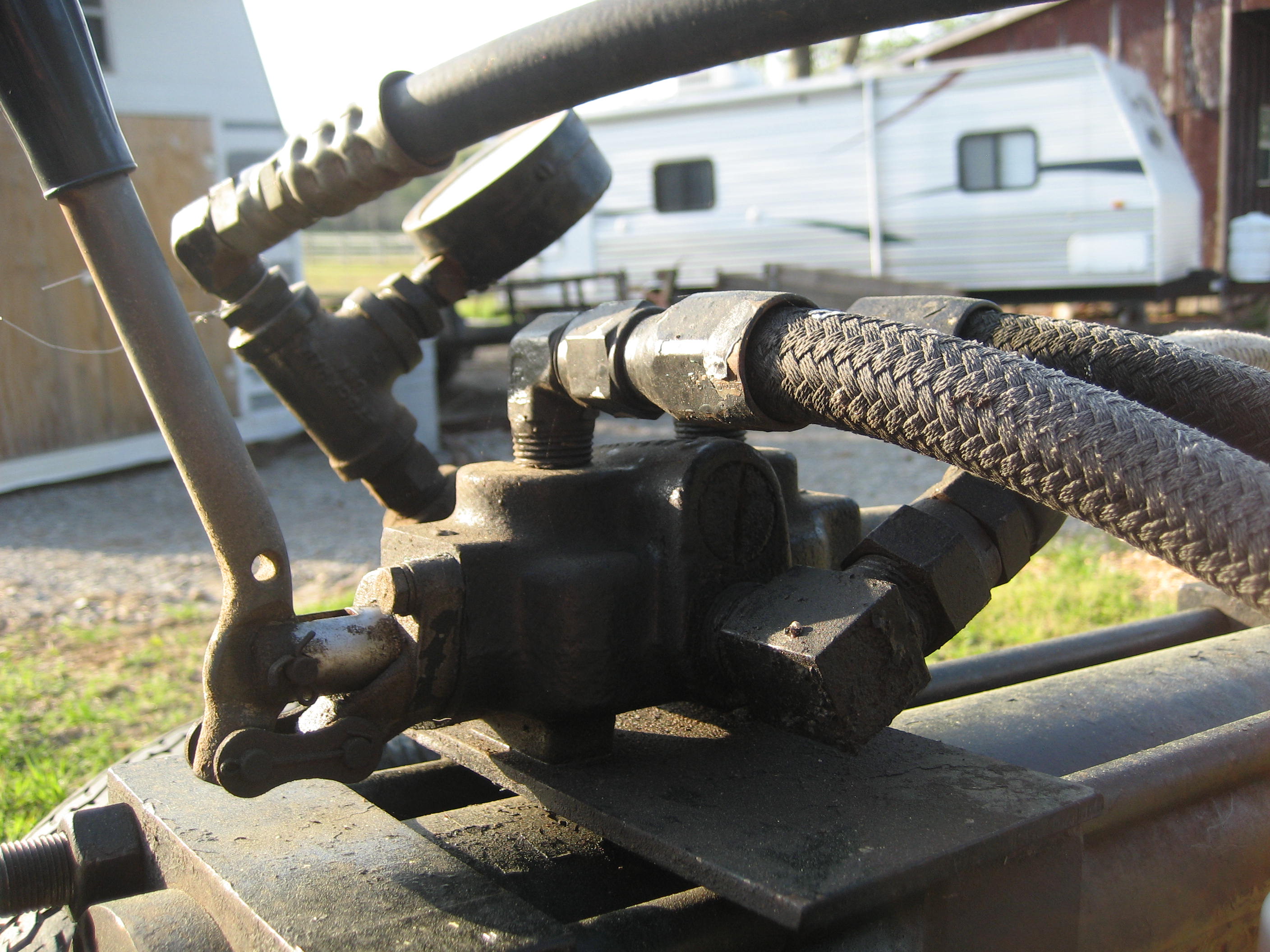

Then I am still at a loss for what is causing the cylinder to abruptly stop at 800 psi and the engine to bog. The plug seems to be bottomed out after taking it out and putting it back in a few times. It is flush with the valve body so is it ok to be recessed in the port to increase the pressure? The spring was really stiff so that may be why I think it is bottomed out.

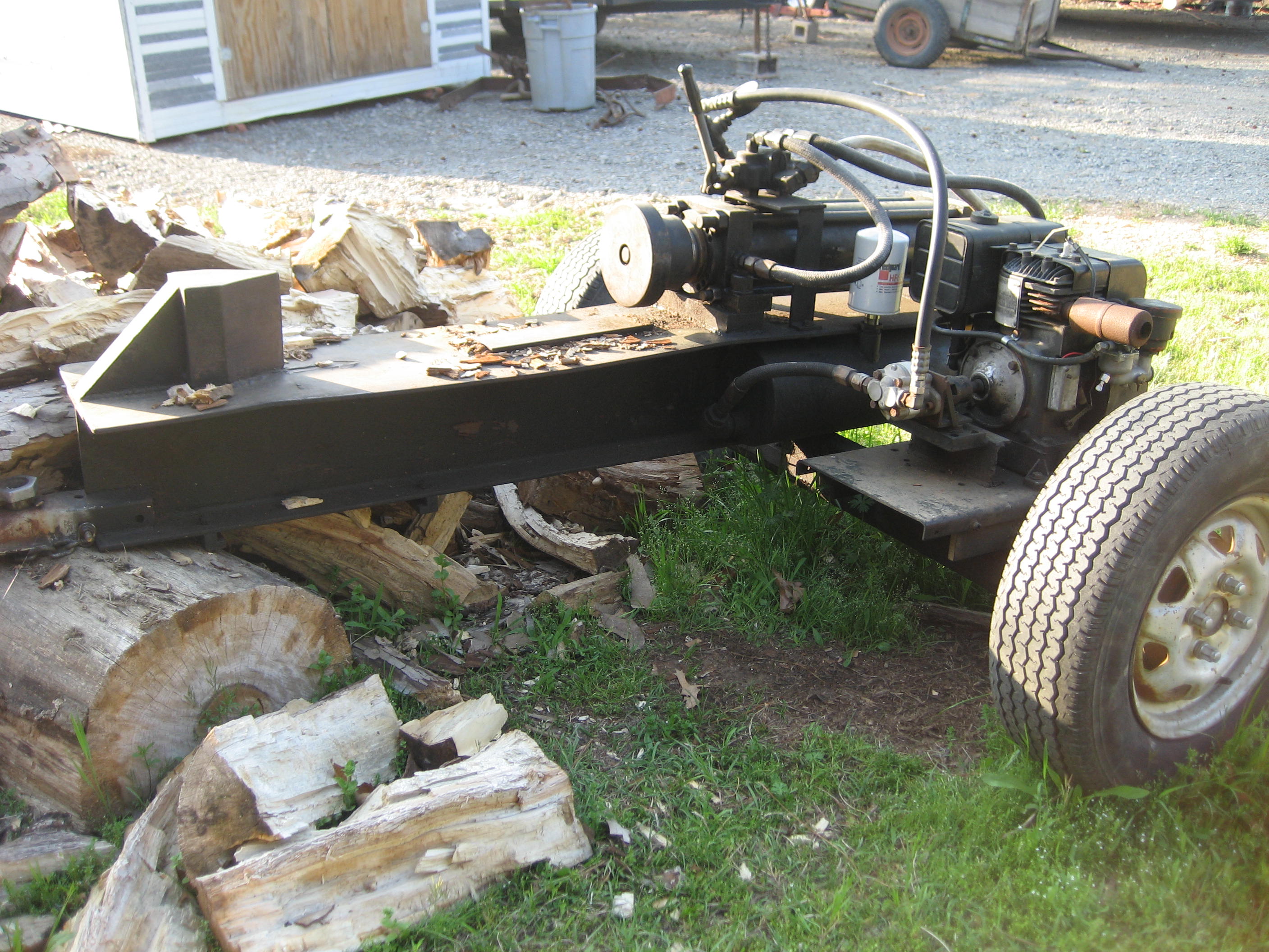

It does split wood as long as it is old and soft. I split several pieces of Sycamore but even a few of those did not split. When it would not split one the cylinder would press against the wood and the gauge would jump to 800 and the engine would bog down. The cylinder stops and will not try to press farther. I let off the valve handle and the gauge drops to zero and the engine comes back up. Same thing at full extend and retract. The gauge will go up to 200 or 400 on some pieces before they split but if it hits 800 it stops.
It has been a while but I think I timed the full extension at about 14 seconds and retract at about 8. I would really like a two stage pump but was trying to use this for a while first.

The valve in the pictures is 1970's or earlier vintage. The relief was correctly identified. The valve is not cracked, the slot in the adjusting screw and valve body are very corroded. Also, the valve in the ebay link is a 3-postion, 4-way, spring centered valve, probably mid 80's vintage. Our C-908 valve is the log splitter valve we make. The plumbing and mounting connections will be very, very close to the valve in these pictures. I have not read this entire thread, but just wanted to point out a few things regarding our products. The C-908 available at our website: Hydraulic Cylinders

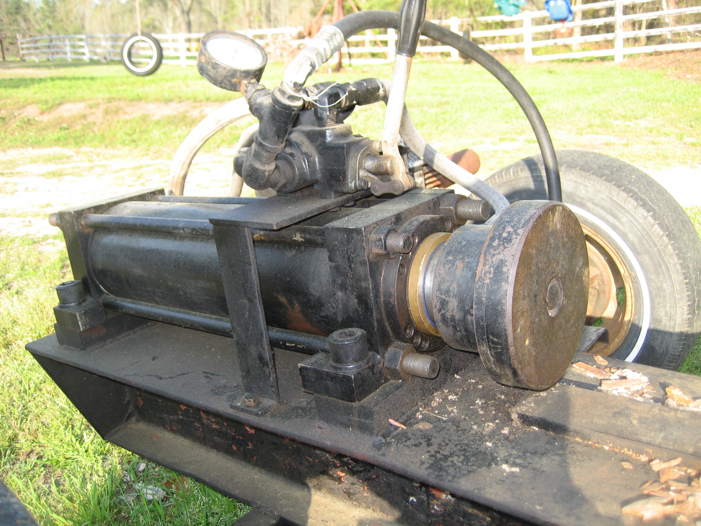

Well to give an update I used a punch and hammer to turn the pressure relief screw in. After a full turn it loosened up and I am able to turn it with a screwdriver now. I turned the engine throttle down to lower the rpm's and the engine stalled at about 1500 psi.
I turned the throttle back up and played with the PR so the gauge will show 2000 to 2500 psi when it is fully extended or retracted. Problem is when it hits this pressure now it kills the engine. No bogging just stops it.
I am able to split the wood that I was not able to before. I split several pieces. But, when it did get a tough piece and the pressure went to around 2500 it killed it without warning (other than psi). I would start the engine again and either reposition the wood piece or try to push again. Sometimes it would split the second time and sometimes just kill the engine again.
So, is the pressure relief not working stopping the fluid to return to the tank and killing the engine or is the engine just weak and dying under pressure. It either boggs down or dies wherever the pressure relief valve is set at, 800 or 2500. One other thing, I turned the pressure down to about 500 psi and the engine still started to bogg down until I released the valve handle.

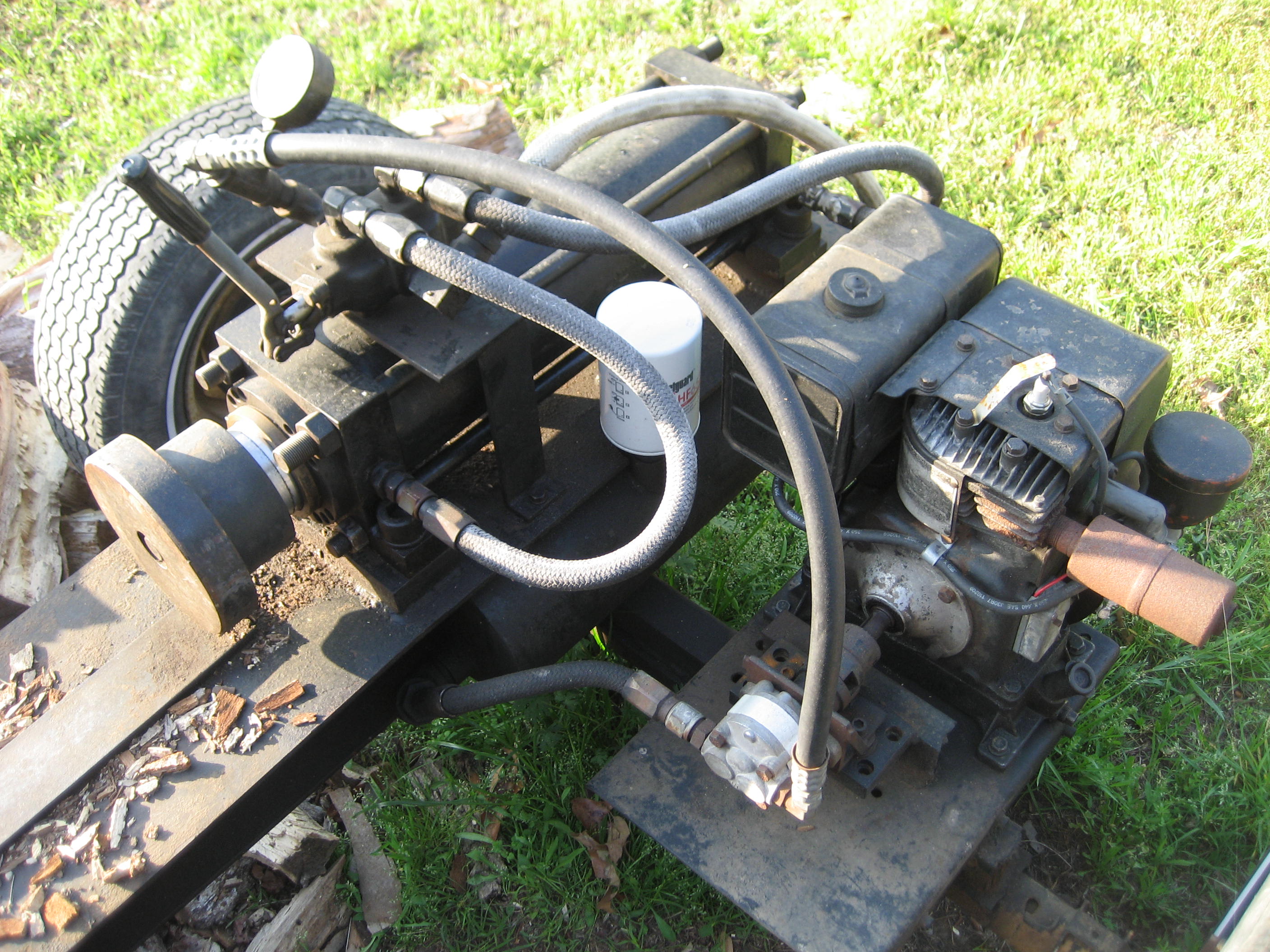

Wild... your engine is just running out of horse power to keep the pump turning,,,, when you stall the hydraulics you need about 2 hp per gallon of pump flow at 2500 psi. this is were the 2 stage pumps come in real handy, it allows lower HP engines to work with a high flow/low pressure(for fast extend/retract) and low flow/high pressure (for tough splitting) and keep the engine from stalling. Jim

If you say that your pump went to 2500 psi, and stalled, that is what is supposed to happen. At max engine rpm, you are pumping 8.14 GPM, and the pump, using cyl resistance, is trying to produce 2500 psi. It needs about 14 HP at that rpm and pressure, so now you have the answer.
The engine to support that pump should be about 14 HP. So at max rpm on your 9 HP engine, you are running out of HP. The system is just not matched.
You need another engine, and new valve.
