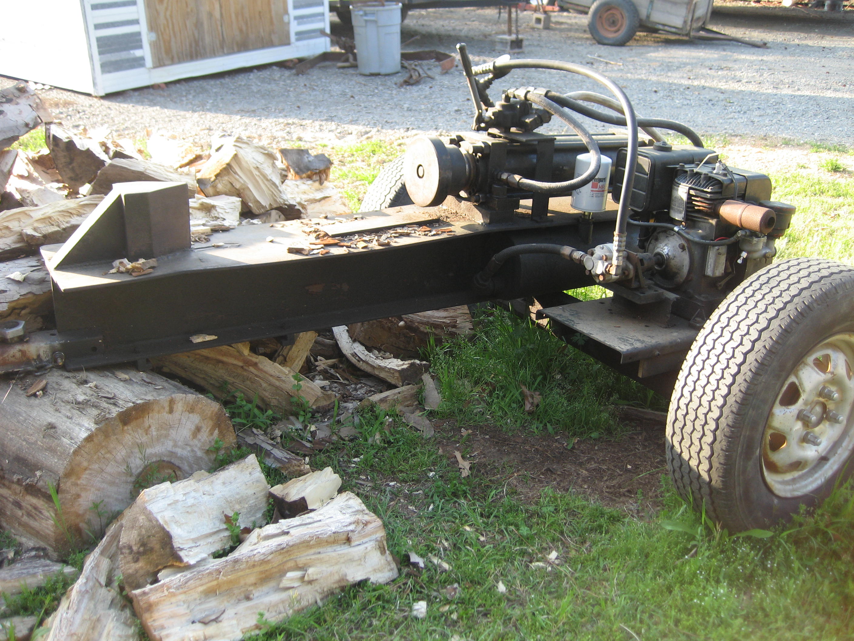

I have acquired an older home made log splitter that has a 9 hp B&S engine, 6 inch cylinder (3.5 in ram) w/ about 16 inches travel, 4 gpm single stage pump, and single valve. It limits pressure at 800 psi according to the pressure guage and boggs the engine down at that point. My question is will a two stage 16 gpm pump fix the pressure limit problem, not counting cycle time improvements, or is there something else that is causing that? I do not see an adjustment on the control valve to raise the pressure. The valve is an Energy brand.

4gpm @ 800psi is only a couple HP. [HP= gpm X psi/1714] Something is wrong if its bogging a 9 horse engine.
larry
/ Log Splitter Pressure #3
It takes about 8 HP to pump 4 GPM, at 3000 psi. It would only take about 2 HP to pump 4 GPM at 800 psi. What we don't know here is the pressure limits on the pump. A relief valve could be relieving a lot of the pressure.
You must have put a gage on it to say that it had 800 psi.
Is the valve connected correctly. Maybe it is reversed.
This pump, a 16 GPM two stage only requires about an 8 HP engine.

Thank you for your help. The engine is a B&S Model 9 Serial 77804 Type 201023. I had a shop go through it because it was full of dirt dobbers and had been sitting for several years. They told me it was 9 hp. Anyway, it already had the guage and everything set up and together. It will extend and retract super slow and when it bottoms out the guage will hit 800 psi and then the engine boggs. It does the same splitting wood. Split anything until 800 psi is reached and then just stops. The engine does not bog until the 800 psi mark but the pressure will not go past that. Its like the limit of the valve, pump, or something it set there. The guage is a Vickers, 3000 psi, and attached on the pump side of the valve.

Thanks guys, ya'll are great. I put up some pictures of the unit for reference. I do not know if the pressure release works or not. I have never changed any settings only installed filter, cleaned and filled hyd. tank, had a shop go through the motor, and had the cylinder redone because it was pouring fluid out on the return stroke. The pump is rated for 2500 psi. Here it is:

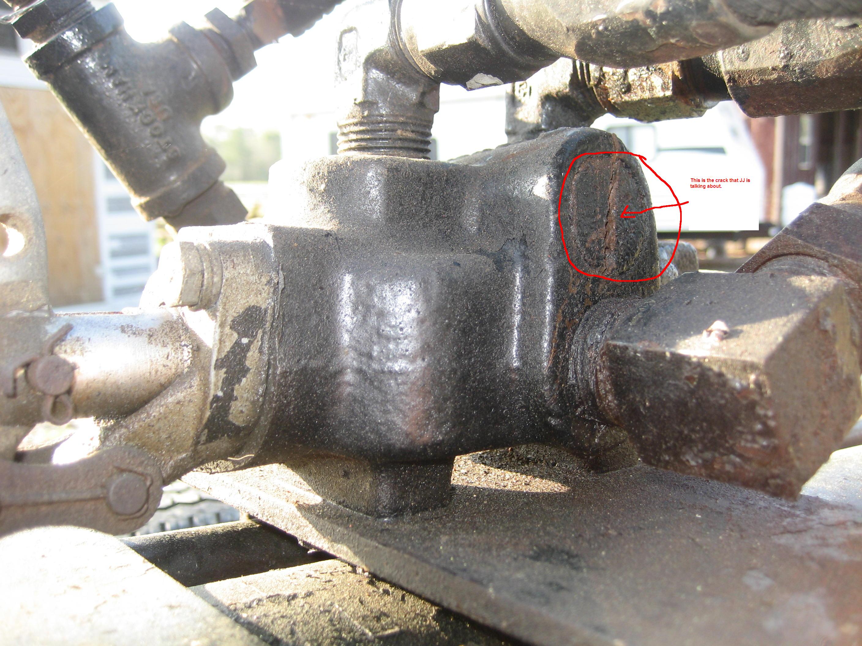

What is the letter stamped above the port with the slotted plug? If it is a T, then that is your tank port. The slotted port might be a relief valve, but a PRV is normally close to the IN port. I also see that you are using a galvanized fitting for the tee for the gage. That is not recommended. But then again, this might be a low pressure log splitter.
Picture #7
Looking closer at what I thought was a slot, looks like a crack in the plug and port. Anybody else see this?
After looking at the photo again. I notice the crack too. I circled the crack in a photo for others to see as well.

After look at the pdf of the valve, that is a relief valve. I believe the body of the valve is cracked, including the relief seat, and most of the fluid is bypassing internally. I am surprised that the valve is not leaking externally. The pictorial in the pdf shows a bolt for the relief, and your valve has a flat face plug.The relief is factory set to 2000 psi, but can be adjusted
Can you clean the valve off and take a picture from the top of the valve.

I attached more pictures of the valve with it cleaned with a wire brush. The water is from rain. The "crack" that you see is a flat faced plug that has a slit across the diameter of the plug the same as a flat headed type screw. The valve is not leaking anywhere from the body or connections. I do not have anything thin enough, and wide enough, that will turn the plug without twisting. WD-40 has not helped. If the relief under the plug, according to the pdf diagram, is not functioning properly then a new valve will be on the way.

The PRV adjustment is 400 to 2500 psi, so yes, someone could have set it to 800 psi. If you can't get to the relief, Your only option is to replace the valve with a $69.95 log splitter valve from Surplus Hydraulics , that has detent on thr return stroke.
You might can take a Dremel tool and deepen the slot on the plug, and soak it in penetrating oil, or use a screw driver and tap on the perimeter of the plug and see if it will loosen. That is just a cap screw, so you could perhaps drill it out. If you look at the parts break down, you can see what is under the cap
/ Log Splitter Pressure #19
Yes. Make a divit on the perimeter of the plug somewhere away from the slot. Use a drift punch in the divit to drive it CCW [punch delivers much more impulse force than a screwdriver]. I say this because you might split the plug by forcing it using the slot.
