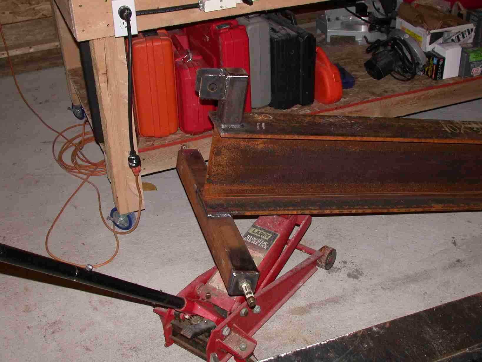

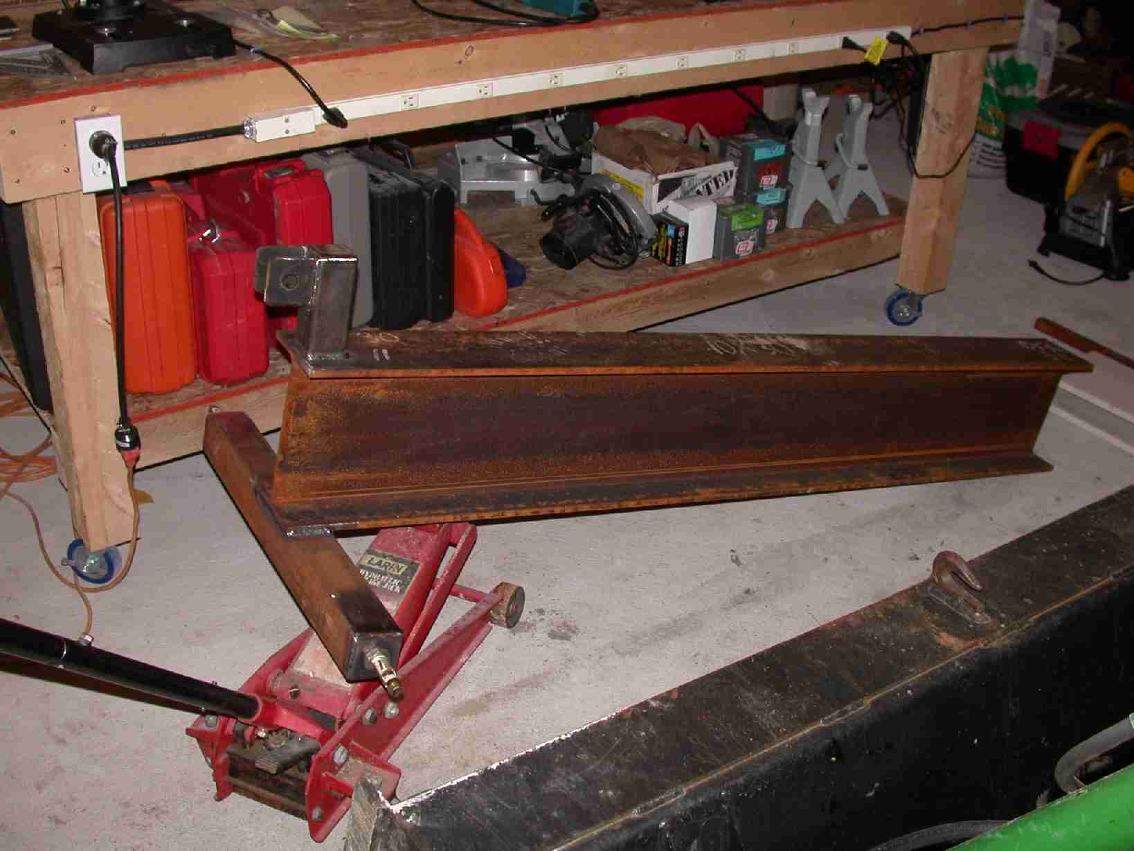

Here are some additional photos of the progress. The progress has been slow because I have been trying to complete so many different projects around the house. Anyway, I am on vacation next week and hope to have this completed and painted. Will post more next week.

#34
another picture of the log splitter.

/ Log Splitter Attachment #36
Scott, these pictures are really great to see. Looks like your log splitter is really coming along.
Can you give one more angle? The one I am looking for is how you connected the valve on the other side.
Thanks,
/ Log Splitter Attachment #37
Scott,
Good looking work.
I have a 1985 bush hog splitter which looks similar to yours. One of the improvements I think have been made on newer models I've seen at Tractor supply is the knife is mounted to the bracket on the end of the cylinder & the wood stop is mounted on the end of the Ibeam.
With my splitter, if wood gets stuck on the knife, I have to attach a chain around the wood & fasten to the cylinder to pull it off the knife. With the new models the knife retracts back inside two uprights & the wood would be pulled off the knife when cylinder is fully retracted.
Also another thing I would do if building my own today, is split the wood stop on the end of the Ibeam, so the knife would pass through the stop a little way. This would help insure the wood came apart ( when splitting something stringy or knotty).
I feel you enjoyment when building a project like this.
#38
Shari, thanks for the kind words. Is this the shot you want? This was before I mounted the hydraulic piston on. I want to re-do the stand the valve sits on. It is strong enough but not good enough for my standards. Let me know if this helps.
