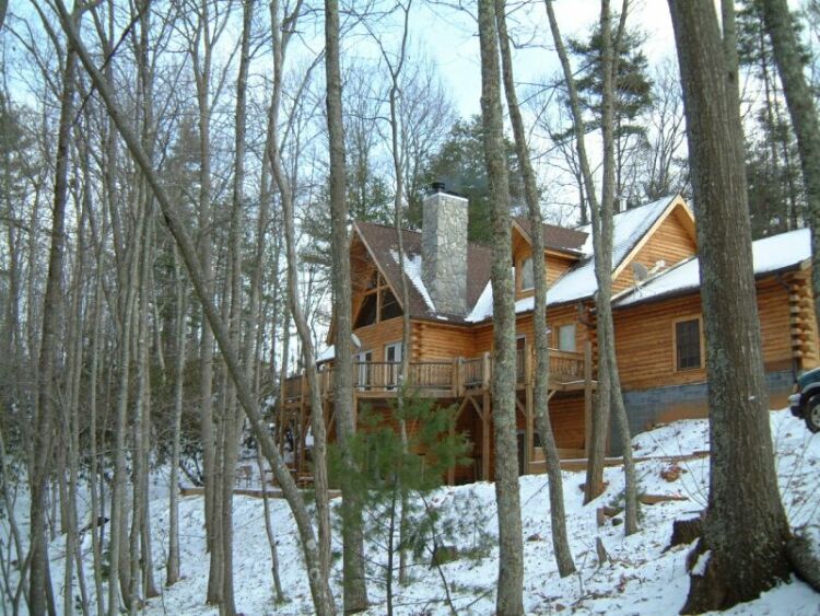

my home in western NC...Southern Yelllow pine "D shaped" logs....spline of plastic in center groove with 'invisible" caulking....no chinking
model my Southland Log homes that was customized
3 years old...no settling....only minor cracks
if on a basement foundation.....i would advise full poured concrete walls as opposed to concrete block......my basement walls are 8" thick poured concrete with waterproofing pvc and a chemical spray...20 year guarantee......no moisture found as of date
main problem with log home construction is finding contractors and subcontractos who know what they're doing.....most of mine didn't
still.....the materials used were good

What's the atvantage of poured concrete walls over concrete block walls. Most specifications will call for 10 in. blocks. Either one will preform admirally if installed properly.
No settling?? Were kiln dried logs used? Or are you talking about foundation?

I would have to speculate that since the poured concrete walls have less joints, there is less of a chance of water seeping through. Also, the poured walls I've seen look like they are ready to finish. They are indented for easy insulation installation and need no studs for drywall.
BTW, the concrete blocks used today seem to me to be not as strong as the old cinder blocks. They crumble alot easier.

Nice place! That's what I mean when I tell people about log homes. They seem to picture a 2 room bungalow in the Poconos, or the picture on the Log Cabin Syrup bottle!/w3tcompact/icons/laugh.gif
