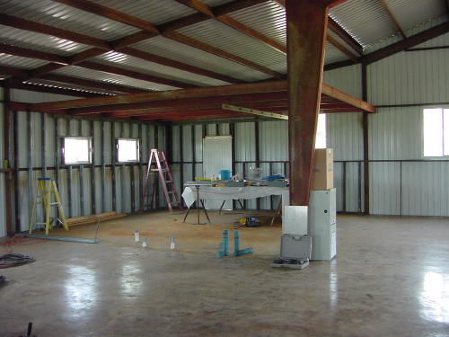

One of the problems I have in life is some customers just turn me loose to make their dream come to life sorta kinda. It is fun, usually complicated, and always evolving.
This is an example.
Customer had a six thousand square foot metal building made. I had nothing to do with the original building except to build the pad it was built upon and donating some of the beams.
Customer loves storage. He is an acquirer's acquirer. The space above the main floor, sixty by sixty clear span, drove him crazy, not holding or capable of holding some things.
He was like a puppy with two tails over that space just taking up space. He worried and wondered and of course I was questioned, repeatedly and often about how it could be turned into a loft.
I came across a load of nine pound I beams. And I had a bushel basket of JR beams. Twenty feet was the common measurement one way and six inches the other. Ideas cooked for a bit as the hands were busy doing stuff like the framework for the living quarters in one corner.

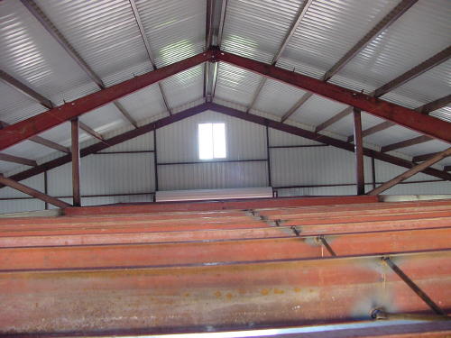

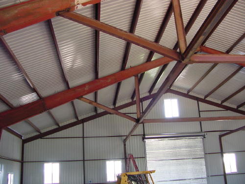

Here's the space I'm talking about.

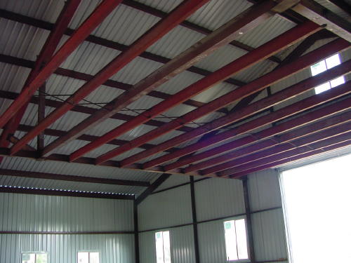

I figured the only way a loft could be made that wouldn't interfer with the floor space would be if the loft framework was part of a truss system supporting the roof.
The engineers will probably be all over me like stink on a June Bug over this but............ /forums/images/graemlins/smile.gif

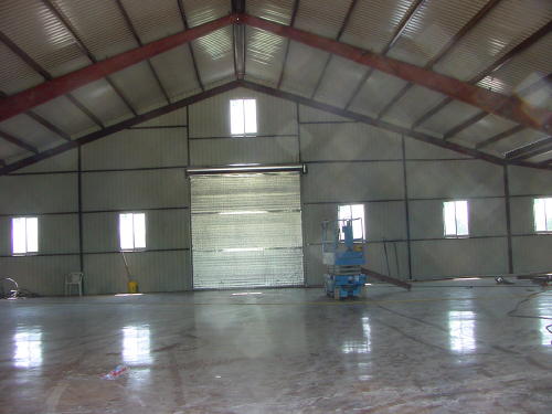

another angle of the dangle.......

and another

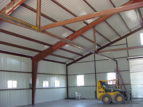

That half inch rod in the right hand corner of the last picture is the truss between beams. Here's a shot of that.

Here's a better shot of the truss idea for the support of the floor across the span. We've taken the weight from a down force to a cross force at a thicker part of the web. Instead of pulling down we're pulling together. /forums/images/graemlins/blush.gif At least I hope so, if not I'm out of politics forever...... /forums/images/graemlins/grin.gif /forums/images/graemlins/grin.gif /forums/images/graemlins/grin.gif

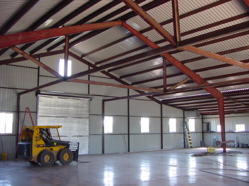

Yup, that's a gap in the Jr beams. We needed twenty seven of them puppies, had only twenty, seven new ones coming in tomorrow, also the decking, and the railing material. We should have this project at the point where all we need to do is find the fork lift mast that is going to retire to a life as an elevator. /forums/images/graemlins/grin.gif
