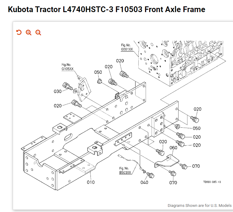

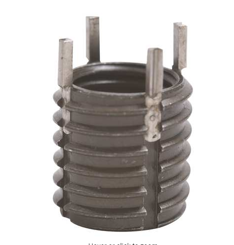

Some of the bolts attaching the engine to the frame on my Kubota have stripped out
I would like to use a locking threaded insert instead of a HeliCoil
They come thin and thick walled
Has anyone done a similar repair and did you use thick or thin walled inserts?

In my 45 plus year career as a machinist I have installed and used many different types of thread inserts, even ones I have made myself. If there is enough material in the part with the stripped threads then the thick walled inserts are best when considering the use of the type of insert you want to use. My conditional opinion. There is a tool made for driving in the locking pins. Make sure to use this tool. Though you can drive the locking pins in with a hammer and a punch, or even just a hammer, driving the pins successfully is almost guaranteed when using the tool. Without the tool, not so much. Especially since it sounds like you may not have much experience with these inserts.
All that said, I still prefer Heli-Coil type thread inserts. I prefer them because if the stripped hole has not been worn out too big a Heli-Coil type thread insert offers more strength than the original thread and removes the least amount of metal from the repaired part. I have installed over 15,000 Heli-Coil type thread inserts just for one customer. This customer uses them in aluminum castings for marine use because they are so much better than cast aluminum for fasteners that must be removed and replaced, such as some types of service hatches on boats. Installed correctly they have never failed.
I am curious about why the original threads failed. Do you know why? If so then make sure you correct the reason for the failure. If you don't know why the threads failed in the first place then you should not only figure this out but realize that when considering which insert to use the thick walled insert should not be used. This is because the type of insert you are wanting to use cannot be removed easily without damaging the thread in the parent material. This is mainly because of the locking pins, which have already damaged these threads. By the time you have worried the ruined insert out the hole will probably be a mess and will require drilling and tapping for the thick walled insert. Even though locking inserts use standard taps, unlike Heli-Coil type inserts, they do not use standard hole sizes for the tap. This hole is larger than would normally be used for the tap. This doesn't matter because of several reasons that I don't want to type about in this already too long post. But it does mean that if the pin locking type insert fails you have less material to work with when installing yet another insert.

I'll probably take your advice and start with the Heli-Coils and keep checking them a keep my fingers crossed
Agree that the locking thread inserts require a bigger hole so I'll keep that option as a backup

The type of insert the OP wanted to use in the first post only has about 50% thread. This doesn't matter because of the aforementioned reasons and is an advantage because it makes the minor diameter larger, strengthening the insert. And since the insert is in a tapped hole that is much larger than the fastener but only needs to be as strong as the original tapped hole there is another advantage because the much larger area of the insert outside diameter spreads the load over that larger area. And even though I don't know for sure it is very likely that the insert is made by forming the thread, not cutting it.

I agree with Eric. I would also start with the helicoil. If done correctly, they will be fine. The inserts the OP is showing works great in a softer base metal but must have a quality drilled and tapped hole.
