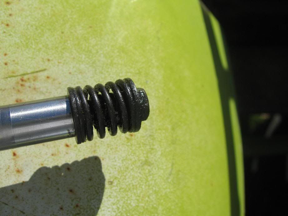

I just purchased a Yanmar YM240 with a loader 2 days ago. When I bought it the motor was partly disassembled, supposedly to replace a headgasket. I got it back together and running, though my motor difficulties will probably end up in another thread, but for now, my trouble is with the loader valve. The lift works fine, but seems to lug the engine until everything is warmed up. The bucket curly, however, seems to really load the motor. It curls easily, but when trying to dump the bucket the valve won't move. Applying a LOT of force, or bashing the lever in frustration, sometimes lets the valve move and dump the bucket. The motor lugs when that happens, and feels like it may stall, and no matter what, the bucket is EXTREMELY slow. Letting off the valve brings the motor up to speed again. Where should I start looking? Thanks in advance for your help.
Edited to add: The loader is powered by a separate pump driven off a chain drive from the crankshaft, not by the 3 point hydraulics.

Success! After struggling some to remove the hoses from the valve, I got the spool out. It came out in a straightforward fashion: Pull the cap on the opposite end from the lever, and, after unpinning the lever, pull the spool out. It has a spring on one end, retained by a bolt and washers on the spool and bolt head ends.
As you can see by the attached photograph, the spring was filthy with a tar-like crud, and inside the cap the crud had congealed into a crusted layer of carbon. It looked and felt just like the crust in the bottom of an oven if pie boils over. I gently scraped everything as clean as possible with a rifle brush, then dunked it into my ultrasonic cleaner. I ran it all for a 6 minute cycle in warm mineral spirits, and everything came out relatively sparkling. I reassembled it all, and now the valve works fine! Now if I could only make the motor run properly....That will be another thread, find it here: YM240 smokes heavily, lacks power - TractorByNet.com
