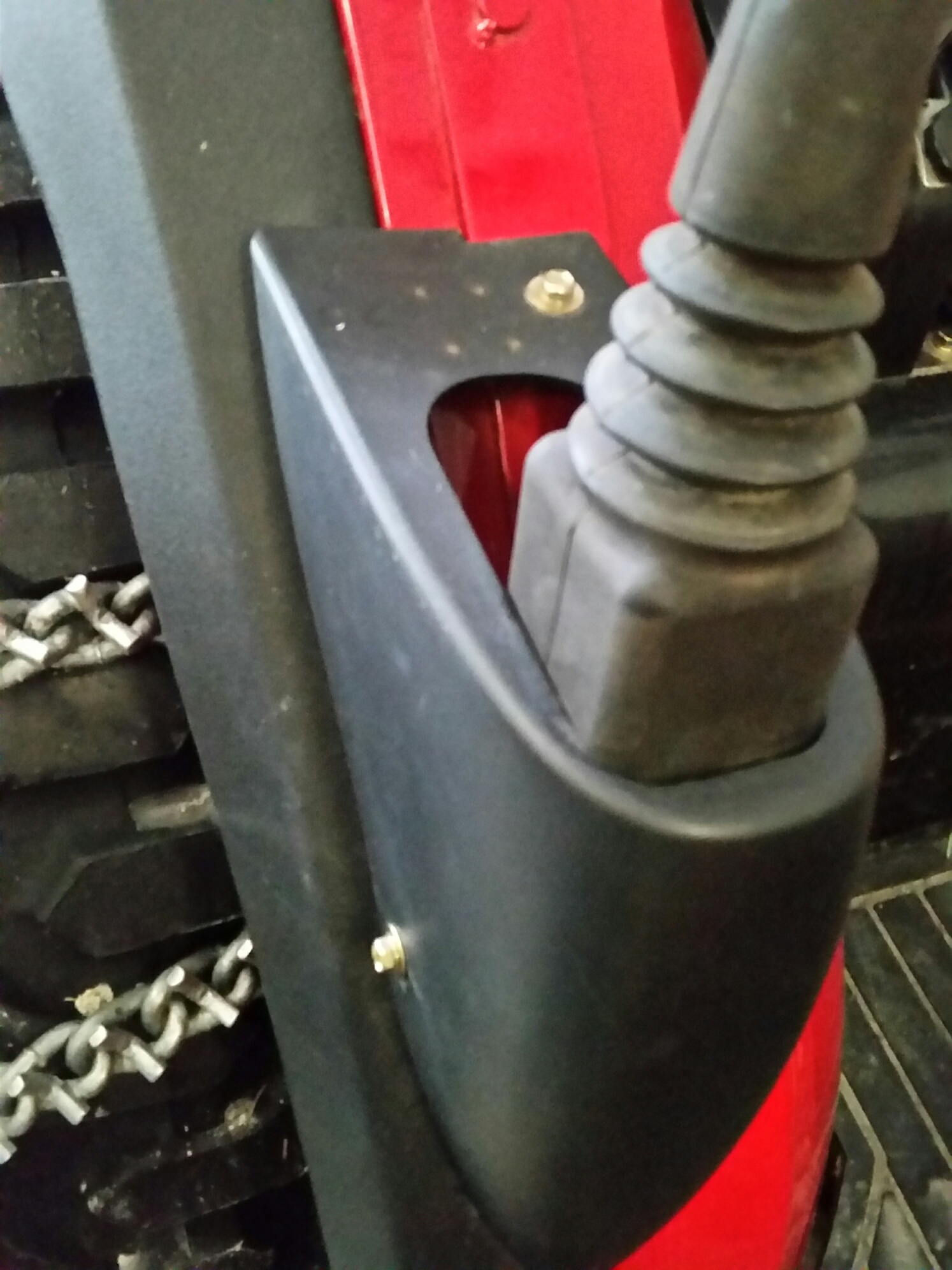

Gregster,
This winter I lost the curl function on my loader, it ended up being a broken cable due to rust. Here are a couple of pictures of the assembly under the joystick on my 353. I do not know if your 273 is the same.

Hi Joeyd, I saw your thread and that's the area I was trying to uncover to grease/re-grease and check the balls to see if they were plastic or steel. But...I got stuck at trying to remove the black plastic cover just on top of the joystick lock? How did you get it removed?? I just couldn't seem to find an appropriate way to get it to come up and off. Sure didn't want to break it either! My joystick looks practically identical to your pictures.
As far as the cables connecting to the valve spool, I assume one can remove the cap/cover on the valve at that end also? You said that you - adjusted - the cables by screwing/unscrewing the ends? I didn't quite see where the adjustment function was located? I sure would like to get some type of motorcycle chain lube sprayed into the cables to assist them in remaining flexible - slide-able also. Even if it isn't needed, I don't see how it could hurt any? Any further advice/thoughts would be appreciated. Thanks, Greg

I removed the three bolts on the plastic cover, (there is another on the seat side), that exposes the rubber boot. The boot was partially held in place by pressure from the two bolts that holds the joystick control. As I remember the cables can be adjusted under the joystick control, there is a lock nut that holds the adjustment.

Hi Joeyd, Thanks for responding. My stick must be slightly different then?
I understand how to expose/remove the rubber boot, but - unlike your 1st picture in post #15 - my lever lock comes out "through" that little slit in the hard plastic portion that the rubber boot sits upon. My rubber boot just grasps in the plastic groove and easily slides up the stick but the hard plastic still encapsulates the loader lever lock and remains covering up the balls and such.
I don't need to remove it now after all anyhow - but I sure am curious as to how it does come apart? I had hoped to find a solution in case I ever did need to remove it and thought you might have found the way; but yours must be slightly different or I just am not seeing things correctly!
