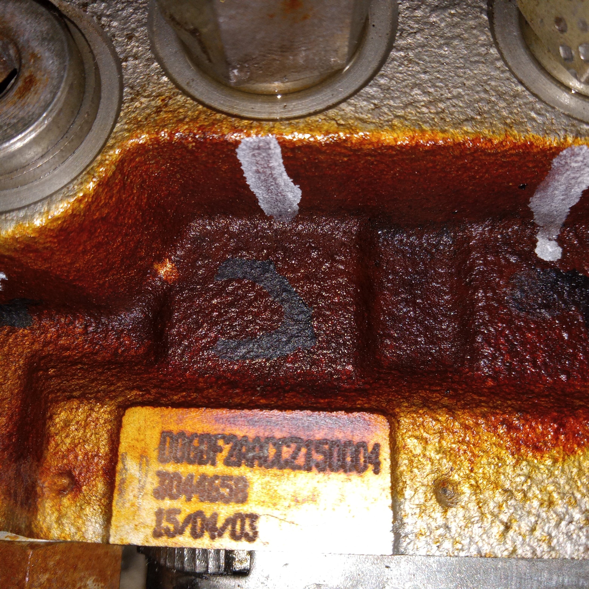

Well, I've searched for some time and I cannot find any information on this spool.
It is made in Italy, and the number looks like DOGDF2AACCZ150004
3044668
15/04/03
Any help would be appreciated. Thanks

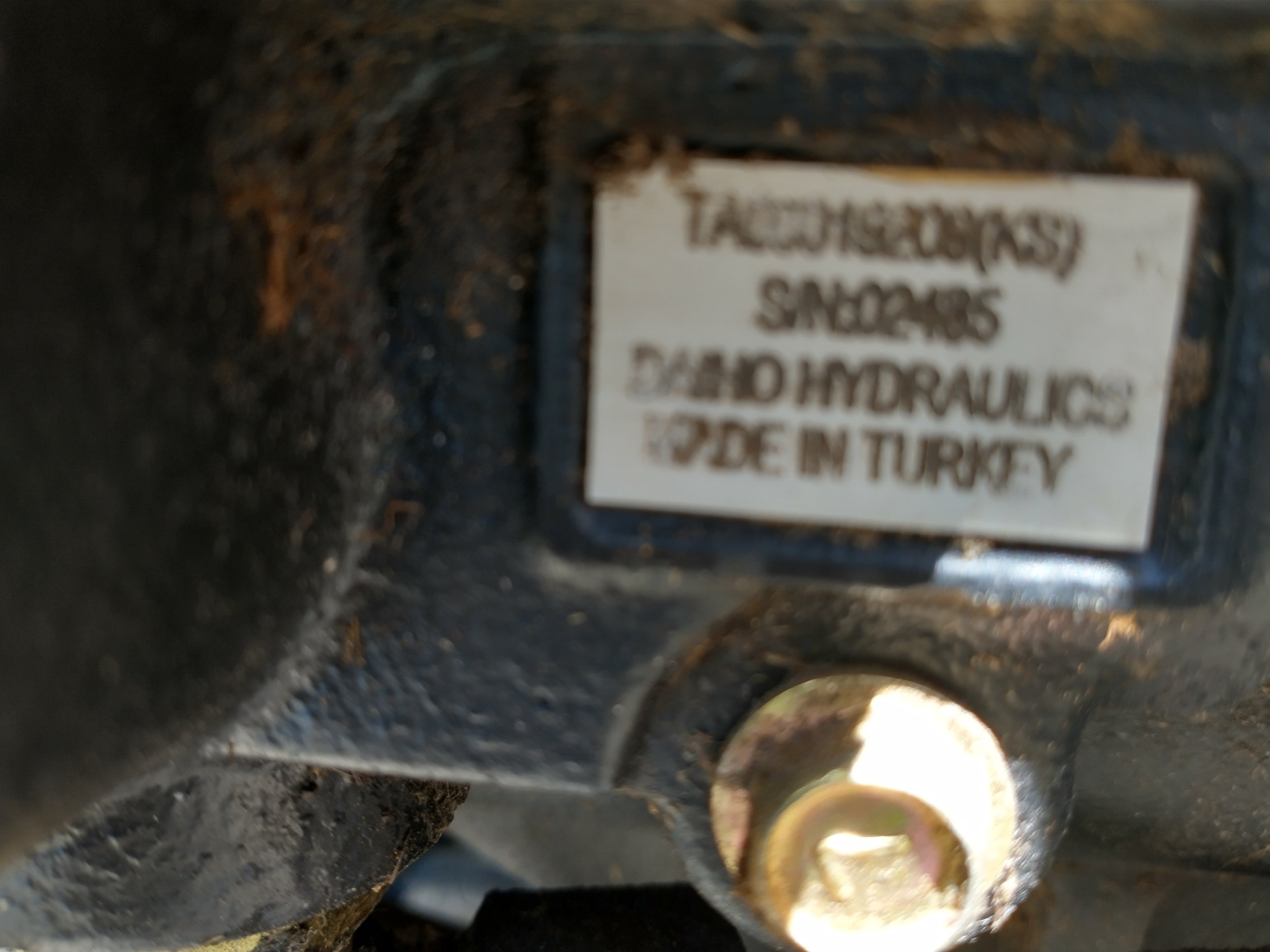

Very similar but made in Turkey,
good luck in your search.
