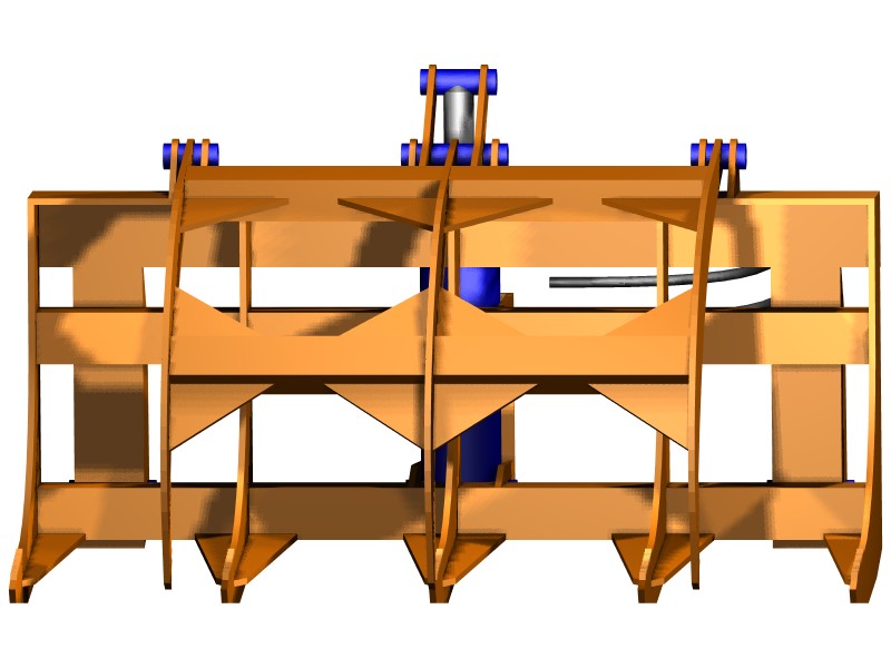

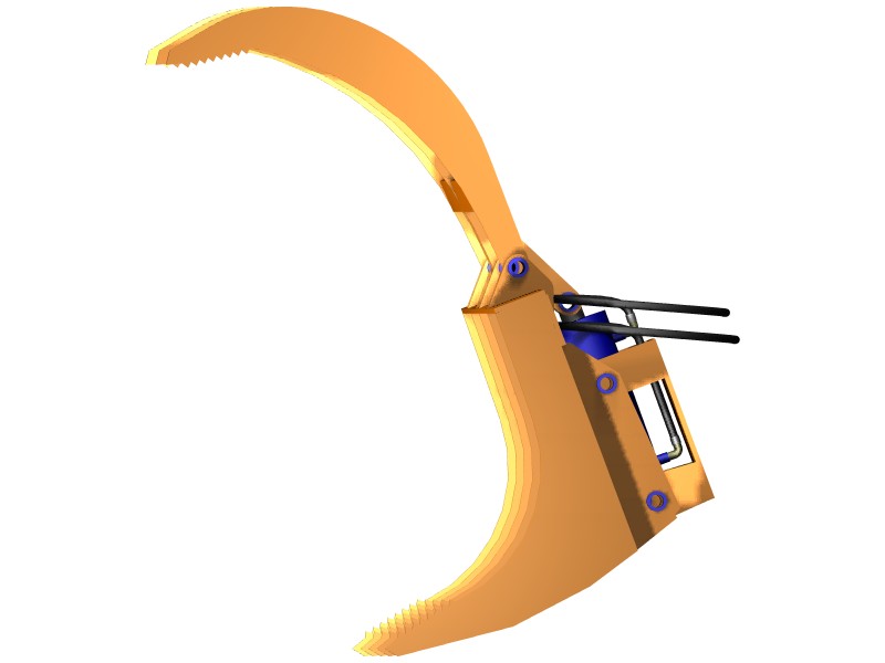

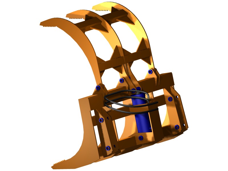

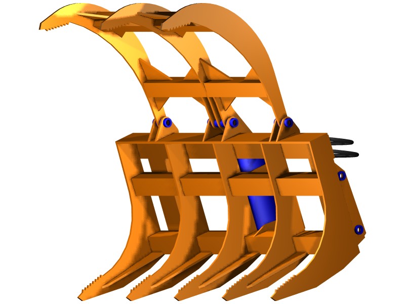

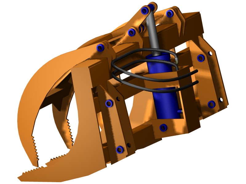

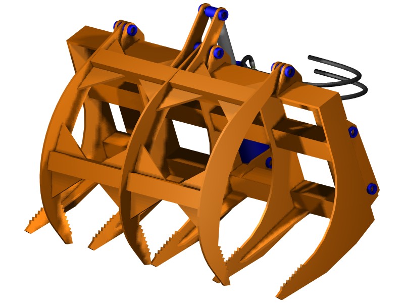

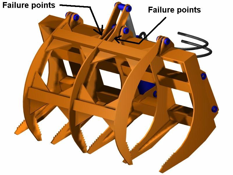

All -
With all of this talk lately of grapples (and just getting 40 acres clear cut), I'm interested in one too. I'd like to just buy one, but I don't have (or want) a QA plate, and it seems that most of the available ones don't use pins.
After talking with Melissa at Markham Welding, I'm strongly considering getting them to cut and weld my design. I'm not opposed to doing it myself, but I'd rather save the time (and get much better welding).
Anyway, one of the photos posted by a TBNer got me thinking about what I want, so I dusted off the ol' CAD program. Please feel free to comment on the design. Keep in mind that it is a 48" grapple for a 28 HP Kubota with the LA463 loader. Some key points:
- 48 3/4" wide
- 3/8" plate construction except for tubing
- Rake uses 3" square tube, 1/4" wall
- Grapple uses 2 1/2" square tube, 1/4" wall
- 1" pins throughout
- 8" stroke DA cylinder from Surplus Center
- Cylinder mounted behind rake for more protection, a distinct advantage over QA plate
- 100 degree jaw movement, opens to 46+" at tips
- Weight not calculated yet (I'm working on that next)
Questions for you to answer (I know I'm asking for it now...):
- Is it strong enough? I suspect yes, but you be the judge.
- Is it too strong? The loader is rated at about 1000 pounds lift, but curl (and ramming) forces are probably much greater.
- Should the grapple overlap the rake when closed (and loose opening distance)?
- What have I missed? Cupholders?
Regards,
- Just Gary

/ Loader pin root grapple #3
I really like the hydraulic cylinder behind the grapple, but do you think it will have enough clamping force with the cylinder attached so close to the pivot point of the grapple? If you think it will work, it looks great.

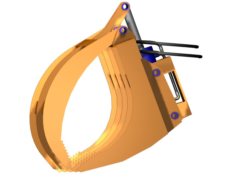

mjncad: I used TurboCAD V15.1. I'm not in love with it (mainly because they break things as they add new features, then make the users prove that it doesn't work any more), but it works for what I need most of the time.
L4400: At the risk of doing math in public, I'll try to answer the clamping force question. I'm sure someone will correct me if I do it wrong (and please do).
Cylinder diameter = 3"
System pressure ~= 2300 PSI or so on a good day
Fulcrum to cylinder pin = 5.17"
Fulcrum to grapple tip = 30.15"
Piston area = 1.5" x 1.5" x pi = 7.07 sq. in.
Total force on piston pin = 7.07 sq. in. x 2300 PSI = 16,257.74 pounds
Force at tip of grapple = 16,257.74 pounds * 5.17" / 30.15" = 2787.81 pounds
Dang. That's more than I would have guessed, and I wouldn't want my parts near it when it closes. Thanks for making me do the math. I'm still working on the weight.

/ Loader pin root grapple #5
That looks great! My only comment is to make sure the cage around the cylinder will clear the torque tube on your loader...I am pretty sure it would NOT on mine.
/ Loader pin root grapple #6
Yeah, it does look great. Your CAD drawings are awesome.
I was going to make the exact same comment that Kenny made about clearing the torque tube.
Other than that, it's fantastic looking!

Larry -
Thanks for the compliment. 3D is not hard once you figure out that the program wants to work with 2D at a time. You just have to remember to tell it which 2D you want to work with at the time (the workplane). Figuring out how to make a particular part is a trick too, but the 3D extrude and 3D subtract are my friends most of the time. Plates and pipes are pretty easy, since you just enter the thickness you want.
On the pivot forces, I have nearly 20 inches of weldable joint when you look at both the butt into the square pipe plus the two gussets. At 1000 pounds per inch of weld, that's about 20,000 pounds. Granted, the force is high nearest the fulcrum, but at some point the 1" pin will shear and I won't have to worry about the welds any more.
The weight with 3/8" plate construction is around 350 pounds plus pins, cylinder, and the cylinder guard (I forgot it when calculating). The guard could easily be lighter material, though, so I'm not too concerned about it. I'm considering changing the larger gussets to 1/4", especially on the grapple. I would like the weight as low as possible, but I don't want to turn it into a pretzel just because I abuse it (which I will, I'm sure). The factory bucket is 1/4 material, yet seems incredibly strong. I have not been able to bend it, despite years of trying.

Gary,
I was going to say what you said.
The pivot point (pin an hole) is the focus of all the stress. I'm of the opinion (instead of the pin shearing), the 3/8" thick brackets would tear through the pivot hole or bend first. But i really don't think it's a problem. I'd build it today.

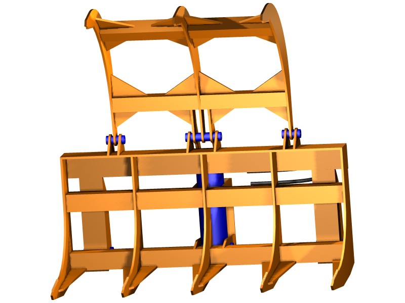

Rob -
All of the pivots will have 1/2" long x 1" I.D. 1/4" wall tubing (shown in blue) welded to the brackets to help keep the pins from ripping through. That is how my loader bucket is built (except on 1/4" plate), and it shows no signs of stress at the pins.
If you guys want to play with 3D, your programs should allow you to create a shape (like a circle or rectangle) and specify a depth for that shape. You may need to enable 3D first, but when you do you should be able to change the view to top, front, side, isometric, etc. and see the 3D part. Once you can do that, making more complicated parts just takes practice (and a little thought). Learning how to place parts next to each other by changing the origin point and using snaps comes next. Just work with it, and you'll get better. Ask questions, too.
I decided to model the cylinder and hoses when I thought about posting the design for you guys to review. I figured I needed to learn how to do a hose anyway, and the cylinder was pretty easy (it *is* made of simple cylinders) except for the fillet welds at both ends. I kind of just filled the space since it doesn't really show anyway. Besides, the more detail I add, the more you can review. The only problem is that it is not really Kubota orange...

Thanks Gary,
I couldn't tell if those blue objects in the pivot were pins only or pins and bushings. I was going to suggest using a bushing but you already thought of that.

3RRL: I knew at the time that the blue bushings would confuse someone, but left them blue for clarity. They do make a lot of sense though, because they distribute all of that point stress out to the flat part (plus provide a much larger wear surface for the pin).
I agree, very nice 3D renderings, JUST.
I use a cheapo program called DeltaCAD, but only for 2D. I never tried
the 3D capability. I am only using it to communicate with a CNC plasma
cutter anyway.
As for your design, you can increase the curl forces by using the larger
loader arm pivot spacings that your drawing shows, but you will have to
eliminate the links your FEL uses betw the curl cyl and the loader arm.
Make sure you allow for that or your grapple will not curl enough. I had this
same issue with my fork frame.
Your FEL bkt is 1/4" thick? You must have an HD bucket and they can be
very heavy.

dfkrug: I should learn to measure before I type. The vertical leading edges of the bucket are 1/4", but now that I have actually measured it, I see that the rest of the bucket is 3/16". I had always just glanced at the sides and assumed that the other parts looked a bit thinner because they were made on a metric roll...
That means that the pin brackets on my bucket are 3/16" also. I can see where I can lighten this design considerably by using thinner plate for most of the gussets. What I don't know is what grade steel Kubota used for the bucket. I'm assuming mild steel will do, except for the pin bushings.
I used the same curl cylinder spacing and angles as my loader bucket, so I expect the same amount of curl from the rake. I did bias the bottom tines downward just a little, because I'm OK with loosing a little rollback in favor of more "dump" so the grapple will have plenty of opportunity to pick up logs and other things on the ground. I'll check that again before I cut metal.
