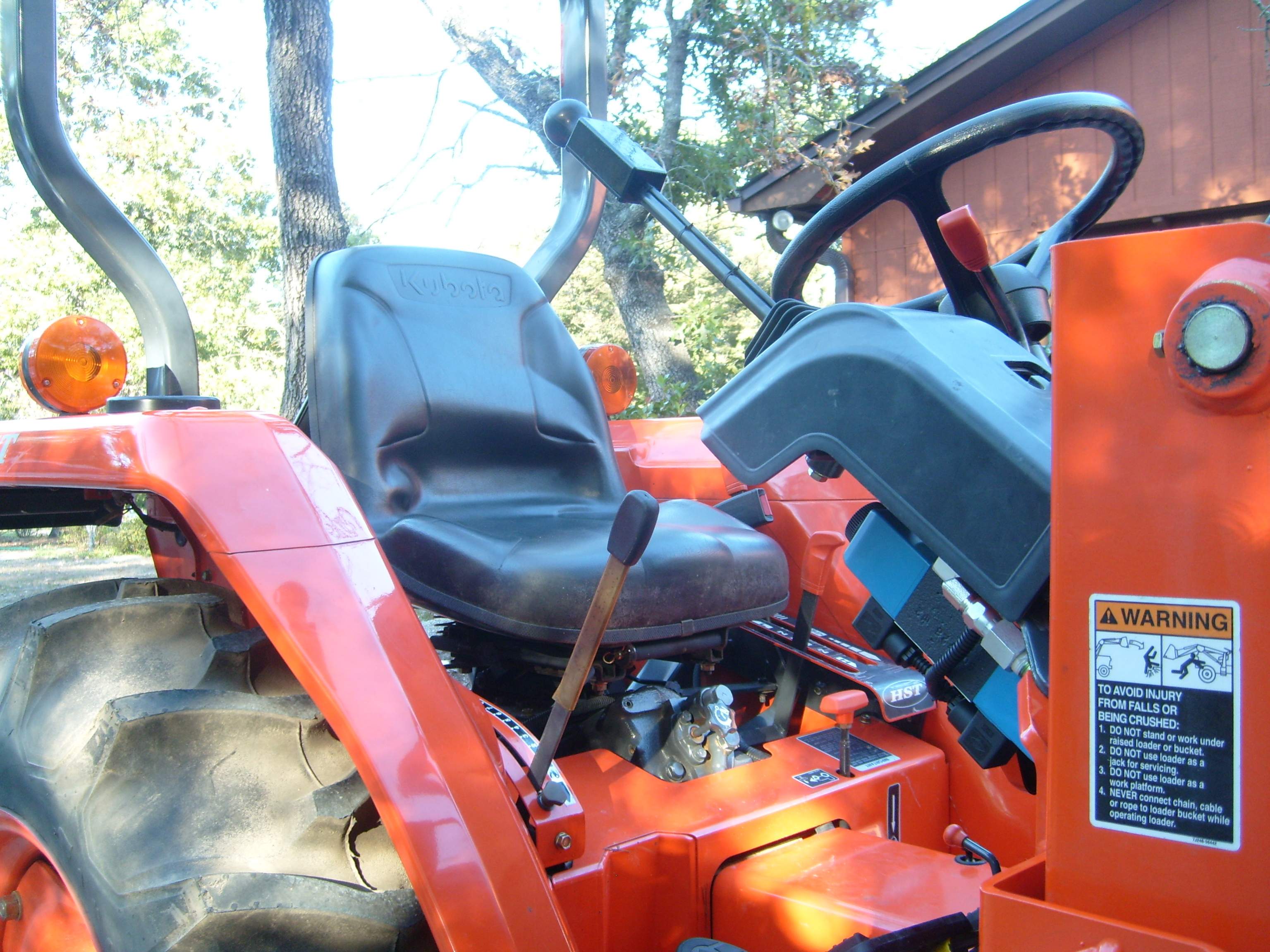

Progress on the rake/grapple has been slow lately, but I now have the tractor plumbed with an electric valve to power the grapple. Mrs3RRL did a great job of documenting her and Rob's work on their grapples, so I won't bore you with every detail. However, the valve installation went so well that I thought you might want to see how I did it.
After looking around for a place to put the valve, I decided that under the plate that holds the loader valves might be the best location. I didn't really want it under the frame because I figured I'd just tear it off on a stump or something. It ended up out of the way and still somewhat protected from the weather.
Here's the finished work. The A and B ports have QD male couplers on them, so when I get more time to build a couple of hose plates for the loader arm, you'll see two more hoses coming out of the valve. The good news is that everything is re-plumbed, so I finally got to change the hydraulic fluid this weekend. Read on to see the details.

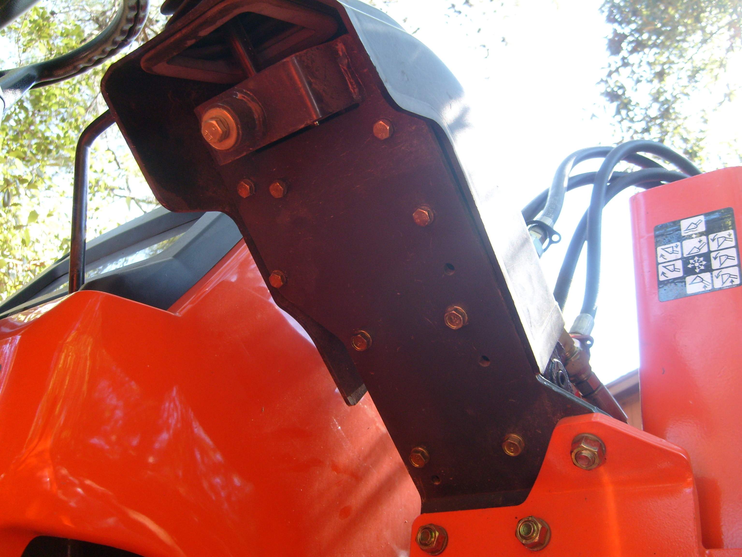

Here's a view of the bottom of the valve plate, plus a closeup shot. Note the two unused holes. I really like modifying things in a completely removeable way if I can, even if I know I won't ever remove it. Plus, using existing holes saves me the work...
All we have to do is dodge the bolts, and then the rest of the space is ours!

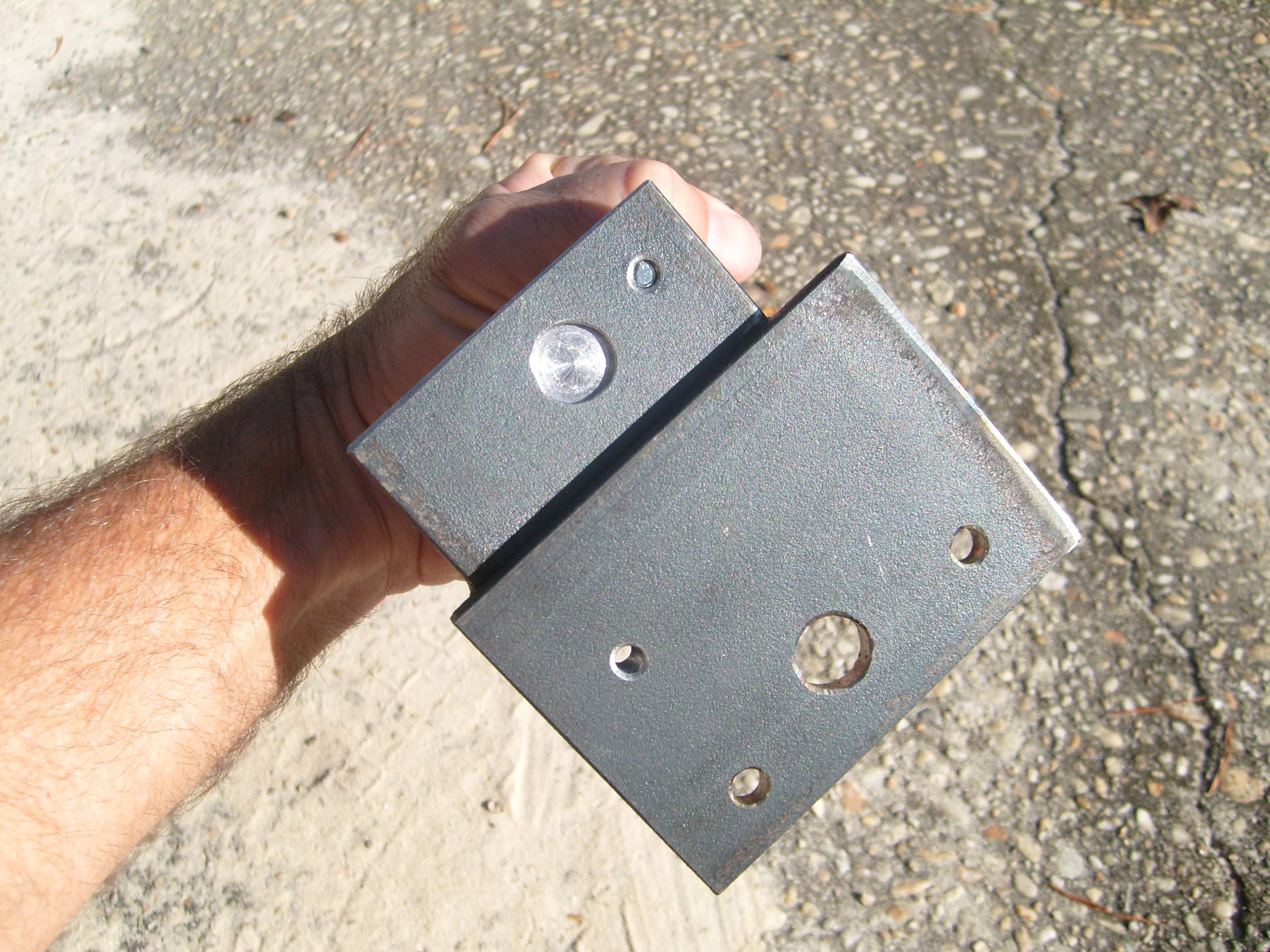

I knew I had that 3" X 1/4" bar of steel here for something. A few measurements, cuts, and holes later, and we're ready to weld the two pieces together. I needed two pieces because the 1/4" thickness didn't clear the bolt heads.
The two holes that hold the new valve's base are threaded 1/4-20. Note in the last photo that I had to mill a little bit away from the second plate to miss the other bolt head.
A note about welding: A few years ago I got frustrated trying to weld something and it dawned on me that all of the spitting and splattering was caused by water in the rods. Where I live, everything is wet all of the time. I took every rod I had and put them on a piece of aluminum foil on the gas grill. I turned on the grill, closed the hood, and let them cook for a few hours. I turned off the grill, let them coast for a while, and then dumped them straight into a large ammo can and closed the lid. Now when I want to weld, I get out what I need for that job and close the lid. Welding is fun again!
A note about milling: I have still not sprung for a real machine, but if I can mill something like this, you can. I use a 1958 ShopSmith model ER (way before the Mark V). By keeping the quill in close to the frame, I can control the spindle and table slop enough to do small jobs. Use high speed and very light feeds. I bolt a cheap chinese cross-slide vise to the table to let me do slots and other simple cuts. Use what you have, and be creative. You may put an eye out, but you'll probably at least survive...

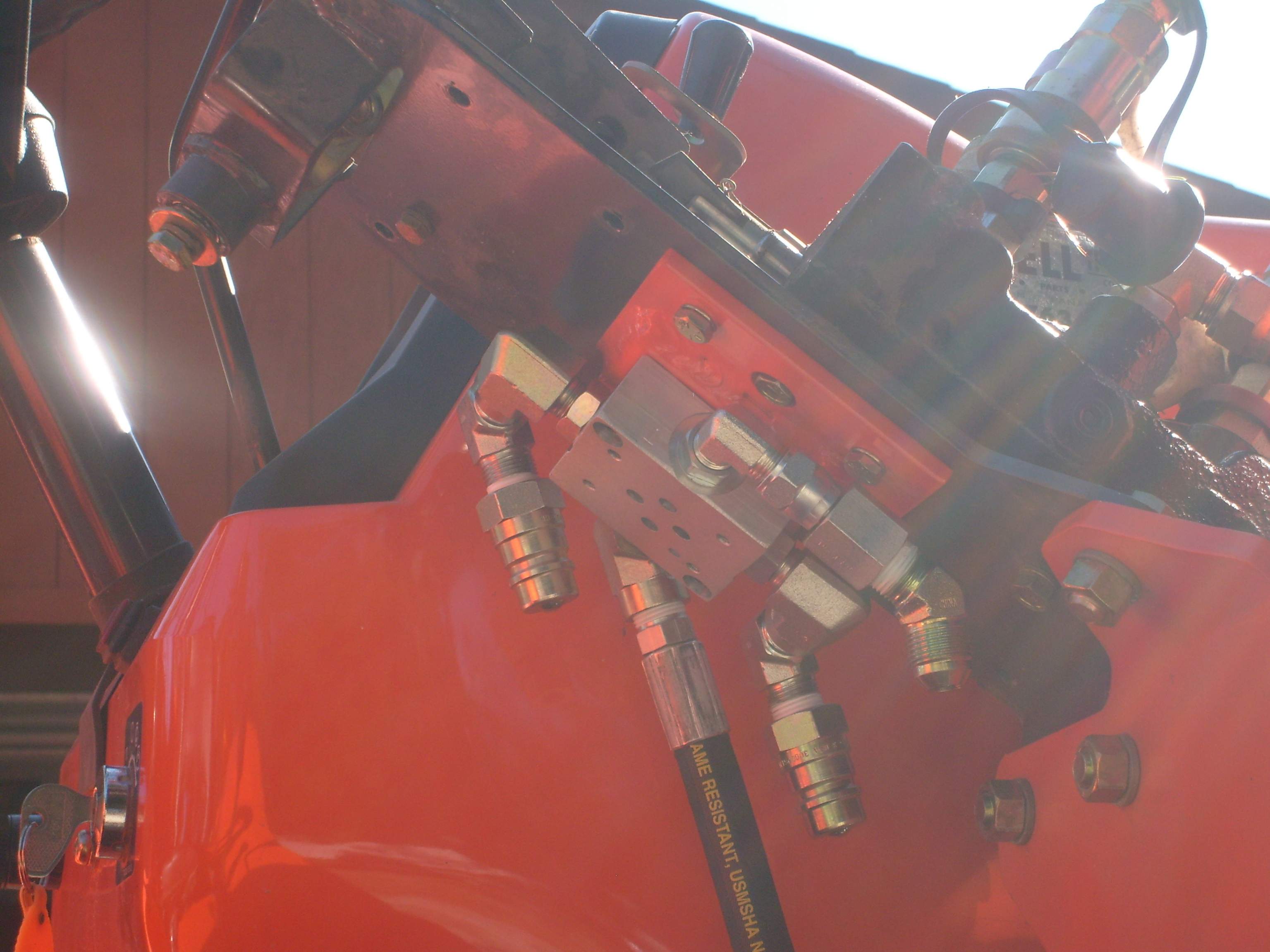

Sorry, but I thought I took a picture of the bolt plate after I installed it, but before I put the valve base on. Anyway, I didn't have any gray paint, so I used the trusty Dupli-Color #1620 "Chevrolet Orange" that I keep around. It matches the original paint incredibly closely.
So here you see the valve base plumbed with QDs on the A and B ports, the P port ready with a hose to go to the Power Beyond output of the existing loader valves, and the T port ready to take the hose that comes from the Power Beyond output.
The last photo shows the valve installed also. Progress!

No leaks!
Actuating the valve with a spare battery demonstrated that everything works (including that cool orange ram) and the transmission didn't blow up. Time to wire it all up and move on with life.
The runt, Ben, is demonstrating that size 14 flip-flops will easily fit on the brake pedal with the valve installed. Honestly, with the hydrostatic transmission, we pretty much use the brake only when the tractor is loaded onto the trailer (yes, plus grade 70 chains).

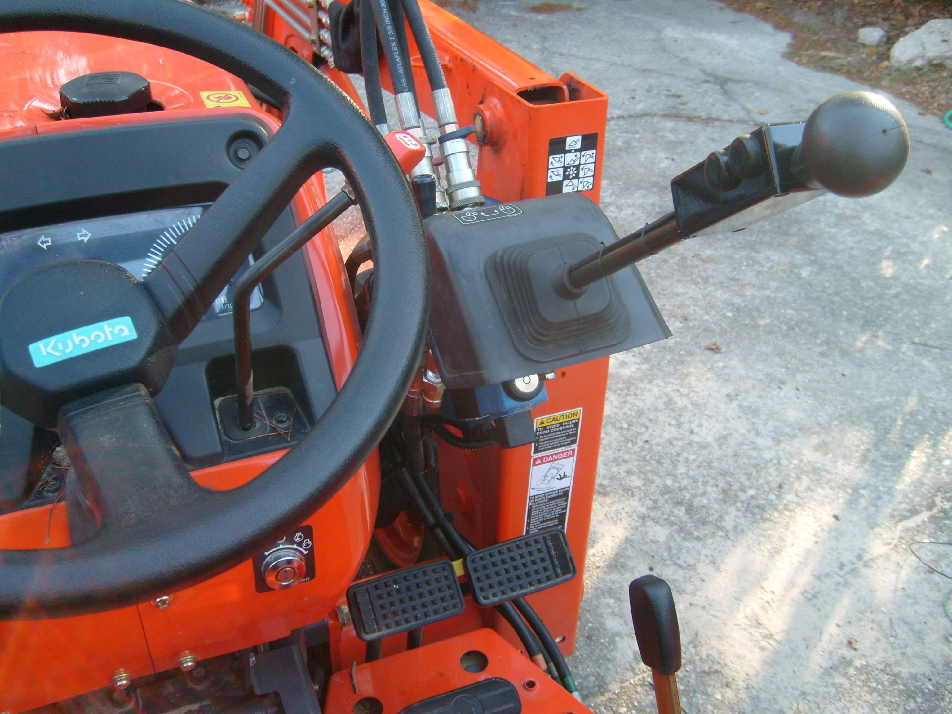

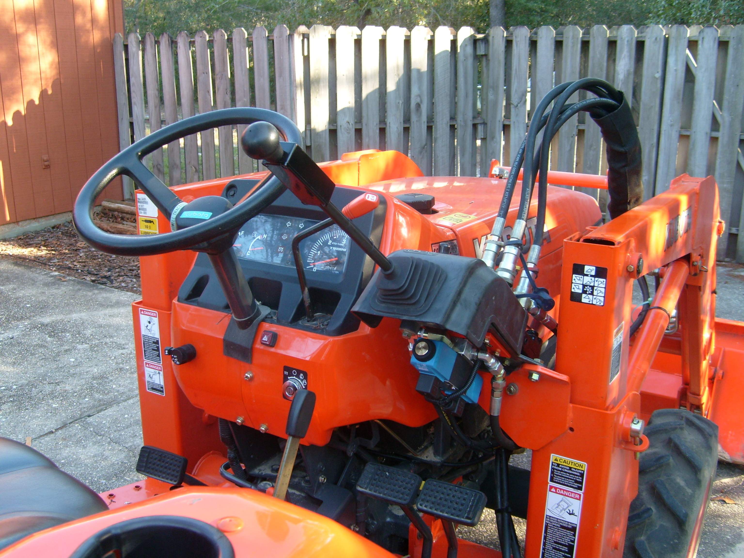

Back to the new valve...

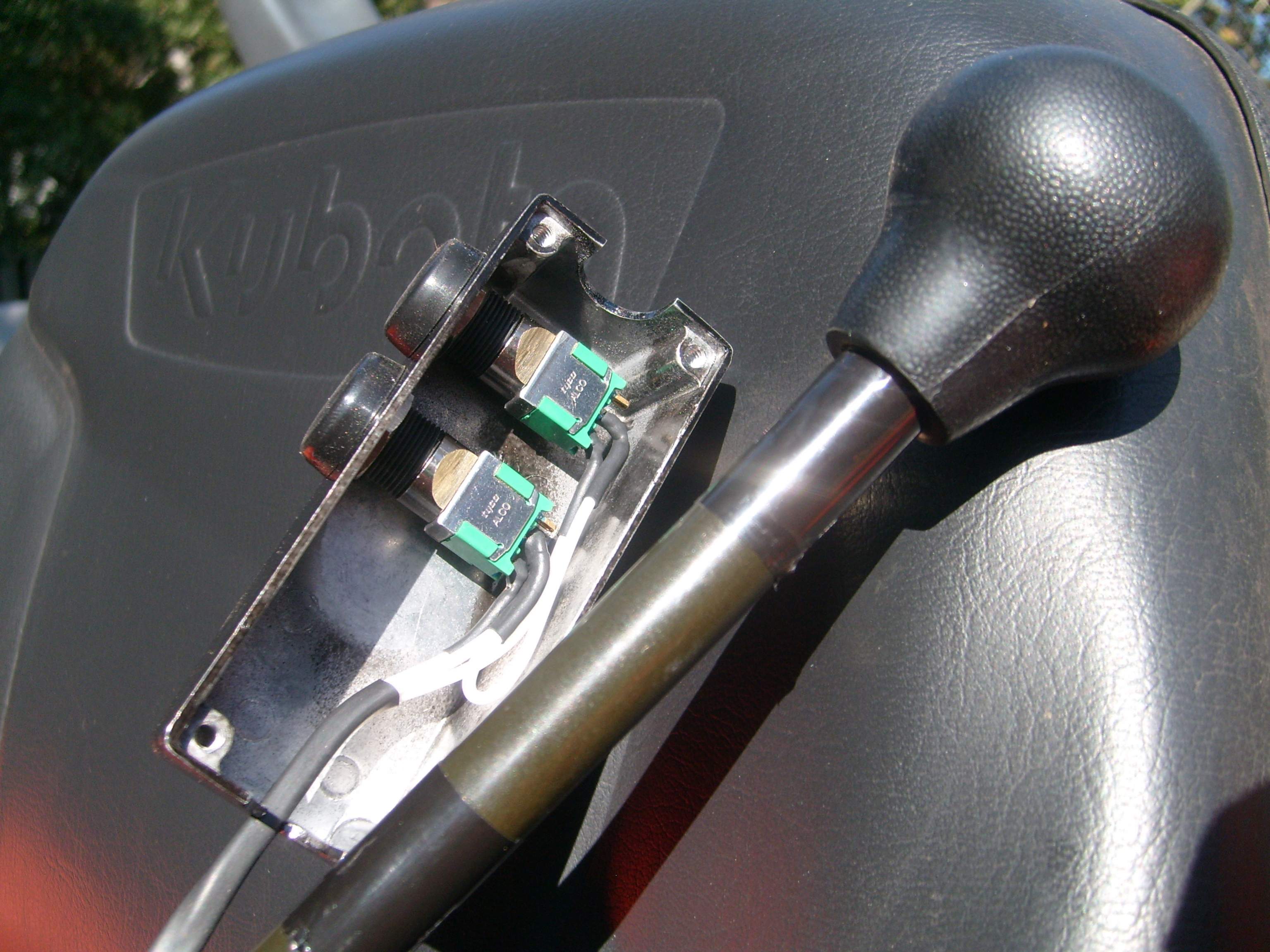

I burned a lot of brain cells wondering how to mount switches on the joystick. The best idea I came up with was a pool ball drilled to mount on a shaft, and mill a cavity in the side for the switches (on a flush-mounting plate). The wires would run through the shaft and come out just above the valves.
Well, what stopped that was the facts that: 1) The existing loader stick has a 1.1" square base, and I don't have any stock over 1"; and 2) The square base has a threaded hole in it for the ball joint for the lift function. Did I mention that the hole is threaded? It's metric. Oh, and 3) I don't actually have a pool ball. Especially not an orange one. Three strikes, I'm out.
But we do have a few small die-cast Bud boxes at work...
Two "sealed" switches with "sealed" caps and a hank of teflon wire for durability, and we just might have something. The box is drilled on the ends to snug against the shaft, and an extra hole lets the wires out. Some heat shrink tubing will keep it tidy. I didn't seal the box, because the water will get in anyway, and I want it to drain. Look at all of that spare room! What else can I cram into that box?
At first I just tied it all up with braided cord, but then decided to use split loom to cover the exposed wires. It looks better and keeps the wires safer. I tapped off of the "work lights" fuse since I rarely use lights anyway. I brought the return side of the solenoids back to the fuse panel also, and lugged it to the frame where Kubota already had a ground wire.
A note on the "Hirschmann connectors" that plug into the valve solenoids: I didn't see any reason for the connectors to point toward the ends of the valve. I turned the inserts around so that they would point inward, making the installation a little more snag proof. The inserts have cutouts for the wires, but the ones I used (18 gauge) fit over the back of the inserts just fine.
I'll have to get used to having a box on the joystick. The buttons are close enough to be easy to reach, but far enough to stay off of them unless you mean to push them. It's ugly for sure, but it works!

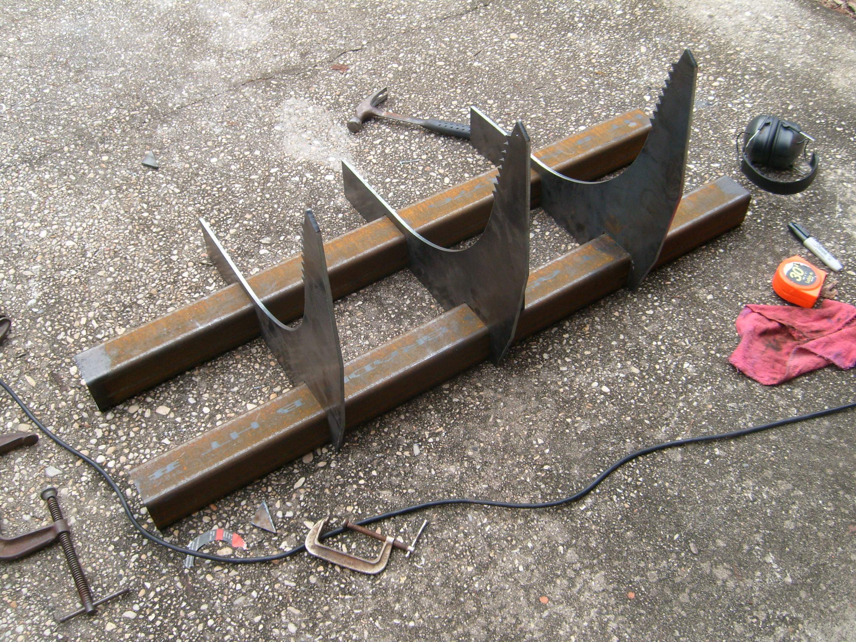

Wow! By some coincidence, the last post to this thread was exactly a year ago (where did the year go?). I bought a mill last year and have used it for many things unrelated to my tractor. Anyway, I have finally gotten back to this project and have an update.
Last month I found someone to plasma cut the parts for me, so I now have everything I need except for the pins. The rake is tacked together, and I'm working on boring the holes for pin bushings in all the parts that need them. I'll tack the grapple together after I get the bushings in place so I can hold it all together with pins while I weld it.
A few changes:
- I decided to go with 1/4" A572 grade 70 plate instead of 3/8" A36. This will save about 33% of the weight while providing about 30% more strength.
- I decided to go with 3/16" wall A500 square tube instead of 1/4" wall for the same reason.
- I changed the angle of the rake slightly to allow less tuck and more rollback.
- I extended the rake braces to nearly the tips of the rake teeth to help keep everything solid, especially with the thinner stock.
- I sloped the braces downward about 10 degrees to help shed dirt as the rake moves through the soil.
I think that since my tractor has limited lift and breakout strength, I should be OK with these changes. After spending a few weeks pushing out Yaupon with my standard bucket, I am confident that this will work fine. Only time will tell, though.
I'll post more pictures of the progress if you are interested.

So I was out in the shop boring holes for the pin bushings when the phone rang. When I went over to the corner to answer it, I almost tripped on part of the junk pile. And what did I trip on? Of course! Those two old shock absorbers from the F-150! I kept them rolling around on the floor for about ten years because they have 1" steel rods that I "might use one day..."
Today I cut them open just below the top weld. That turned out to be a great place to cut, since the top will then pop off and let the inner tube and rod slide out. After pouring out the fluid (which does seem to mildly irritate skin, by the way) into a container, I found out that the valve at the bottom of the inner tube just pops off. The result from each one is a 1" pin roughly 15" long, with a ring welded about 5" from one end.
I now have two long pins to use for alignment purposes while I weld up the rest of the grapple. I'm strongly considering using them for the actual pins when I get to that stage. I suspect that they will be strong enough, but maybe you guys know better. Any reason I shouldn't use them as pins for the grapple? Note that I only need them for the grapple and cylinder. I will use the stock Kubota pins from the original bucket to pin the rake to the loader arms.
