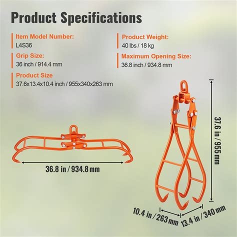

Anyone have/use something like this? Any good?
/ Loader Log Grapple? #2
I don’t like things that are an assembly of small parts bolted together, but try it.
Thats not a lot of money, but I bet they take it back if it doesn’t work.
I have something similar and it’s less parts and welded steel
/ Loader Log Grapple? #3
So he has no money to lose then, just time invested.

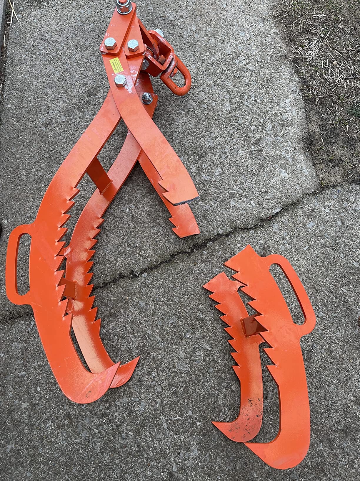

Looks like someone found the limit, of one of them. There are many others to choose from though. I could weld this back up...

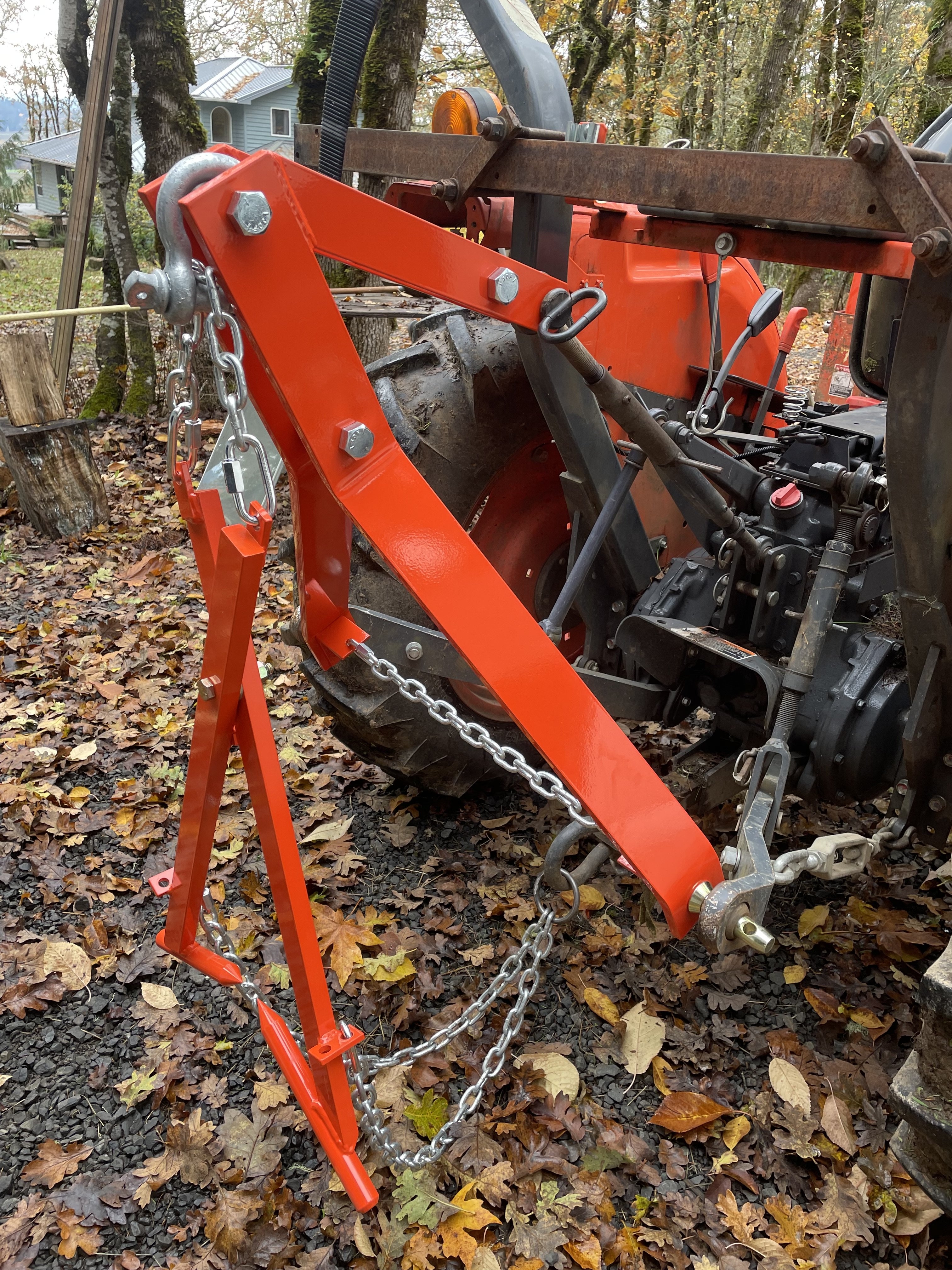

I use it with 3 pt to drag things. For lifting i use clamp on bucket hitch receiver with ring. Not easy to find center of weight for long items but works ok
/ Loader Log Grapple? #12

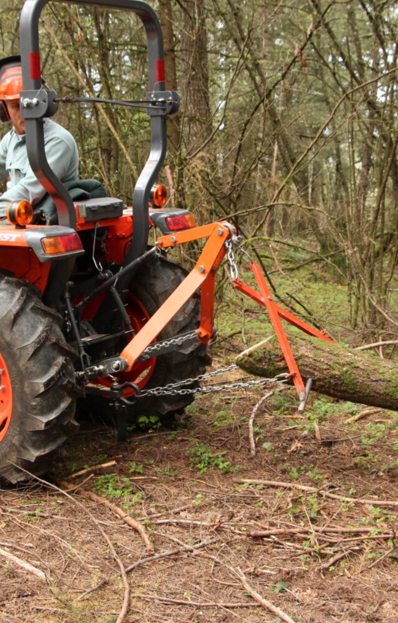

The bucket grapple would have to be used on level ground with a farm tractor. The higher the bucket is raised,the more unstable the tractor, if the log gets to swinging all bets are off.
Now the 3-pt skidder attachment I like, but I use a log chain around a log and 3-pt drawbar, lift the log enough to insure traction and pull. It takes longer but it's safer with the tractor end of the log only 6" off the ground.

I think a problem with the 4-point tongs, which is basically two two-point tongs offset from each other is that you're likely to torque them.
I got this simple two-point tongs (https://a.co/d/eWFJuF5)View attachment 2834689
mostly for lifting big rounds and for very occasional skidding logs. My unit seems very solid and so far worth it, but you definitely don't just lower it and expect it to grab - a grapple it isn't.
/ Loader Log Grapple? #15
Honestly reading the reviews gives me more pause.
The first may be legit "Solid build, no issues"
The others though talking about "the upgraded handle" like the reviewer bought the previous model and it sucked but this one doesn't? no
so out of 6 reviews there's maybe - *maybe* - one from a taciturn user who didn't give any specifics
maybe if you find another listing for something similar where you can believe the reviews are from real users (with believable in-use pics hopefully) then consider it, but as previously mentioned I think the 4-point tongs have a serious weakness in stability between the two sub-units
