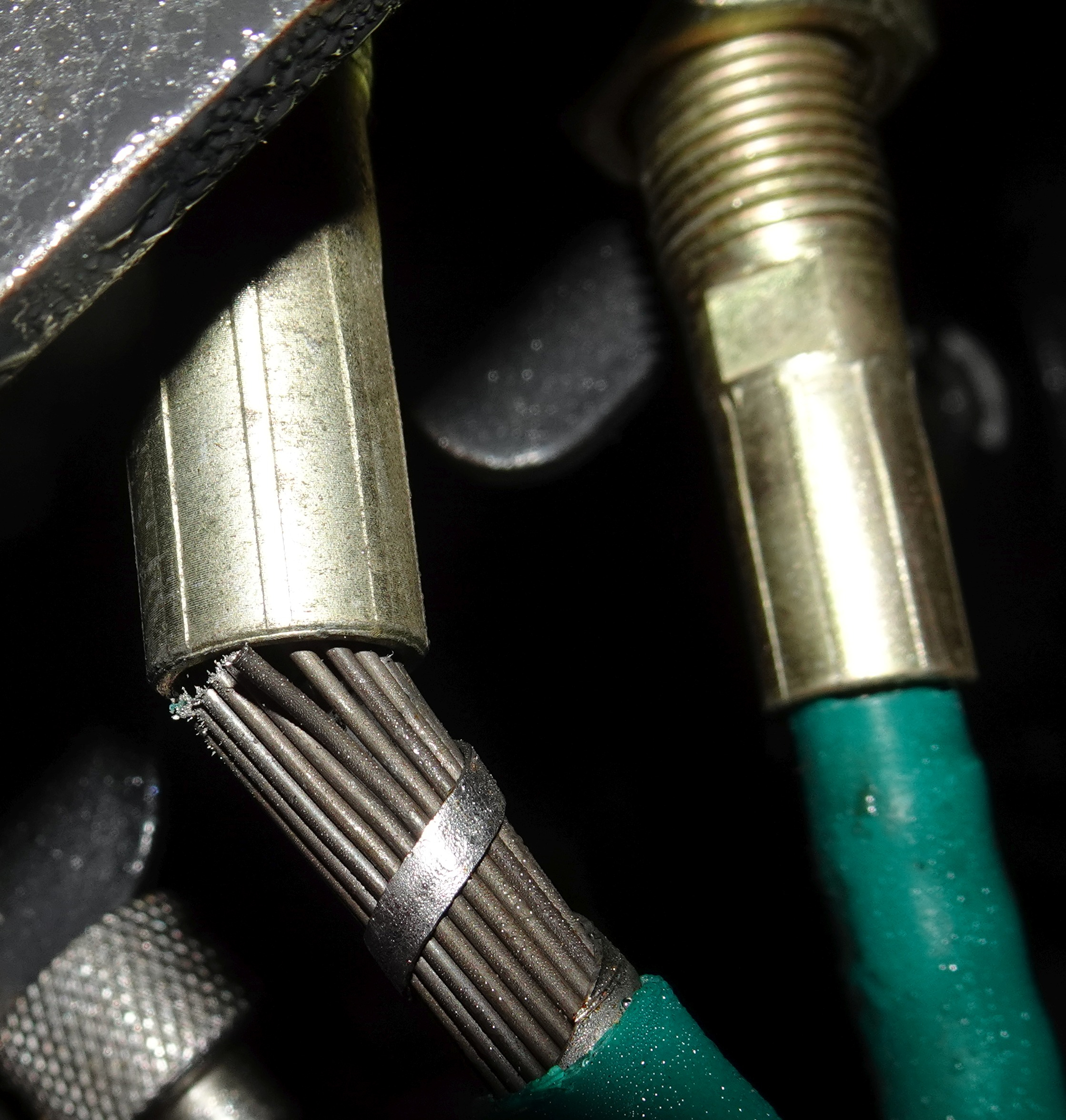

You can see the problem in the photo, it's a 3520H. It's the bucket control line, I can curl in but not out, at least I don't have to worry about the bucket falling to the ground.
OK, this may be a monumentally stupid question. I've read a number of threads here about replacing the cable and it seems like it ain't exactly a piece of cake. Considering what you can see here, would it be possible to weld the thing well enough to work? I have no experience with this stuff so please don't laugh too much if that's an idiotic idea. The last 4 or 5 times I had the tractor out, the joystick was kinda stuck, didn't want to move to the right to curl out, and I sorta hit it, with my hand and not very hard at all, and that freed it. I should have stopped using it and figured out what was going on.... Thanks for any info.

That is unfortunate for sure. I can not think of a good way to fix that cable. Replacing the cable may be somewhat of a pain but I think less of a pain than trying to fix that one.
/ Loader joystick cable break #3
I think welding it would do more harm than good.
I don't think the rest of that area would take well to that much heat being applied there.

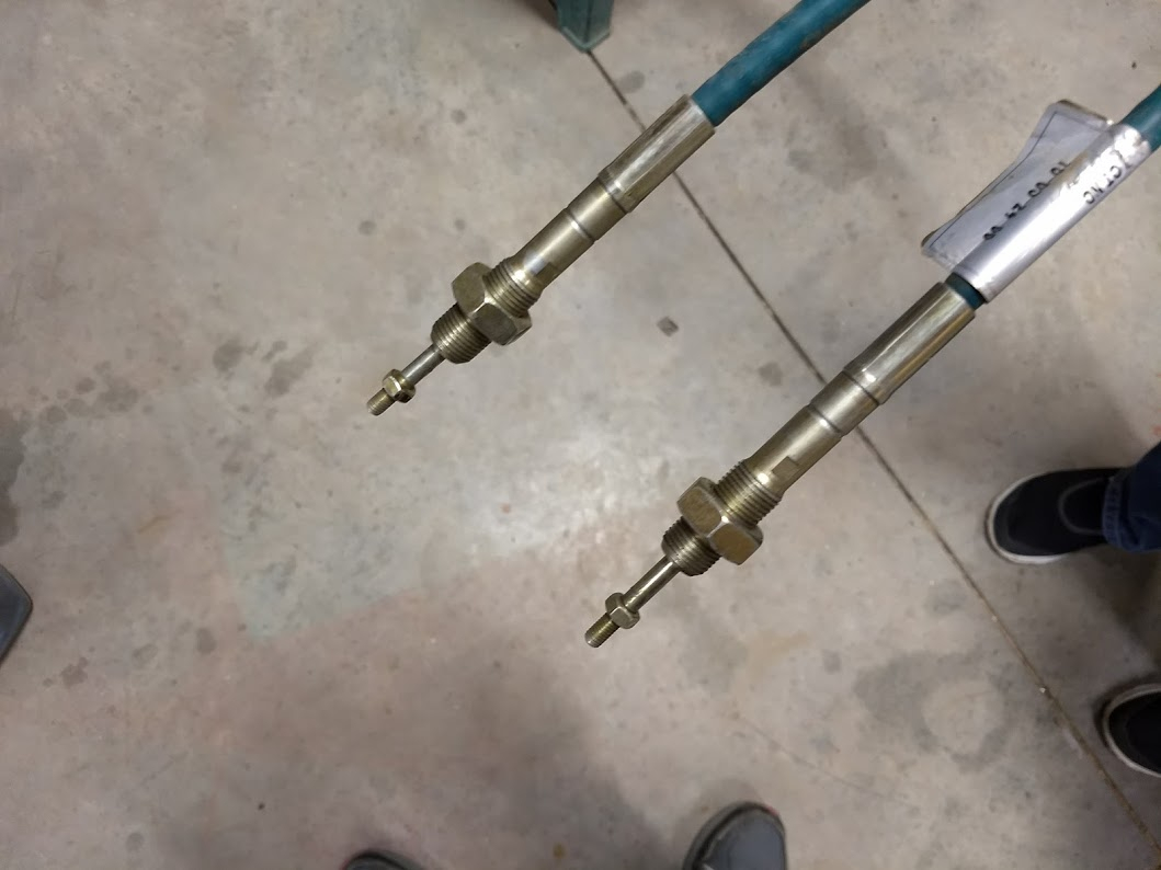

It would just be the cable ends getting hot. From another thread, Cougsfan posted this photo. My thinking was to just turn eveerything right at the junction of the end piece and the cable into one chunk of metal. And add in the usual massive grinding that comes with being the expert welder that I am.

I would just put it back together and crimp it. But I have the tools to do it.

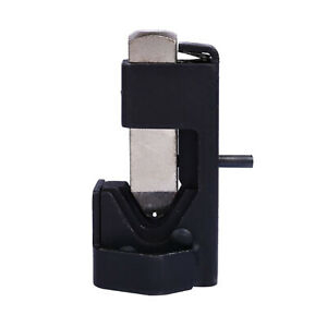

Thanks for the replies. I have this thing that's for crimping huge electric wires, could you do an adequate job with that?
I haven't taken it apart yet so I'm not even sure what the cable end looks like. Is the threaded part attached with some kind of sleeve to be crimped or is it one piece and is it a standard that can be purchased?

If you look at my photo, is the outer shield that band that looks like it got ripped that runs across the middle of the bit of the cable that's visible? The kinda brass-colored metal looks like it's a crimp, but that isn't the crimp to the cable right? Or are you saying that the crimp is to that sleeve? I'll have time later this PM to mess with it so I still don't know what I'm talking about.

I would not think of welding or soldering on that cable.
I could be wrong but I believe that the outer jacket is supposed to be secured by the compressed piece NOT the inner cable,
the inner cable has to be able to move inside the fixed outer jacket.
On my cables the joystick end terminates in a ball that the control yoke pulls and pushes on and the other end of the inner cable has a small threaded end which attaches to a clevis which in turn attaches to the valve spool.
Both ends of the outer jacket are secured which allows the inner cable to move back and forth.

Lou your description is correct. That looks like "compressionless" housing- instead of the metal wire in the housing being a spiral, which compresses, it's mostly parallel wires. I've used a smaller version for bicycle derailleur cables. This one looks like it's got a thin spiral on the outside to help keep the housing wires in place.
It's hard to tell from the pic if the housing wires broke in the ferrule or just came out. If they came out then maybe you could carefully epoxy them back into place. Ideally with the cable removed so you don't epoxy that in there by accident. I'm not sure the cables are easy to remove from the housings though.
I think you'd do better to replace the cables and housings as a unit. Surplus Center seems to have some that might work. Also these folks: Koyker Loader Joystick Replacement Parts

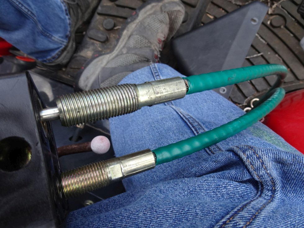

Ok, I did a little more disassembly but didn't get far. See pix. I got the threaded piece off the housing on the broken cable, I could turn it by hand, but the non-broken one won't turn very far because it's constrained by the green sleeve which seems to have a metal inner sleeve. I think the threaded part is supposed to be separate from the bit that looks like it's crimped onto the green sleeve an likely metal inner sleeve. See the photo from the Short line. I didn't realize it when i was out there messing with it. It has to be separate or else there's no way to get it assembled, you could do one by spinning the housing but the 2nd one would bind.
I may have another problem because if you look closely, you can see the cable between the green sleeve and the metal which I guess is the ferrule? In the first pic above, you can see there is a metal inner sleeve that is torn, so I think I should see that metal sleeve instead of cable. I need to get the cable out from the housing so I can see exactly how it's broken which means getting the balls out of the triangular joint thing, but, yeah, it ain't easy, probably impossible without getting the bit with the ball well out from the housing. I've about used up my reserve will to live for the day so I'll have another go tomorrow. The 2 on the left are Short Line.
