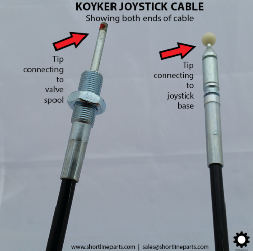

valve end:
joystick end:
I saw those but the joystick didn't have the allen bolts as shown. I rewatched it after seeing your previous post and it made me think I must have missed something and I did, there's a lot of circular recesses on that damn thing and I probably didn't have my glasses on but there is bolt down inside one of them, it was late yesterday evening and I haven't gone back to work on it yet but that will probably do the trick. Thanks.

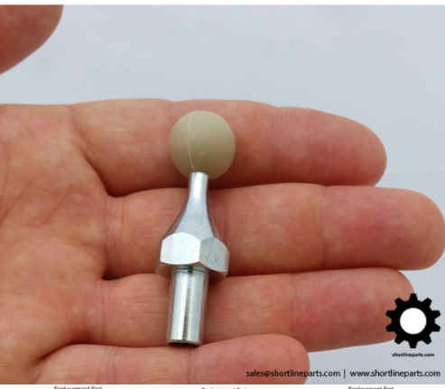

After another trip out to the shop to look at the parts, I have found out more. The sheath is made up of more items than I mentioned. There is the outer rubber casing. Beneath that is the spiral wound metal. Beneath that are a bunch of longitudinal wires laying in a circular pattern that you are assuming are the inner cable. That is actually part of the sheath. The inner cable is actually a solid metal (not woven wire) similar to what I have seen on some emergency brake cables.
So I doubt your ball end is broken off and it is still just your outer sheath that needs to be reconnected.

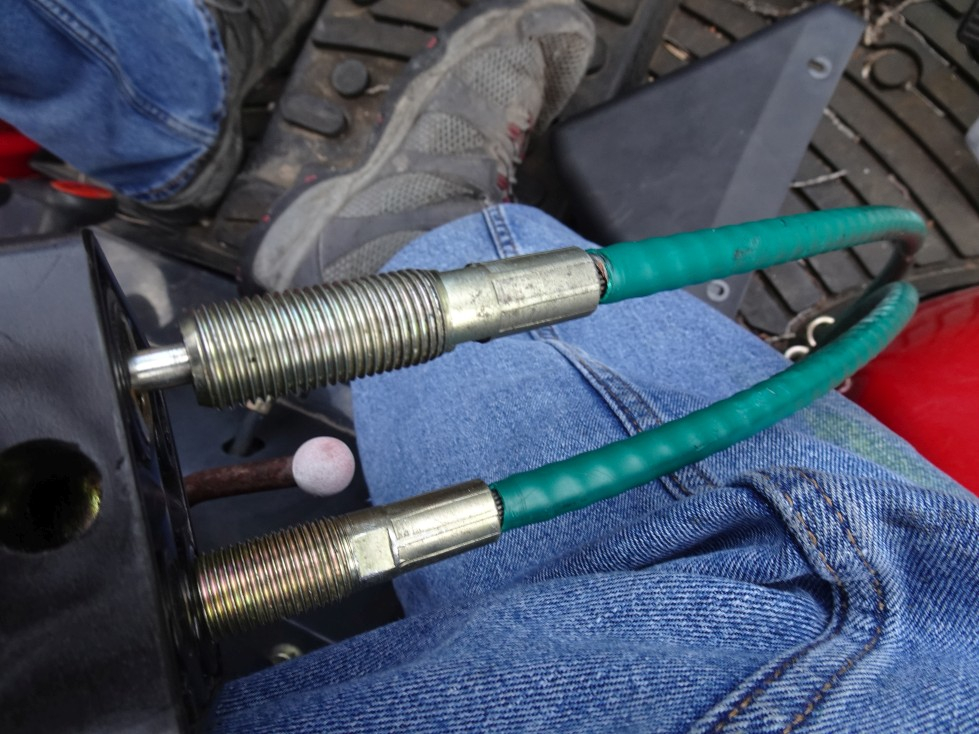

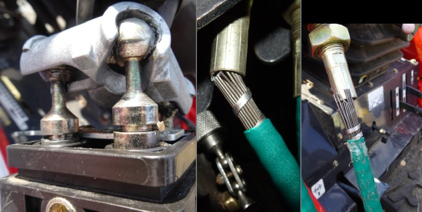

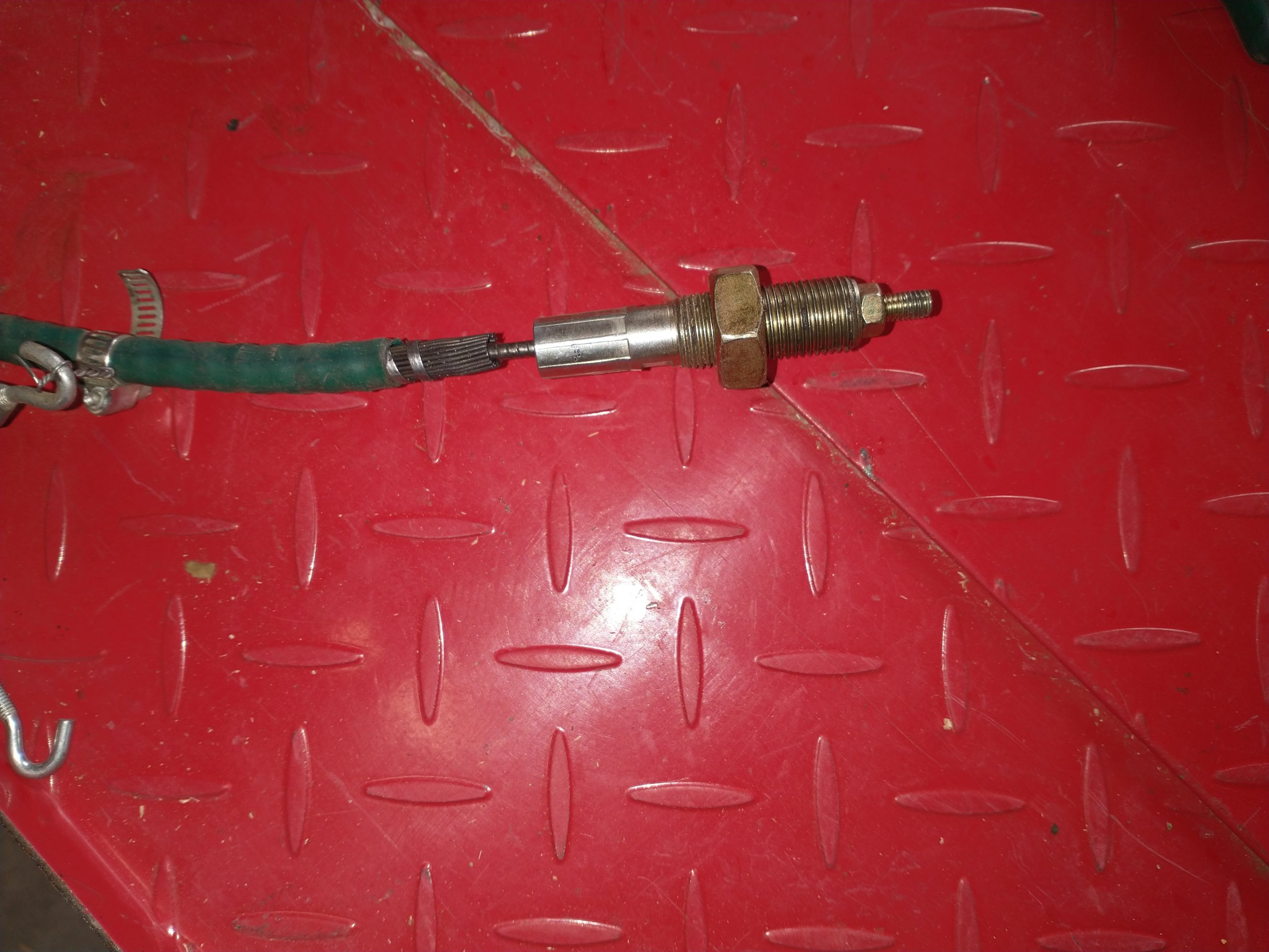

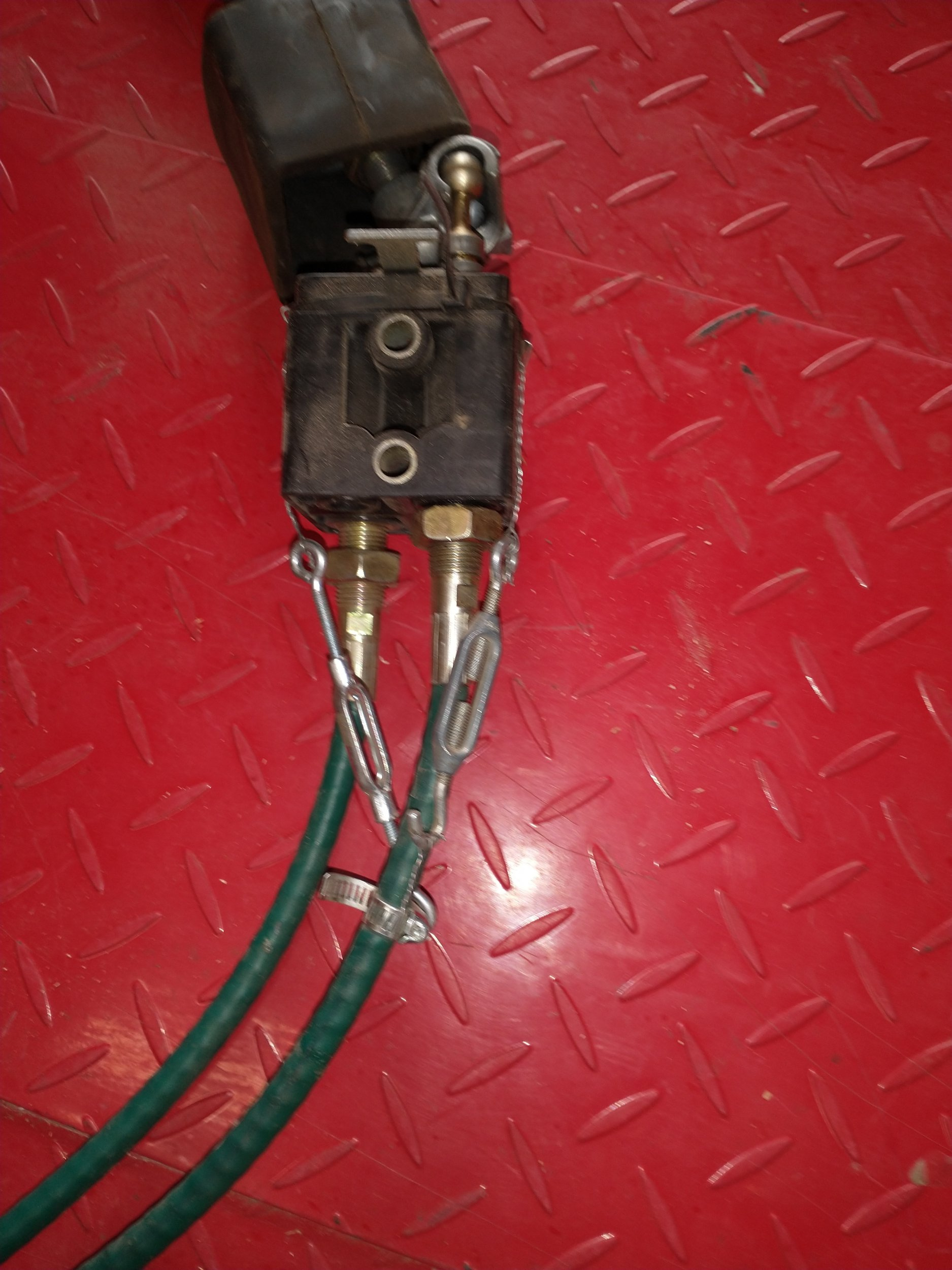

Here are three pictures that help illustrate the situation.
The first picture shows my jury rigged solution to hold the sheath in place. It actually worked for a couple of months until the new joystick/cable arrangement came and I found time to change it. With hind site, there are better and more permanent "jury rigs" I am sure.

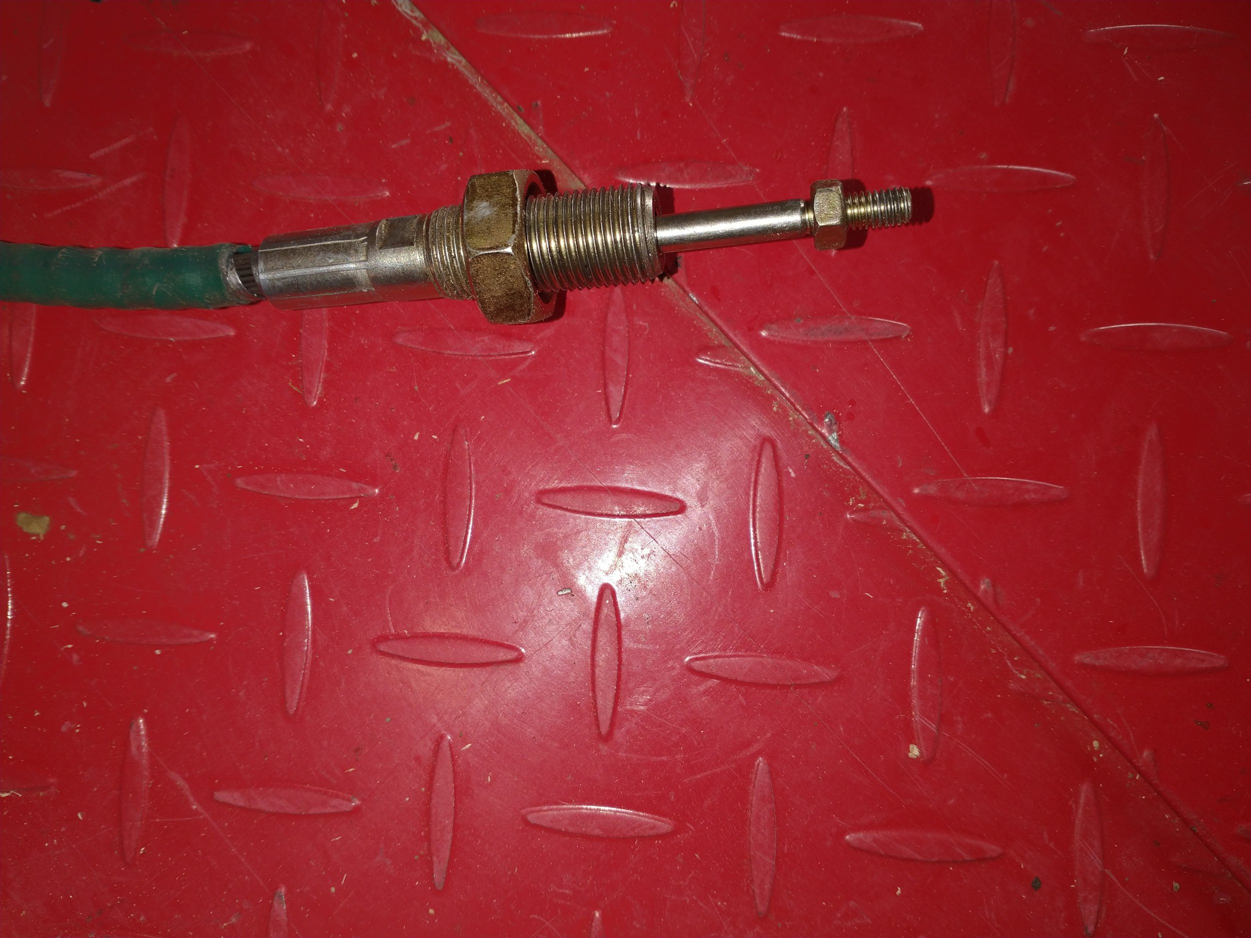

Picture 2 shows the cable removed and the sleeve pulled back. Notice the sheath construction of straight wires surrounded by a spiral wrap covered with rubber. Also notice the inner cable construction of a spiral wound metal band.
Picture 3 shows the sleeve pulled into position. At the end of the inner cable is a threaded rod that screws into the ball arrangement on the joystick. I seriously doubt this metal rod has came detached on your cable. I think everything on mine looks similar to the situation you have.
More notes: I doubt very seriously that you can even disconnect the cable from the joystick without also disconnecting it at the other (hydraulic controls) end. And I am still not sure how you would disassemble the joystick. I can now see why Branson sells the cables/joystick unit as one item and not separately. The whole arrangement is so esoteric and complicated, the average mechanic could probably not change a cable alone without a great deal of frustration. I highly suggest you try my solution of a plastic tubing sleeve clamped in place to hold the sheath to the sleeve. Use 4 miniature clamps just to be safe (2 on the sleeve, 2 on the cable. All as close together as possible.) This can be done with the cable in place and no disassembly. Otherwise you will have a major jigsaw puzzle type of repair that would be difficult to re-adjust correctly if you did figure out how to tear it all apart..

You gotta get the cable out and on a hard surface to use that crimper. If the cable needs to come out of either replace or try. Drilling some holes in the crimp area, put wire back in, crimp a bit then weld the drilled holes to the cabling.
I don't think I would try to crimp it. (Just my opinion). Tony is right, you'd have to get the cable out to crimp it, which is a sizable hassle. Second I would worry about binding up the inner cable from crimping enough to make it hold. Those inner wires on the sheath are loose and are not bound together by anything by the spiral winding that is now compromised, so they wouldn't crimp well)
But as Tony suggests; drilling holes in the sleeve and welding (or soldering might be preferred) the wires to the sleeve may be an excellent solution but has risks involved doing it right, (would take a fairly high level of skill to not over, or under, apply solder) and also likely requires cable removal. I'd probably do that if the tube and clamp method failed. Asteral may help us on this, but I don't think you can buy a cable alone, which makes repair a more desirable option unless money is no object. Good luck and keep us posted.

Thank you, that is a big help. You definitely can't get the cable/ball assembly out without disconnecting the other end. I was thinking removing the hex bolt that screws in from the bottom where the cables enter would somehow let that happen but it only does something to the pivoting ball that isn't connected to a cable. Disconnecting the other end allow you to slide the cable in enough to get the ball out of the Triangular Joint as Short Line calls it. It's described in a writeup by dhattaway here which I had read and promptly forgot that rather crucial tidbit.

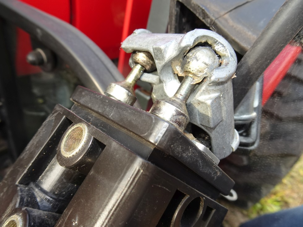

I tried the plastic tubing thing and it didn't work but only used a pair of clamps and plan to try again as another issue popped up. See photo, the one in the middle is how it looked when I first had the problem, since then it all got messed with in various ways. When I tried the tubin g fix, I tried to make sure the cable-looking sheath ends were in the ferrule as well as I could but when I disassembled the tubing/hose clamps, the cable had slipped down and up with some strands outside the ferrule. Not sure how that happened. One issue I didn't think of at the time is the correct length to screw the ferrule back into the body and also, I need to make sure the ball is set so that the locking slot is aligned, in the left photo it's clearly not and I'm not sure how any of this was exactly set when I tried the fix. See the videos, taken after I disassembled the tubing but I don't think it behaved much differently with it on. There's the play in the side-to-side [curling] direction and you can hear the way it sounds when I try to uncurl, there's a decided 'thunk' sound, it's a hard stop, not sure what to make of that.
So what I'm going to do is try the fix again with 4 clamps, making sure the ball slot is aligned. use a lot of clamping pressure as per your suggestion, and think about welding/soldering/brazing as plan B or C or whatever. My welding skills are best summed up by saying I've become an expert grinder, but the way this looks is actually something I'm more likely to do well, it's precision and steadiness of hand that are beyond my abilities and this would probably be best done with short small-area welds. The video has 'stabilized' in its title for a reason, it was my second attempt and was stabilized in Premier and it still sucks. Appar3ently, youtube does its own stabilizing and better than Premier. I'm putting both here because for some reason there's no sound on the premier edited version. You wouldn't want to see the actual original.

I wouldn't recommend operating that joystick with that cable sheath out of the sleeve. Once you bend up those wires in the sheath the game for repair is probably over. You have to get it all back together and at the same length as it was originally, and come up with a way to hold it there.
/ Loader joystick cable break #38
The cables are pull/push. So not only do you need to get the housing properly seated in the ferrule, but you need to get it to stay in there when the cable is being pushed and the housing wants to pull out.
