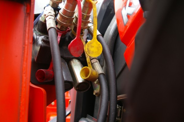

Could anyone advise me on this problem with my B7800/LA402?
When the temperature is below freezing, It is either difficult to get the loader control into the float position or if it goes in it will not lock in the float position (I have to hold it there). My suspicion is that there is a little water in that part of the system and it is freezing. In fact, if I take my wife's hair dryer (with her permission, of course!) and heat it up, it will work. But once it is shut down and sits in the freezing weather for a while, the problem reappears.
Any suggestions? The tractor is coming up on its 300 hr service that requires changing the hydraulic fluid. Is there anything special I should drain during that operattion?

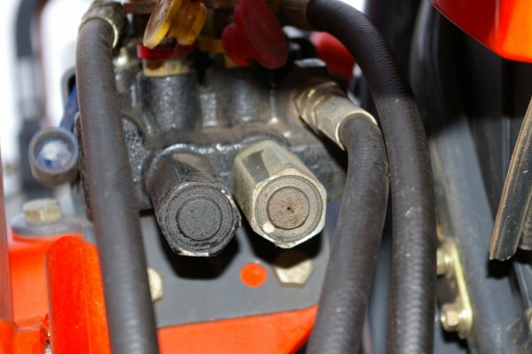

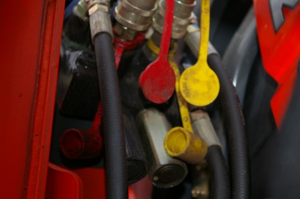

I think you have water in the valve. I had the same problem with mine when it was under warranty. They replaced it with one with a hole in it so the water drains.

/ Loader "float" freeze-up in winter #4
Agree, water is your enemy.
The side of the valve opposite the handles has a cap. It unscrews. You should do that and clean it out. There probably is a vent in the cap, but it also probably has been painted over and is no longer a vent!
Try to take the paint off the end of the cap with paint remover. The vent is usually expanded (foamed) metal like a sponge and is easy to clog up. If there never was a vent, you can drill a 1/32 hole. Just test fit it and mark where the bottom will be and drill there.
It's also possible that there is some water in the oil that is freezing. Next time you change hydro oil, extend the loader cylinders all the way out for both boom and bucket. Drain the oil, then float the boom down and muscle the bucket around so it will also retract. That will get more of the fluid out. Then fill with clean fluid. It's not unheard of for water to accumulate in loader cylinders. Mostly in tractors that are infrequently operated.

When the valve spool moves back to the float position it displaces a small amount of air in the back end of the valve. If the oil is too cold it's too viscous to let the air flow forward around the spool to relieve the pressure. The trapped air acts as a spring, pushing the valve forward from the float position. I use a bungee to hold the valve handle in the float position. Once the oil warms up a little, the valve will stay in the float position by itself. I think the "drain" hole is really there to vent the air out.

Dr., as was stated earlier...... your freezing has nothing to do with the hydraulic oil. Its all in the moisture that collects in the "caps" on the backside of your valve body. I had the same problem with my B2400. I removed the cap on mine...... only to hear a clink, clink. Looked at my floor to see springs and little steel balls (tiny ball bearing sized) under my tractor :mad: ! It took me putting it together and taking it apart about a dozen times to get my float to work again. This was the night of a large snowstorm...... i see you are smart enough to take care of the problem before you actually need to. I recommend you drill a small hole at the lowest point in your cap(s) with it on the tractor. Really no need to remove it as long as you can get at it with a drill. Under the cap is dry, provided you have no hydraulic leaks in there. Just be careful to stop drilling when you get through the cap.... though i don't see you hurting the spring in there by the drill touching it for a second or two. I also used the little hole i drilled to spray some lube up in there with the "straw" that comes on the can of lithium spray lube from time to time. Good luck !

The "best" is at the lowest point so it will drain completely. But an easy to reach place is probably 95% as good. When using a small bit in tight places, be sure to use a drill set and then high speeds and a very light touch. If you see it start to bend, it's broke --> so don't press hard.

SUCCESS!!!
I drilled a hole in each of the detent caps (1/16", a little off center, towards the bottom).
Results, when viewed from the driver's seat: from the left one a little black oil ( about a drop came out); from the right one a few drops of water came out.
When I lowered the bucket (I had it fully raised to allow easy access), a few drops of the black oil came out of the left one and a "gyser" of water came out of the right one when I pushed it to float!
Seems that amount of water could easily have been freezing and causing the loss of the float function during sub-freezing weather.
