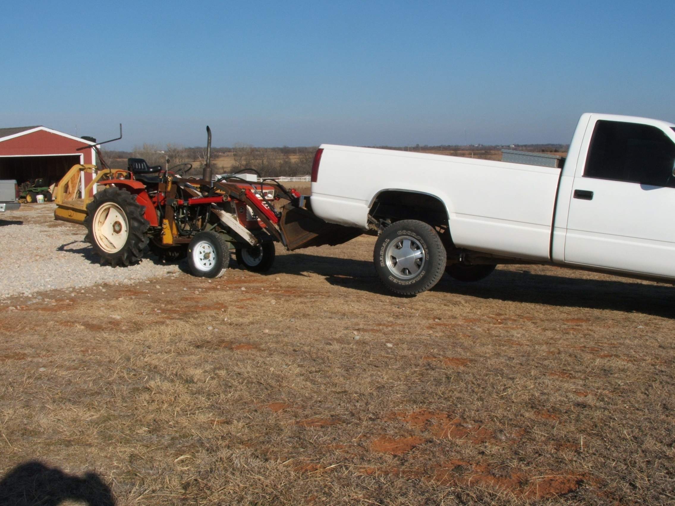

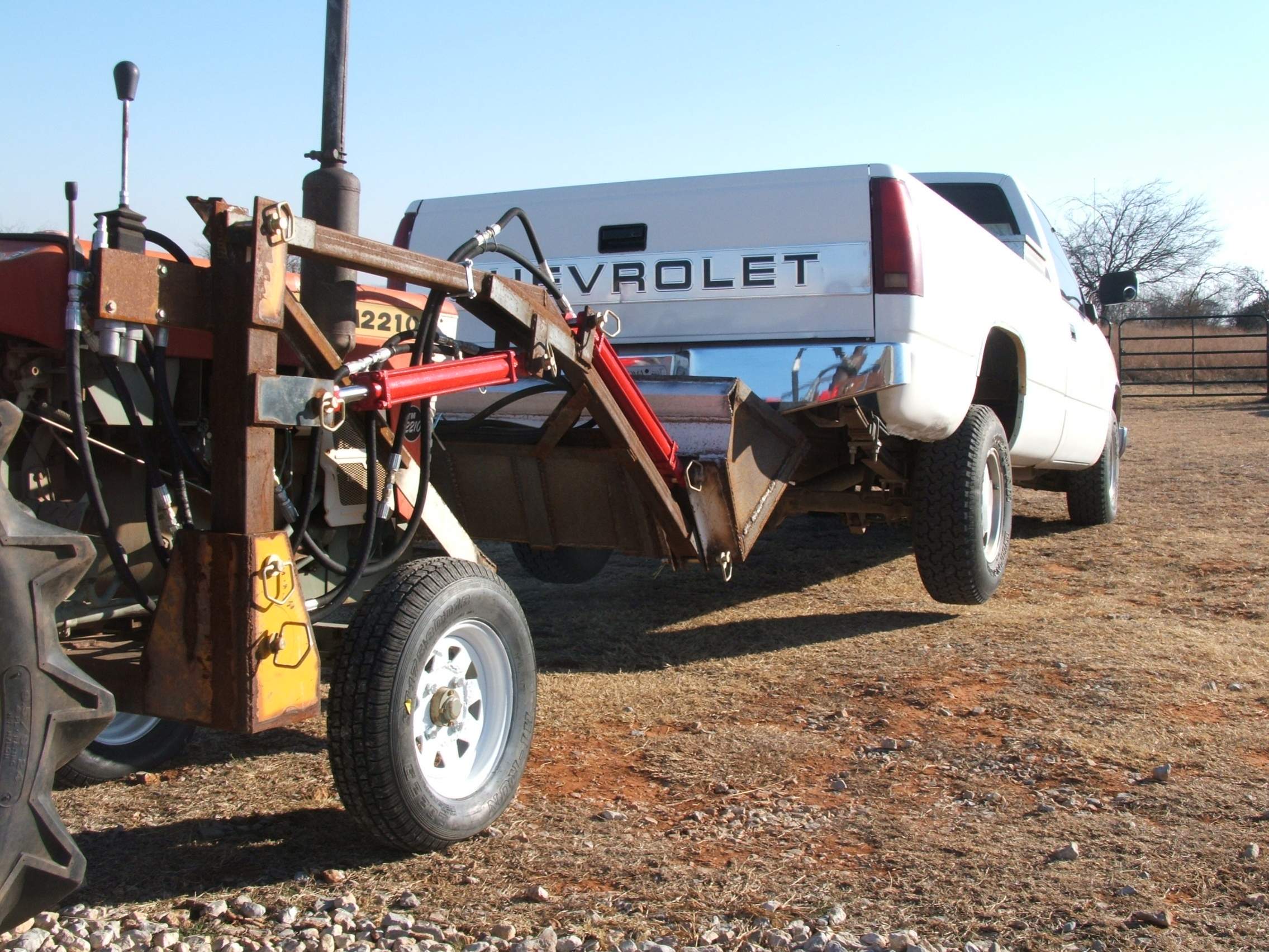

2 X 2 square tubing is fine for what you are doing, especially if it is 1/4 side wall thickness. I used 2 x 2 and only 1/8 inch sidewall thickness or also called 11 gauge on my yanmar homemade loader. works GREAT and have not broke any welds or bent anything yet. I will try to download a pic of it in action. hope you like. My yanmar is a 2210,,, roughly 30 hp.

BAL0123: That is a pretty nice looking loader. I have to ask though, why did you choose to mount the lift cylinder "upsidedown". With the base on the loader arm instead of the support??
I see no benifit to doing so. But the other way around would cause your hydraulic hoses to move MUCH less than the way you currently have it.

I know on my Kubota L4330 the cylinders are mounted "upside down" to keep the hoses closer to the loader arms for the quick-connect hydraulics. The cylinders are plumbed to the loader arms, then from the tee there go to the tractor.

most factory loaders come with the cylinders upside down so they can run the lines down the arms and not under the tractor. i`m going to run mine the other way with the lines under the tractor so i don`t have all those lines going around my loader arms. the lines on the loader arms make it more self contained if it is a loader that is removable.

Most of the ones I have seen have the cylinder right side up. (rod end hooked to loader arm and base hooked to loader mount).
Most all of the CUT's, older utilities, Our JD2040, My L3400, The ford 4500 TLB, all have them right side up. It is actually a very rare occurence that I have seen them upside down:confused2:
