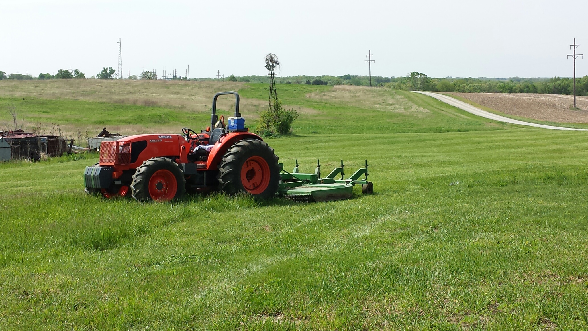

Just how fast are you going?
Out in an open field i will mow between 7-10mph depending on the conditions. Anything much over 5 mph gives a very bouncy loader thus the reason i take the 4-5 minutes to remove it. At these speeds i have generally have to set the rear of the deck lower than the front if its very tall over a couple feet to get a clean cut that doesnt leave a terrible mess. This method uses more power but gets the job done faster gotta give the turbo a workout once in a while.
